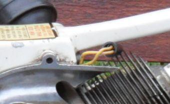

CNew 408 #1 Posted April 16, 2019 I’m finally getting to work on an O&R Sears Utility Lightweight chainsaw that I got quite awhile back and it looks like at some point someone hacked the wiring for the Start/Stop switch and I could use some guidance on the proper way to put this back together. This chainsaw looks to be basically the same as a Mustang 149 if that helps in narrowing the options. My primary question is how the connection should be made from the short yellow wire that exits the top section of the handle down to the engine. When I got the saw the switch did not work and a previous owner had spliced/soldered the little yellow wire from the switch directly into the wire from the condenser. Is that correct? Could I just simply extend the little yellow wire by soldering another short piece of wire that has a terminal connector and attach it to the points stud or is there a specific way this particular type of Start/Stop switch needs to be wired and spliced into the condenser? I believe the wiring inside the handle and to the actual switch is correct, it doesn’t appear anyone has tampered with it (at least that’s what I’m hoping for but I added a photo just in case). Share this post Link to post Share on other sites

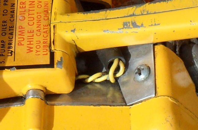

factory 487 #3 Posted April 16, 2019 Both my Orline Mustang & Sears version have two yellow wires joined under a black sleeve, I can't get to either of them at the moment but here are pictures showing this. David Share this post Link to post Share on other sites

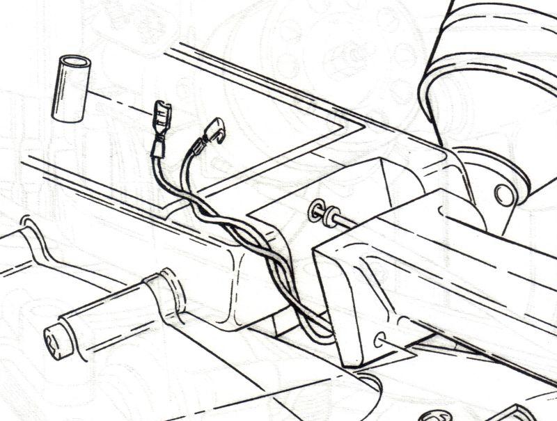

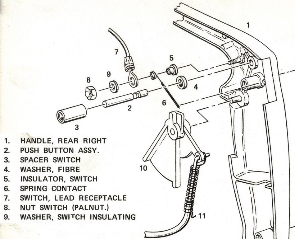

factory 487 #4 Posted April 16, 2019 Maybe these diagrams from the chainsaw service manual will help, there is no mention of where the wire joins to the points (but it will be the same place as the standard brass strip stop switch would go to). David Share this post Link to post Share on other sites
