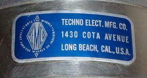

CNew 407 #1 Posted June 11, 2019 Is there anything unique or special about a Tiny Tiger generator that has a blue and silver Techno Elect sticker on it vs the more common band on the generator that has the tiger picture? Share this post Link to post Share on other sites
CNew 407 #3 Posted June 11, 2019 No photos yet. I may have a line on one but I’m still trying to get more details about it and some photos sent to me. Share this post Link to post Share on other sites

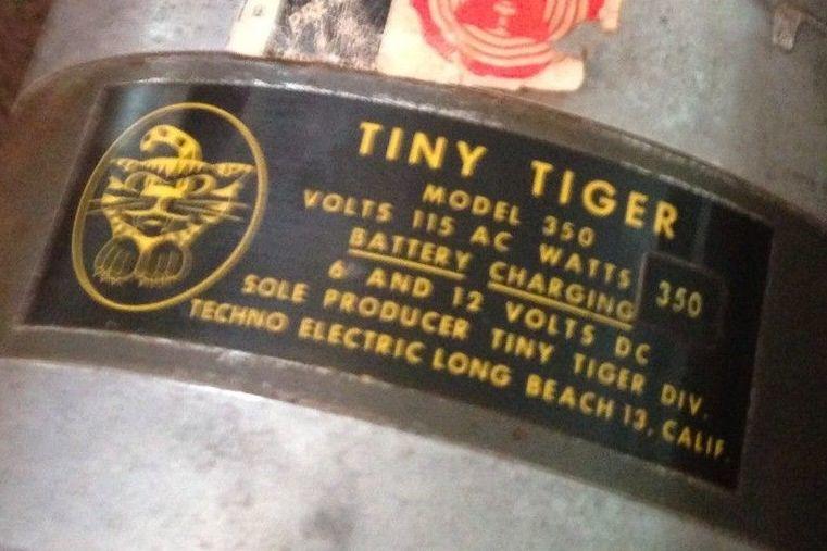

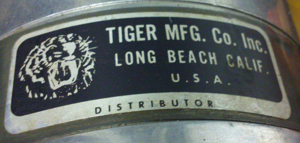

factory 487 #4 Posted June 11, 2019 Commonly known as "badge engineering", neither of these rebranded Tiny Tiger's have the output specification on the main sticker. They should probably have this sticker too. Another version that claims 350 Watts, which is an intermittent maximum use rating (not continuous), see the manual in the sticky thread for more information. I will see if I can find any more in my saved pictures tomorrow. David Share this post Link to post Share on other sites
CNew 407 #5 Posted June 11, 2019 I think the sticker on the one I’m referring to looks like the first picture with the silver and blue. thanks! Share this post Link to post Share on other sites

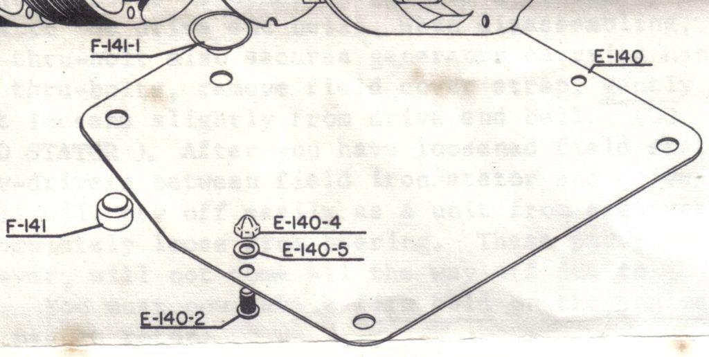

CNew 407 #8 Posted July 7, 2019 Fortunately there were 3 of the feet on the rear. I took the center one and moved it to the front corner. I’ll find a simple rubber grommet to put back in the rear middle hole that sits right under the main generator. I wasn’t sure about the handle, just didn’t look right and I debated on flattening out. I decided to go ahead and do it and I think it looks better that way. Share this post Link to post Share on other sites
factory 487 #9 Posted July 7, 2019 The parts diagrams show the extra foot (or vibro-mount as they call it) fitted on the top side of the base plate, underneath the generator. David Share this post Link to post Share on other sites
CNew 407 #10 Posted July 7, 2019 You’ve got technical info on everything... interesting, in the drawing part F-141-1 looks slightly different from F-141. My generator looks to have had all F-141 feet. I’m planning to find some sort of rubber bushing or other rubber grommet to use in the hole where F-141-1 is shown. The F-141 foot that was there didn’t actually make contact with the generator, it was too low profile. Maybe I can find something that has just a little more height and will actually work to dampen vibration. Share this post Link to post Share on other sites
