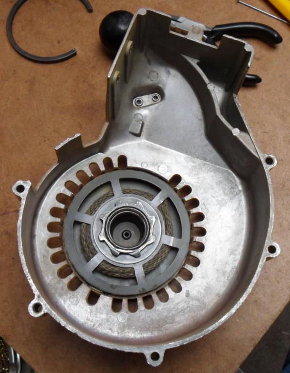

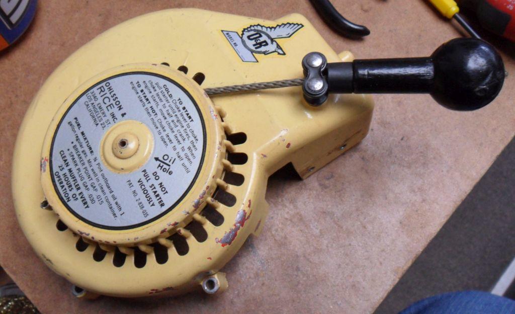

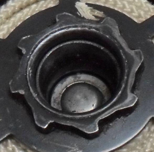

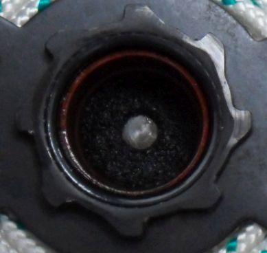

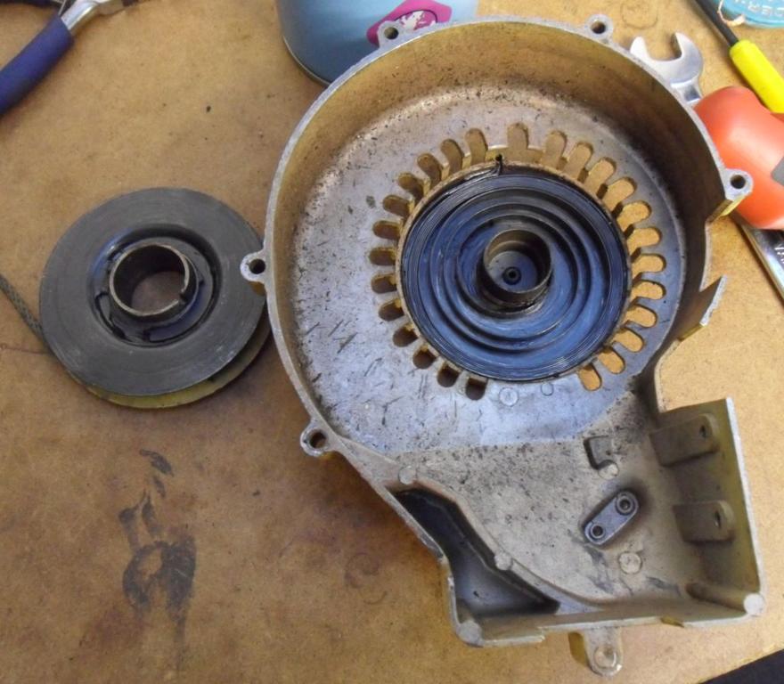

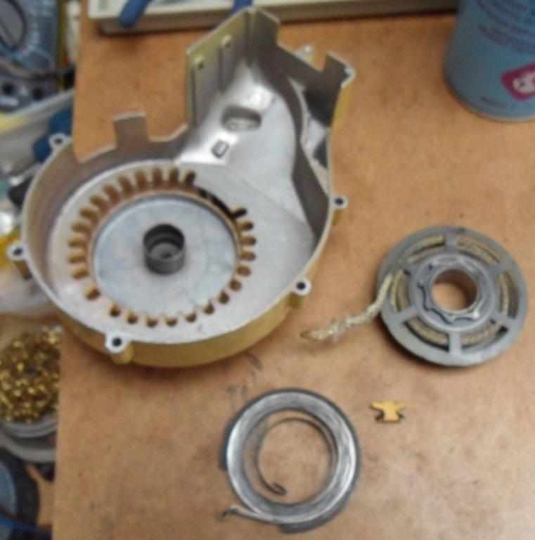

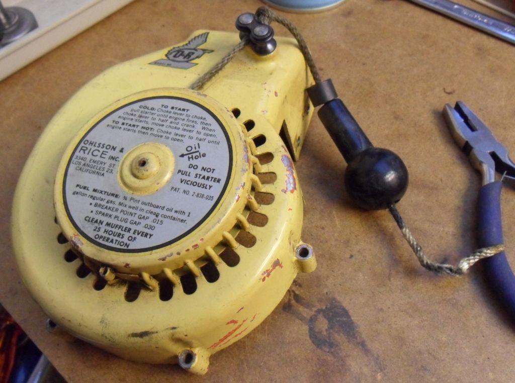

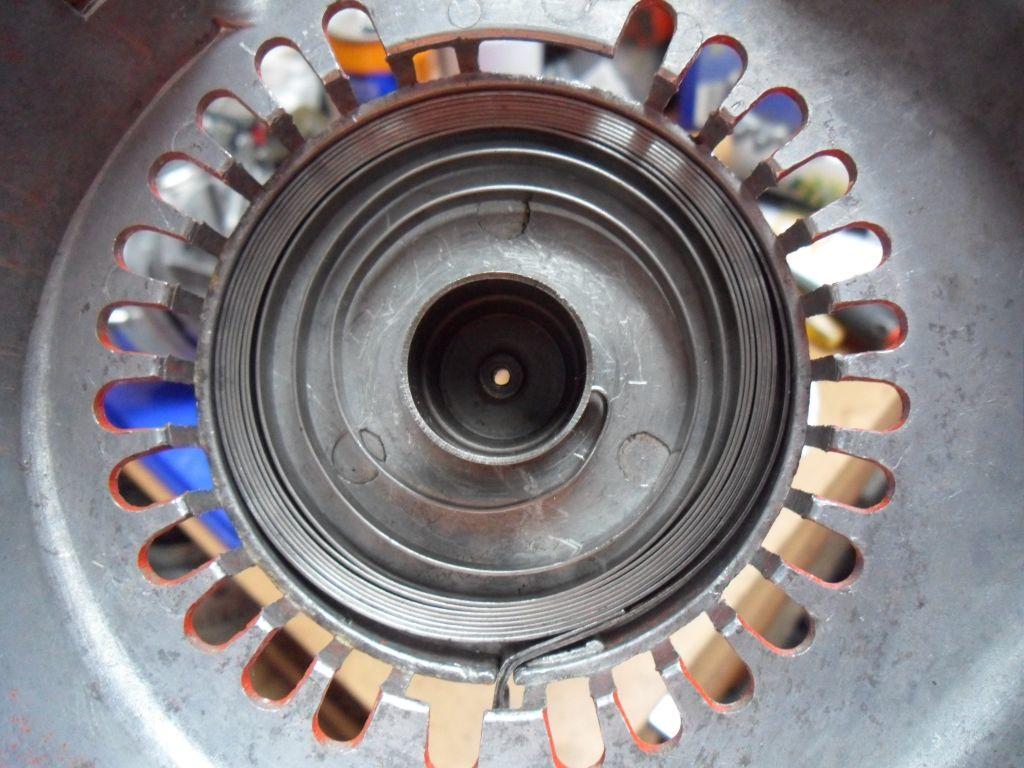

factory 487 #2 Posted June 22, 2019 You probably need to remove the starter pull knob. Or you don't want to take it apart, you could just soak the spring in WD40 and operate it to try & free it up. See this thread from the old forum for more on that method: https://web.archive.org/web/20130814213737/http://ohlssonandrice.forumer.com:80/rope-recoil-oiling-and-removing-t1186657.html Here are some pictures of one of these early starters I rebuilt a while ago; This one I was able to undo the knot holding the starter knob on. Starter reel & spring retainer removed, note the tabs on the spring retainer tend to break off preventing reuse, most early engines seem to be missing it for this reason. All parts removed and cleaned ready for reassembly. The spring was oiled after fitting (picture from another starter). Follow the service bulletin SE-040 for starter reel fitting/cord winding (short cord method). I couldn't take any pictures of this as it's impossible to work on under tension and hold a camera at the same time. All back together. And finally don't forget to refit the felt washer & thrust disc if you have them, most engines seem to be missing these. David Share this post Link to post Share on other sites
