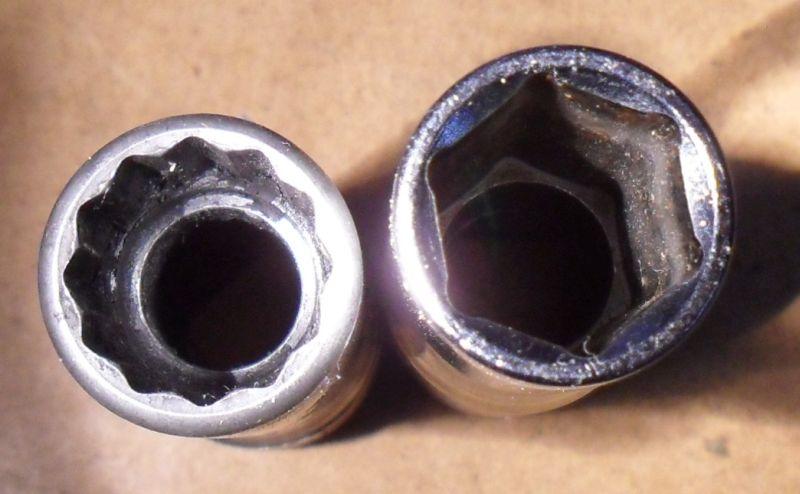

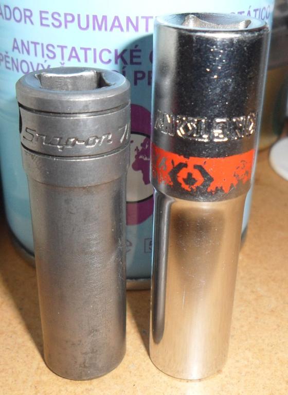

factory 487 #28 Posted July 20, 2019 Clint, I hope it all makes sense. Back to the Orline Mark II saw, is it running OK now? You were talking about taking it apart to check seals & the fuel lines (which are completely inaccessible otherwise), have you got the required socket for getting the de-compression valve out? The engine can't be removed from the frame with that in the way, a deep thin walled socket is required to remove the valve. David P.S. I will try & get the rest of that service bulletin added to the manuals thread. Share this post Link to post Share on other sites

factory 487 #30 Posted July 20, 2019 I ended up buying two deep sockets, the first one was too large to fit. You may also find it useful to have three longer screws/bolts to help with separating the engine from the frame. Another deep reach socket is used for installing the seals. Have a good read through both the 20A & Challenger Chainsaw manuals. There is another service bulletin for these saws, they must have had complaints. David 1 HeadExam reacted to this Share this post Link to post Share on other sites

factory 487 #32 Posted July 22, 2019 Just had a look at the sockets again, actually it wasn't the outside that was the problem, it was the inside not being as deep as it looked. The Japanese one I got from a junk stall fitted, whereas the expensive Snap-on didn't (I really should stick it back on the bay). David Share this post Link to post Share on other sites
CNew 407 #33 Posted July 23, 2019 Ahh, that’s good to know ahead of time. I was able to find my deep sockets, now just need to verify it’ll fit the valve. That’s too bad the Snap-On socket didn’t work out, they make nice quality tools. Share this post Link to post Share on other sites
