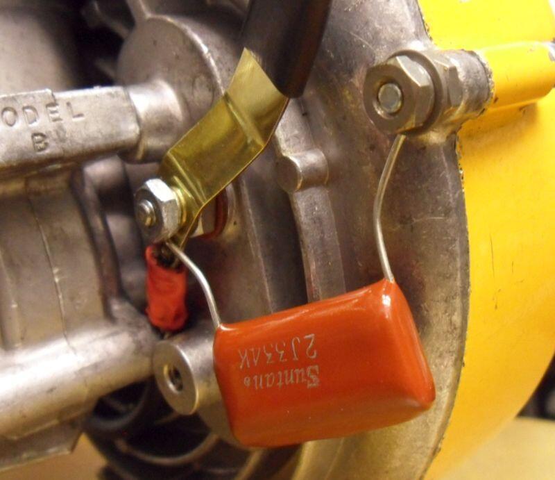

factory 487 #2 Posted September 5, 2020 That's one of the first 6000ish engines, it's possible it might not have a Model stamped into it, it's certainly not a Model J as it has the remains of the pump it was once part of. The capacitor would have been the slightly larger diameter one. The starter pull would have been the lacquered/varnished wood type, could you not try stripping the paint of a later one? David Share this post Link to post Share on other sites

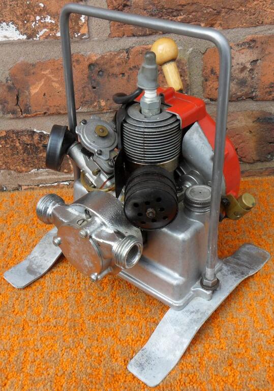

factory 487 #4 Posted September 5, 2020 OK, do you know anyone with a wood turning lathe? Any condenser from an O&R would work, if an early style one had failed in service it would have been replaced with the later one. I've used modern parts too; The rest of the pump is the same as the Comet, Orline, Petro etc with the small rotary vane type pump, the type with the rubber impeller that always seems to be knackered. Petro version shown below; David 1 CNew reacted to this Share this post Link to post Share on other sites
CNew 408 #5 Posted September 5, 2020 Very nice, is that one of your pumps? Those feet are interesting. Share this post Link to post Share on other sites

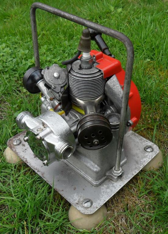

factory 487 #6 Posted September 5, 2020 Yes it's my Petro Chug-A-Pump, some more pictures of the wreck I started with in this thread; I really need to update that thread, too late tonight though. David Share this post Link to post Share on other sites
CNew 408 #7 Posted September 5, 2020 Wow, that’s quite the overhaul. It turned out really nice! I didn’t know Petro Powered Products made anything with O&R other than the really cool drill. Share this post Link to post Share on other sites

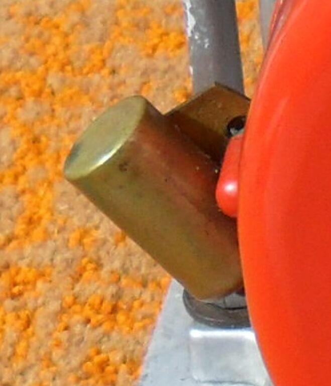

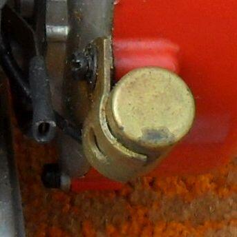

factory 487 #11 Posted September 6, 2020 Here is another pump that your engine could have been part of, there is no branding on this one (if it had a decal it's long gone). The engine SN of this one is #005790. David 1 CNew reacted to this Share this post Link to post Share on other sites
CNew 408 #12 Posted September 6, 2020 Interesting... thanks! By the way that primer button is different- never seen one like that. Share this post Link to post Share on other sites
