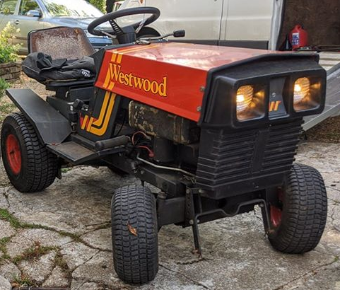

ginger_biscuit69 8 #1 Posted September 22, 2020 hey all, trying to work out what the weight of my T1100 ride on is, with a 36" cutting deck attached? Need to trailer it somewhere, but being an unbraked 750kg gross trailer, only has 350-400kg capacity on it before being overloaded. Any ideas before i stick the bathroom scales under each tyre? Passing no less than 4x DVSA weigh points on this trip, and as someone who usually tows for a living, can't risk being over!! thanks in advance! Share this post Link to post Share on other sites
the showman 4,074 #2 Posted September 22, 2020 Taken from a Westwood brochure. Share this post Link to post Share on other sites
Stormin 4,458 #3 Posted September 22, 2020 I'll hazard a guess at around or just over 600lb. Guess I'm a little bit on the heavy side according to the list Chris has posted. Share this post Link to post Share on other sites
ginger_biscuit69 8 #4 Posted September 22, 2020 perfect info thanks gents! Main thing is, id like to get all petrol powered bits on the trailer - westwood, rotavator, few strimmers & chainsaws etc. If i take the westwood as 200kg, the remaining 150kg is plenty for my needs. Cheers! Share this post Link to post Share on other sites
ranger 373 #5 Posted September 25, 2020 Don’t forget with an unbraked trailer you can only tow up to half the weight of the towing vehicle up to the 750kg limit. 1 Stormin reacted to this Share this post Link to post Share on other sites
ginger_biscuit69 8 #6 Posted September 25, 2020 (edited) 6 hours ago, ranger said: Don’t forget with an unbraked trailer you can only tow up to half the weight of the towing vehicle up to the 750kg limit. its behind a Volvo v70, which is manufacturer rated at the full 750kg unbraked. Its a barge on wheels, no problems there! Edited September 25, 2020 by ginger_biscuit69 punctuation Share this post Link to post Share on other sites
