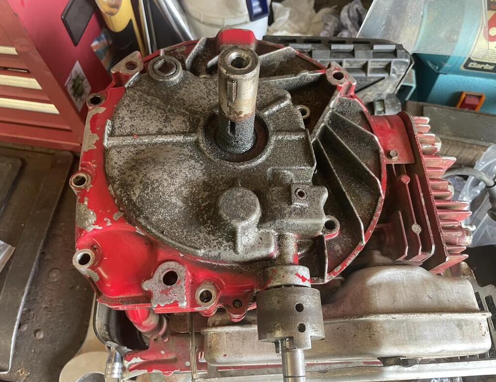

The engine is has a PTO driving the rear roller, but it I think the roll-pin securing the gear to the PTO shaft has sheared - hence the need to remove the sump to access the gear and replace the roll-pin.
With the engine inverted on the bench (see attached pic), I removed the 7 bolts securing the sump to the crankcase expecting to be able to lift the sump off, but after lifting it about 10mm fairly easily I’m the feeling some resistance.  Initially, the shaft to which the blade would attach remains in place as I lift the sump, but after 10mm it seems that the sump is catching on something and lifting the shaft too.
Any help or advice or would be much appreciated.

Are we to assume that you are trying to pull the sump over all the crud on the crank ?
Taking it at face value you must clear all that crud off the crank  - scraping and fine sand paper. May even be helpful to pull out the oil seal so as to clean right down to the clean part of the the crank, then plenty of thin oil.
You'll need to remove the woodruff key to get it off completely anyway.
Can you get a thin piece of wood in when it's lifted as far as it will go to hold it up while you have a look inside with a light?

I removed the worst of the crud with a wire brush before attempting to lift the sump, and the shaft is tapered immediately above the oil seal, so what remained didn’t cause an issue.
Anyway, I did manage to remove the sump with some gentle tapping with a mallet.

It wasn’t necessary to remove the woodruff key, because the shaft is tapered immediately above the oil seal.
I’d already had a look through the 10mm gap and I couldn’t see any obvious reason for resistance, but I did eventually manage to remove the sump with some gentle tapping with a mallet.

Just make sure that you can account for every bit of the failed roll pin. If you can’t find all the bits in the sump, take the cam out and flush out the inside of the crankcase  over a clean receptacle  and hope to find the missing part of rock hard roll pin that will do serious damage if picked up between cam and crank gears or the worm gear and the bronze worm wheel.
This is not from the official manual but we used to replace the standard roll pin with a stronger “ spirol” - especially on contractors’ machines. BUT don’t upgrade the pins outside the engine such as in the dog clutch fixings. You need to maintain a weak link and a lot easier to replace.
