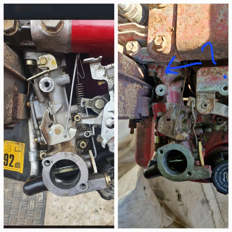

Steve2018 3 #1 Posted September 20, 2024 Hi, got a old Cement mixer here that I need help with. It starts and idles fine but almost cuts out when load is added to it (sand etc) Took the filter housing off and can't see any governor springs attached which I'm guessing is the issue?? Engine code seems to be 92232 0141 01 970228f a Pic of the carb but as you can see it doesn't have one of thenspring mounts it's like it was never threaded at the factory? Carb on left is a image I found online carb on right is mine Any ideas on where the springs should go? Thanks Share this post Link to post Share on other sites
Anglo Traction 1,023 #2 Posted September 28, 2024 Afraid your engine is a bit new for my knowledge, but when these are fitted to applications like Generators, Pumps and Mixers, they're usually governed to 3000rpm either by centrifugal driven gear/lever rod, or air deflection (pneumatic) via the fan housing. All I can offer is a link to the Briggs Online Manuals download page for your engine model. The page shows the Engine Manual and Illustrated parts list (near bottom of the page). It's then just a matter of searching them for comparisons to your model to see if any parts are missing. You don't say if you have only just aquired this, or had it long time?. Anyway, here is a link- Briggs 092232 0141 Let us know how you get on, as may help someone else. Regards Share this post Link to post Share on other sites
