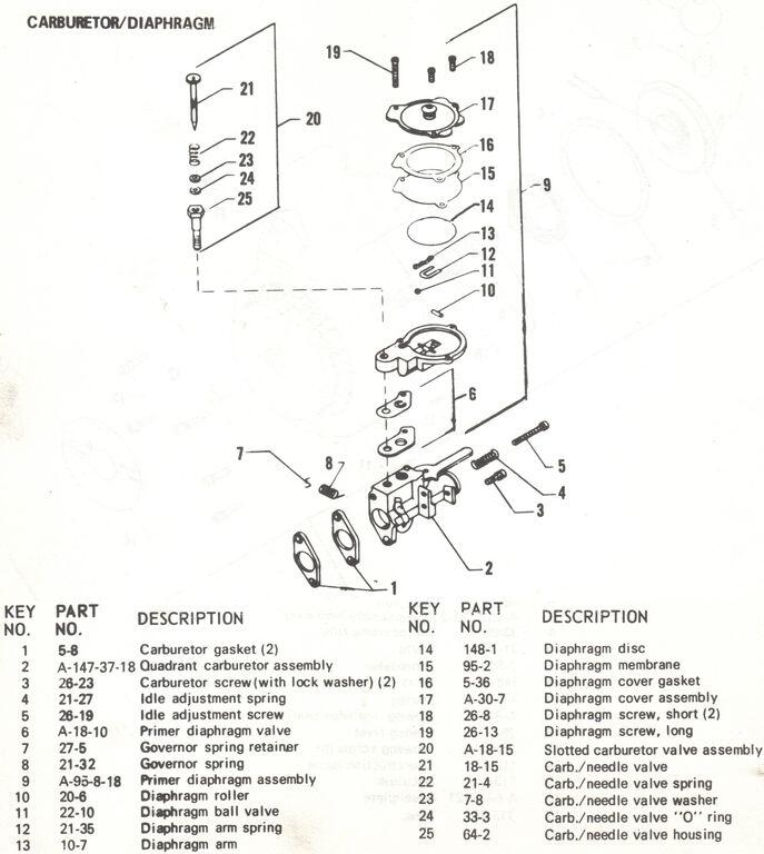

Wallfish 718 #2 Posted February 28, 2025 Are you referring to the actual needle valve? Some of the older engines had a smaller needle valve on the side of the carb and a screw which holds the diaphragm assembly to the lower carb body. Newer models have the the needle holding the diaphragm assembly to the carb body. Maybe a pic would help determine what carb you have and what you're missing. Share this post Link to post Share on other sites

Wallfish 718 #4 Posted February 28, 2025 You need the gasket, the plastic check valve, the complete needle valve. Probably a diaphragm Have you opened up the cover to see if any other parts are missing in there? Arm, spring, bearing ball? I'll take a look around to see if I have a complete valve, Share this post Link to post Share on other sites

Wallfish 718 #6 Posted March 2, 2025 7 hours ago, Mitch said: Hello Wallfish, Any luck finding a needle valve assembly. Found a housing and a needle ( #21, 25 ) but not the little parts, washer, o ring or spring ( 22, 23, 24 ). You can get those at any good hardware store or find something online Did you ever open the carb to make sure the other parts are there? Someone lost the valve so you should check EVERYTHING to make sure you don't need anything else. You can do everything else on your engine like cleaning the points if it doesn't have spark now, fix the recoil (DO NOT DRILL OUT THE RIVET), etc etc. Fire it up with a squirt of 32:1 mixed fuel to verify it's a running engine. And you can also check the generator when it fires off too. If it doesn't run or generate power, does taking my last valve make sense? Your welcome to it if you need it! Share this post Link to post Share on other sites
