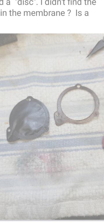

duradad 0 #1 Posted February 16 (edited) I have a tiny tiger carb that I thought i had disassembled very carefully. I want to replace the diaphragm and need a source. Also, I'm sure this carb has never been apart before, but I cant find any sign of the diaphragm "disc" shown on the parts list. So, I will need this also. I looked very carefully and can't see how I may have lost it. Any chance that this engine was running fine without the disc ? I don't understand how this carb pumps fuel. The pump carbs that I have worked on usually have a port hole or hose to the crankcase and the diaphragm action is via crank case pressure. Other than the primer valve. What causes the diaphragm pump action while the motor is running ? Edited February 16 by duradad Second question. Share this post Link to post Share on other sites

duradad 0 #3 Posted February 17 Thanks Wallfish. Here is a pic of my diaphragm and gasket. The rest of the carb appears exactly as in the parts diagram. I don't see any disc attached to the diaphragm. I checked the thickness. It's about .009 inches, if that helps. What do you recommend ? I'm in Connecticut 06804 Share this post Link to post Share on other sites
Wallfish 720 #4 Posted February 17 I meant a pic of all the carb parts but I can probably find one or make a disk and attach it to a diaphragm for you. That little disk would or should be attached right to the diaphragm. It gives a rigid point for the little arm to contact to pulse it and pump gas. Without it, the diaphragm wouldn't have enough movement to pump enough gas. PM your address. (The little envelope icon at the top right of any page) Here's a thread I did a while back on a TT restore if you're interested. I also just pined it so it's on the top of the list and easier to find in the future. The TT generators are the most common O&R tool sold https://myoldmachine.com/topic/1439-tiny-tiger-350-restore/ Do you have this part? Some carbs use this instead of the little disk attached to the diaphragm Share this post Link to post Share on other sites

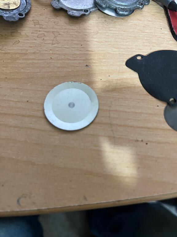

Fishnuts2 22 #6 Posted March 19 Should that disc be epoxied to the diaphragm? I have carbs with both styles plus some with no disc. The best runner is with the large disc. Thanks! Share this post Link to post Share on other sites
Wallfish 720 #7 Posted March 20 22 hours ago, Fishnuts2 said: Should that disc be epoxied to the diaphragm? I have carbs with both styles plus some with no disc. The best runner is with the large disc. Thanks! Not that large one pictured. The smaller discs should be attached to the diaphragms. I use a product called "Seal-All" because it stands up to gas. 1 Fishnuts2 reacted to this Share this post Link to post Share on other sites
