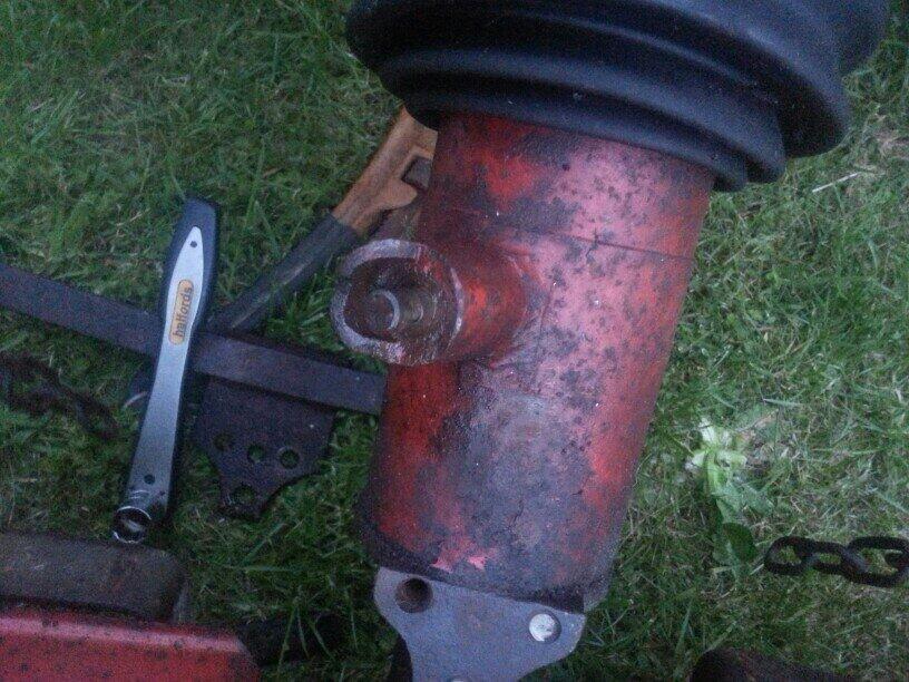

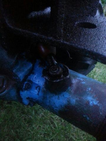

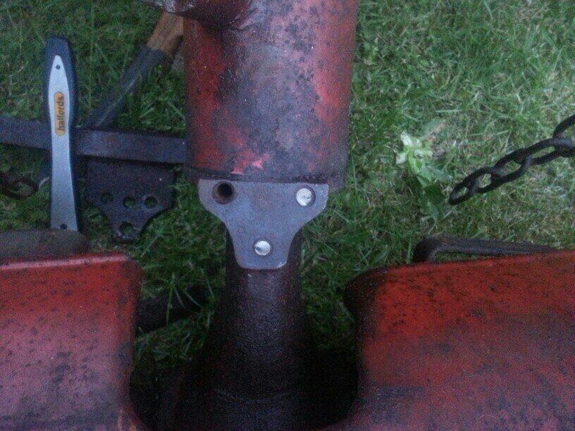

jonnym 9 #3 Posted May 19, 2014 (edited) Thanks Gav. Yes big problems removing the rotavator. The pins are seized and bolts are shearing. See photos below. I don't know about the hubs, how could I tell? Yes im using the clutch for the PTO and there going in to the grooves. I've tried all the positions only the land speed is working. The bolts have sheared for the bracket that held on the rotovator cover. Only one was fitted in properly one was missing and the other was about half an inch proud. The two bolt sheared very easily, I barely leant on them. Ive ran my tap down the hole of the missing one and it feels OK now. The PTO pins had the lifting arms on them but the retaining pins have snapped on both. The actual pins holding the PTO on are stuck fast. I've sprayed a load of wd40 on them tonight, given one of them a good smack with a persuader and had a stilson on it which didn't work. My plan is to weld bolts and washers on to the sheared bolts and remove them like that. I might also do the same for the PTO pins as the heat should help release them and I can use the ratchet on them, that is unless there is somthing that could get damaged inside? Any thoughts Thanks for your help Jon Sent from my GT-N7105 using Tapatalk Edited May 20, 2014 by jonnym Share this post Link to post Share on other sites
GAV694 23 #4 Posted May 20, 2014 (edited) The pins with the black knob for holding the pto shafts lifts and turns about 180 degrees, i would try to free these off without heat if possible as I am not sure what damage could be done. I wonder if the PTO sleeve could be unbolted from the rear of the tractor without disturbing any seals or bearings so that you could get everything onto a bench to work on it Hopefully something has just come apart inside the rear end of the tractor causing the PTO not to engage, I guess there will only be one way to find out For the sheared screws i have had great success welding on a washer the a nut, as you say the heat helps break the bond. If you post a pic of the hub on the rear wheel i will tell you if they are reduction hubs or not. Edited May 20, 2014 by GAV694 Share this post Link to post Share on other sites

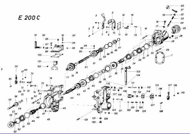

jonnym 9 #11 Posted May 21, 2014 (edited) Ohh thats as dry as a witches sense of humour, about the same condition as my finger mower. Can you still get the oil seals for the rotavator shafts. Mines got a leak on it. My new sd card should arrive on Thursday so I can take a few images then. Anything specific? Where could I get an explosion diagram of the tractor and accessories? Or at at least diagrams like the one you attached Gav? I shall be getting the welder out tomorrow if the weather holds. I can't see another way of getting the pto pins out without using heat. The stilson is going to shread the top of the pin at least with welding I can grind it back down again. I'm amazed how robustly these things are made, I doubt in 50-60 years that many modern mini tractor s will still be around. Jon Sent from my GT-N7105 using Tapatalk Edited May 21, 2014 by jonnym Share this post Link to post Share on other sites
GAV694 23 #12 Posted May 21, 2014 (edited) The rotovator seals are standard metric ones with a double lip, I was going to order mine from simply bearings when I buy the bearings for it. Its the splined coupler that I am still trying to find a replacement for. I can send you diagrams tonight, there all in German but the pictures and technical descriptions are easily understood. Yes they were built solid, a proper tractor rather than a garden tractor As for photos of the rotovator the external bracket that you have the sheared bolts in is partially missing with the bit I do have being welded direct to the shaft (again were you have the sheared bolts) so I need to sort all that out. As for welding the retaining pins to free them up, I was just a bit concerned that there may be seals and a spring in there that may not survive the temperature Edited May 21, 2014 by GAV694 Share this post Link to post Share on other sites
GAV694 23 #13 Posted May 22, 2014 I cant see from the drawing how the shaft slides to engage the PTO. Could it be that the PTO lever is slipping on the little shaft that its supposed to turn? Share this post Link to post Share on other sites

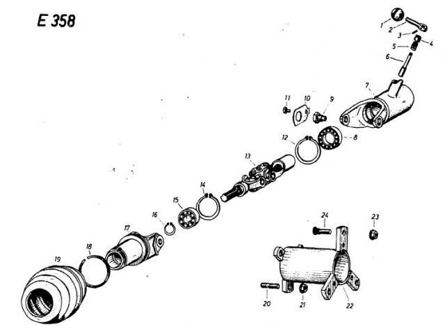

jonnym 9 #14 Posted July 21, 2014 (edited) Hello sorry for the long absence from this thread. Ive been trying again to free the PTO pins with out any luck. My theory is that the item number 22 on the diagram is brass and is sticky. On the drawing I can't see anything but a straight pin so would it be a problem if it span through 360 degrees? My plan is to make an extractor, using a tall section of steel box with a piece of threaded bar down it. On the end a nut retaining a piece of steel strip bent into a flat U with holes in to meet the hole in the PTO pin. On the top a large thick washer and a nut. This way I can use the threaded bar to pull the pin up a bit then hammer it down working it with penetrating oil. It should have the effect of rotating it as well. I hope I explained that adequately. Does that sound like a good or terrible idea? What would the pit falls of winding all the way out be. Also as both handles are not attached which way does it turn to be released and engaged? As always thanks for all your help Jon Sent from my GT-N7105 using Tapatalk Edited July 21, 2014 by jonnym Share this post Link to post Share on other sites
GAV694 23 #15 Posted July 21, 2014 I think I follow what you mean and it should work. I haven't ever removed the pins but I think they will rotate 360 degrees. It doesn't matter which way the pin is facing to release the pto shaft, it is the fact that it is lifted up that releases the pto shaft. would splitting the flexi shaft by removing bolts number 9 give you access to the internals of at least one of the retaining pins Share this post Link to post Share on other sites
jonnym 9 #16 Posted July 21, 2014 I've not removed the rubber gater covering the universal joint yet to take a poke around. I've removed the clips holding it, but the gater has hardened and I'm loathed to split it trying to remove it completely, as I'm sure it will be a bugger to replace, one of the reasons I was doing it at this point was it was one of the hottest days of the year and I hoped the rubber would be slightly more plyable. Looking at the diagram if I remove the number 9 bolts would I still need to either split the universal joint or remove the circlip and bearing (and is the bearing hydraulically pressed in) to split it? I was hoping that rather than making days more work I could just tackle the PTO pin problem... Really I should know better. Thanks again Jon Sent from my GT-N7105 using Tapatalk Share this post Link to post Share on other sites
jonnym 9 #17 Posted January 6, 2015 Hello Been a long while, but I'm still struggling to free the rotovator. I've welded a nut on to the top of the PTO pin and still can't remove it! Does anyone know where I could buy a relacement gator like the one in the above diagram? I fear I'm going to have to cut it off. Thanks Jon Sent from my GT-N7105 using Tapatalk Share this post Link to post Share on other sites
