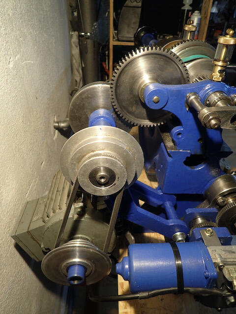

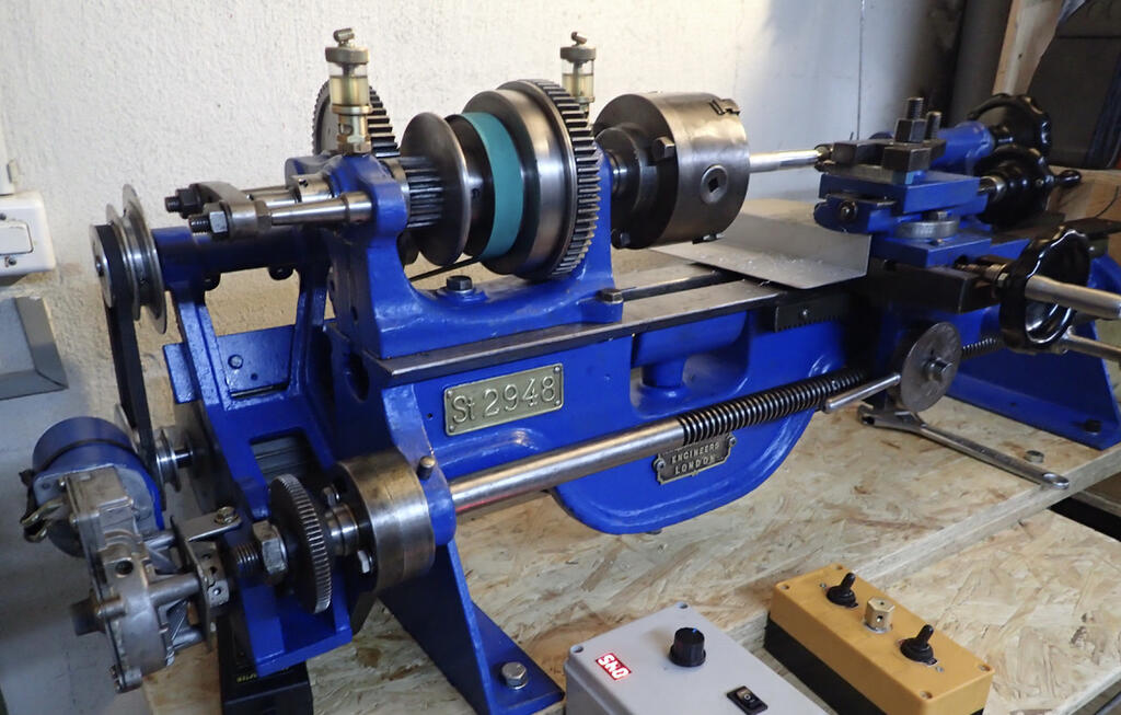

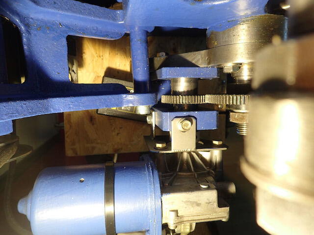

    I finished the late to 98%.
    I put an inverter to it and a e-motor for the feed.
    The spindle has nearly no play super acurrate, very impressiv.
    Will send a movie.

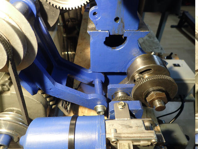

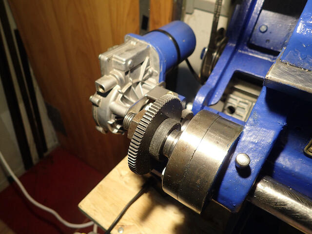

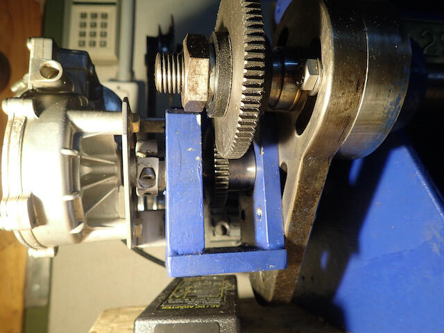

      P1020022.jpeg.728d66ed4bc13f9ee0669093b225a174.jpegP1020020.jpeg.b9b03786a901a9487bbc3bd58106e36d.jpeg
      This is for the feed
      This is for the spindelrevolution

      Thanks for the extra photo's Marcel.   :thumbs:   I can see  how the feed is connected now.     The motor and  angle drive  looks like a car or truck wiper mechanism. Or am I wrong.  Good idea.  :bow:   Do you have any projects in mind to make on the lathe. ?

  5. ear Alain The spindel should run in brass or bronze and You can ajust the play. At my lathe it has 0 play (as mauch as it needed when it get warm. It is marvelous. I will take a 0.75Kw e-motor with a FU. For the leadspindel a will make one a e-motor also with FU. And I changed the handel too. By the way and the beginnig my lathe looks the same as Yours. It was not used for about 30years. There is a grinding tool for attachment but this has to wait. If all is finished You will get some pictures. Best form the Rheinfall (rhine falls) Marcel
  6. Dear Alain I am not at the end of the restauration but it looks al ready good.
