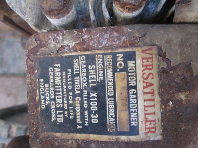

eventually or buy a suitable near as poss replacement. I would like to know the head bolt torque if poss and was the engine (V.711) made by
Farmfitters? It looks a bit like an old Tec to me but the Ducatti point has thrown me so I aint got a clue.

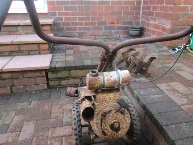

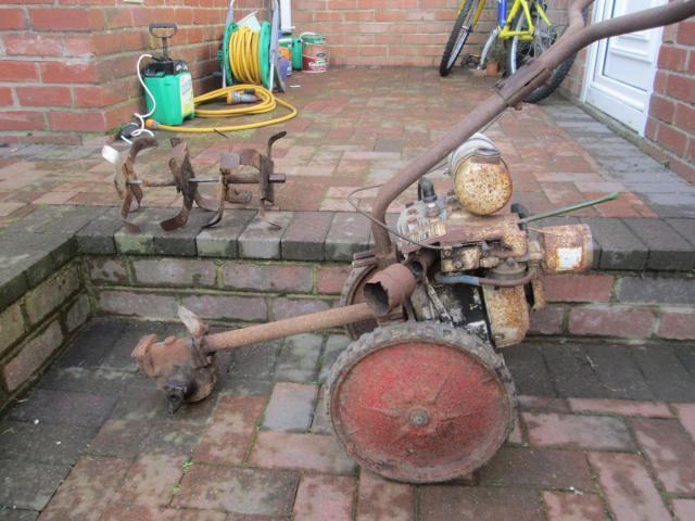

Sorry about the double post, here are the pic's of the in use Landmaster and the recently aquired Versatiller. As said, forgive the livery and none
standard guard on the landmaster. It was a needs must and just what I had to hand. I'll take my time with the Versatiller which in truth was only
bought for the tines for the princely sum of a tenner

I have a couple of those Versatillers they are known as the Mark 4, and I have a manual for them which I would be happy to
copy for you, just let me know your address in a private message. The engine is an Aspera or Aspera Tecumseh.
The Landmaster is a Gardenmaster 80 with a 79cc JAP engine, nice little machine
