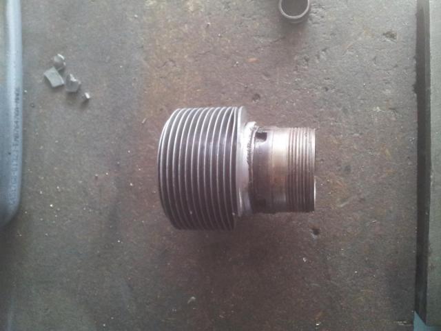

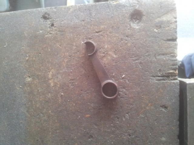

Darmic1 447 #27 Posted November 13, 2014 I thought I would put an update on this little engines progress....... Once stripped down it became apparent that the piston and barrel would be one forever more, despite my best efforts to separate them! A little too much force and the piston was holed..... Here is the broken barrel and conrod. Share this post Link to post Share on other sites

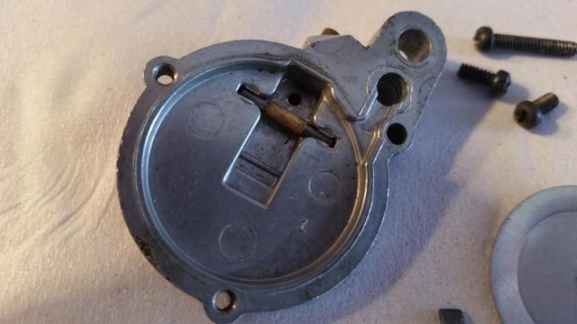

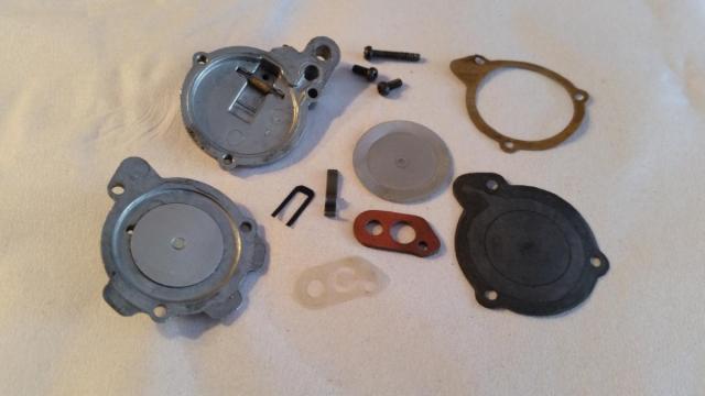

Darmic1 447 #28 Posted November 13, 2014 The carb was stripped for an inspection and overhaul. I discovered the fuel shut off valve(ball bearing) is missing, along with the choke lever and the air cleaner. I have replacements coming in from the US of A...... I have already had some bits come over, a replacement barrel and piston. New set of seals and gaskets, a new spark plug and a carb overhaul kit. Share this post Link to post Share on other sites

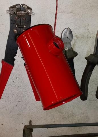

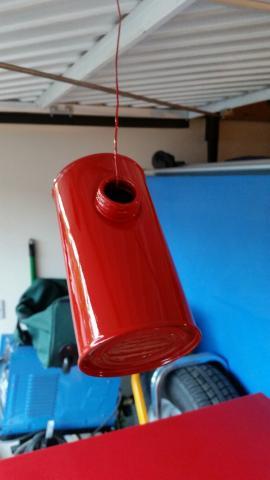

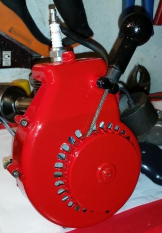

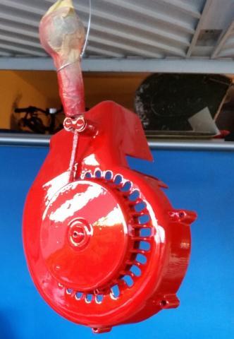

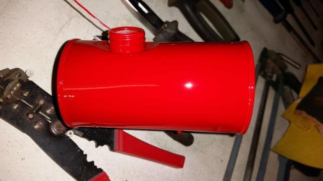

Darmic1 447 #29 Posted November 13, 2014 Managed to get it all back together, but without a spark...... A quick chat with Wallfish and an exchange of photo's showed me that a wire was in the wrong place. Once rectified, a healthy spark was produced. I was so tempted to try the engine, despite not having a working carb. So I squirted some fuel in and gave it a pull! The 2nd pull and away it went....... not for long, but enough to be happy with the progress. Next was to attend to the paint work. The fuel tank had a couple of small pin holes. Once stripped of old paint I was able to solder repair the pin holes, then apply some filler to smooth the dents. Next came a coat or 2 of etch primer and finally a couple coats of top coat. Gave the starter housing the same treatment........ New decals are on the way too! 1 Wallfish reacted to this Share this post Link to post Share on other sites

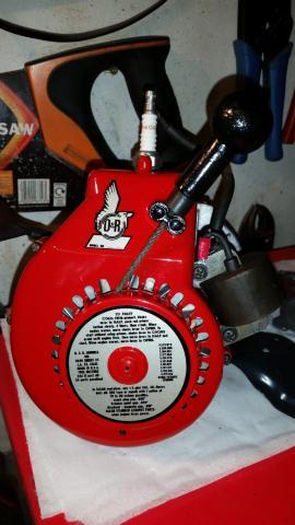

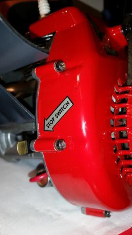

Darmic1 447 #30 Posted November 14, 2014 Had a little bit of international post arrive today...... Here they are stuck on! Share this post Link to post Share on other sites
Stormin 4,458 #31 Posted November 14, 2014 Looking nice. 1 Darmic1 reacted to this Share this post Link to post Share on other sites
Darmic1 447 #32 Posted November 14, 2014 Thanks! Just a few more bits left to do....... Then find something to fit it to??? Share this post Link to post Share on other sites
pmackellow 2,738 #33 Posted November 14, 2014 Nice job Darren, as ever !! 1 Darmic1 reacted to this Share this post Link to post Share on other sites
