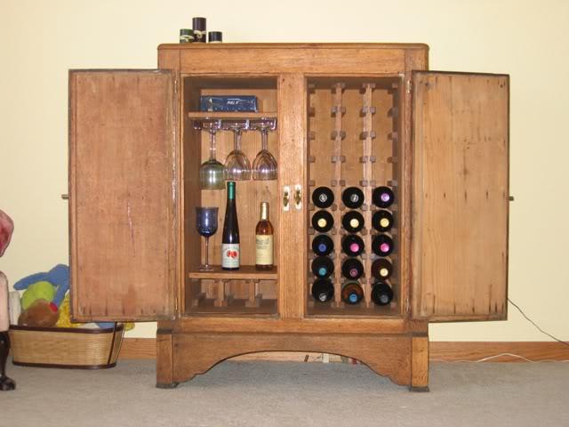

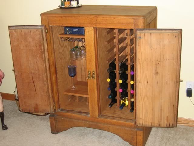

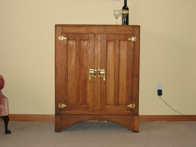

CasualObserver 4 #1 Posted June 7, 2013 Back in 2006 my wife wanted a wine bar for the living room, but the more we looked at places like World Market, Crate and Barrel and Pottery Barn... the more we realized that everything nowadays is just laminated MDF. We wanted something real. So we came up with the idea of using an antique icebox, and started looking at flea markets and antique malls. We looked for well over six months to find one with two large doors rather than the more common three door models. We found one that had been gutted by a previous owner, and I retrofitted the interior, making no changes or damage to the original piece. She drew up the design and I blueprinted it to fit the dimensions we had. It holds 9 wine glasses in a stemware holder from Lowes, and 30 standard sized wine bottles. (27 in the right and 3 at the bottom left) The shelf on the top left is for the bottle opener. Wish I would have thought to take more pictures of it as it went together. The rack on the right is built completely out of 3/4" square oak stock. There are four vertical posts that were routed out 1/4" on two opposite sides to nest the horizontal resting bars into. Horizontal bars were glued and brad nailed. When I was done it mapped out to 27 perfectly identical squares, with the perfect depth for horizontal wine storage. Essentially I built it as a kit and did final assembly inside the ice box itself. We like it. It's held up through a household move and now 7 years later still holding wine bottles. 3 stevasaurus, nylyon and jamesie reacted to this Share this post Link to post Share on other sites
