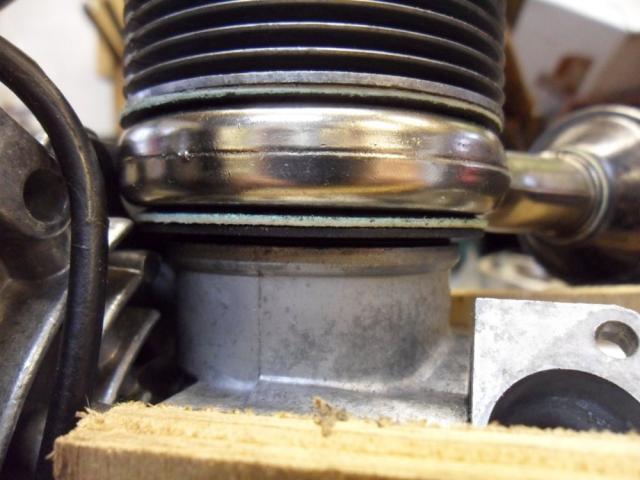

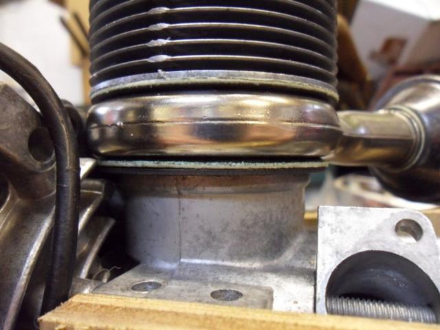

factory 487 #5 Posted January 31, 2015 The cylinder was all the way in before I started the repair of this engine, as can be seen in this picture. This is as far as I can get the cylinder with the .105" O-ring, the gaskets were made from Klingersil C-4324 1/32" that I bought at a local engine show last year. I bought some O-rings the next size down at .079" (2mm) earlier this week, I managed to get the cylinder all the way down, but the cylinder tool T-bar got bent in the process. The engine will have to be stripped down again though, as it has lost spark. This is due to me fitting a later aluminium flywheel key when I replaced the flywheel with a later one. The flywheel must have turned when tightened. The key slot is deeper than the later crankshaft & the damaged key is now stuck. David Share this post Link to post Share on other sites
