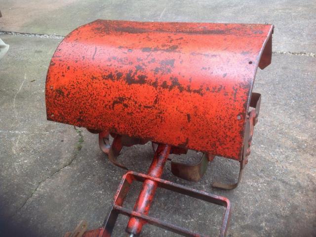

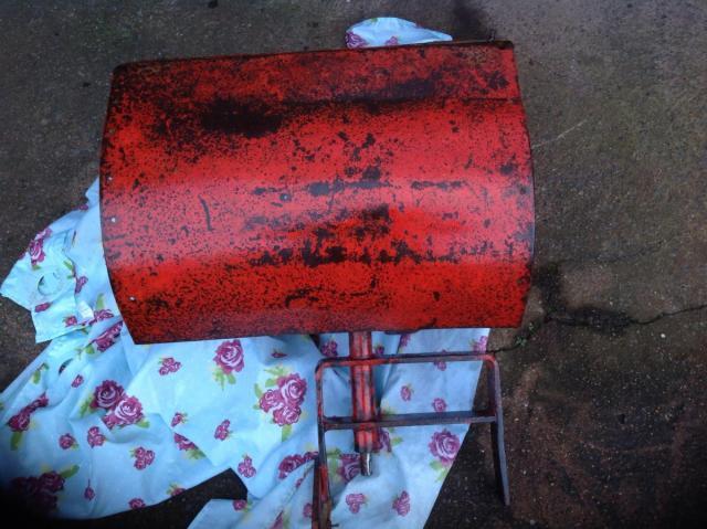

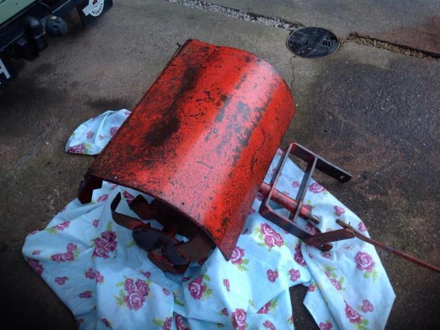

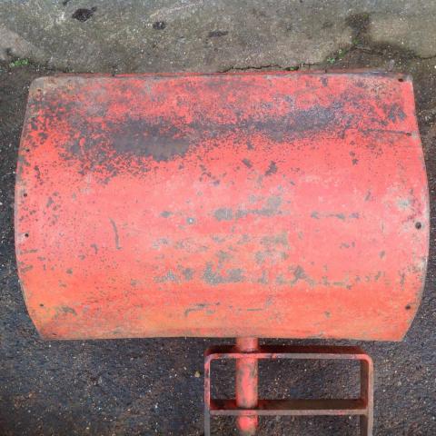

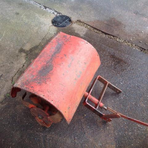

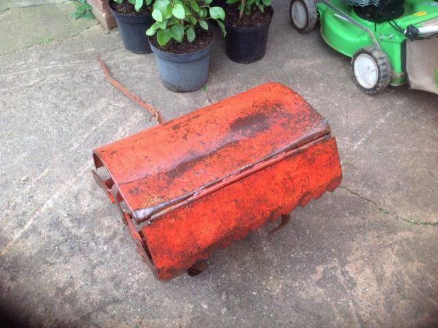

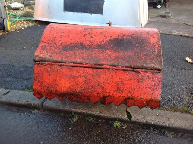

Triumph66 1,256 #1 Posted February 2, 2015 Last weekend I collected my Rotovator/ Tiller for my Bolens. I pressure washed the grime off it that afternoon and the following day spent a couple of hours brushing off the rust as well as degreasing it. I read George's (aka The Fife Plooman) recommendation of Owatrol and decided to try it out myself. I had a few hours spare this afternoon and it was relatively warm and sunny so I decided to give the tiller its first coat. I am happy with the results so far. I plan to do another coat over the weekend, weather and temperatures permitting. I also drained the gearbox but nowt came out! Topped it up with non synthetic gearbox oil. Here it is when I collected it. After being pressure washed. Sanded down and degreased. Surface prepared for application of Owatrol. Last two photos show first coat of Owatrol. 2 OldBuzzard and slf-uk reacted to this Share this post Link to post Share on other sites
slf-uk 914 #2 Posted February 2, 2015 Andrew, Looks great. The oil seal on the shaft often fails on these tiller's, which results in all the oil emptying on the floor when they are left hitch down. When I store mine for a while I put a block under the hitch to keep it level. Hopefully this is was has happened to yours and it has not been run without oil. Iain 2 OldBuzzard and Triumph66 reacted to this Share this post Link to post Share on other sites

Triumph66 1,256 #7 Posted March 1, 2015 I applied a second coat a few weekends back and I am really pleased with the results. It got a nice protective sheen to it as well as enhancing the patina of the machine itself. I would like to use this hence the reason why it has not been repainted. I guess if I got another tiller, I would more than likely get it repainted as part of my rally kit. 1 OldBuzzard reacted to this Share this post Link to post Share on other sites
