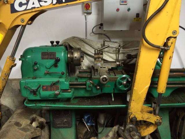

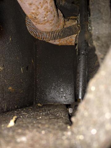

slf-uk 914 #28 Posted March 6, 2015 Tonight's progress was minimal as I finished from work later than normal and had to get some equipment ready for tomorrow. I did a bit of investigation on the exhaust and found that the elbow is held into the engine with a spring Many years ago when I was involved with hydroplane racing we put a spring on the exhaust so that it would pass the noise test and then on throttle the back pressure would pull the exhaust down the pipe to the open part to remove the restriction, maybe this was done for the same reason I then decided to do a bit of lathe work to make up some replacement engine spacers. Working in my workshop is a bit of a challenge at the moment as every inch of space is occupied with something. I can't remember reading anything in machining books about being careful about digger arms so it passed the risk assessment even though it made my back hurt and I had to stand in the bucket to work. I nearly finished the spacers but ran out of time, so hopefully I can do a bit more tomorrow night. Progress is slow but in the right direction. Iain 1 Triumph66 reacted to this Share this post Link to post Share on other sites
Triumph66 1,256 #29 Posted March 6, 2015 That lathe look the business Iain. What make and model is that one then? Share this post Link to post Share on other sites

slf-uk 914 #31 Posted March 6, 2015 That lathe look the business Iain. What make and model is that one then? Andrew, it is a Colchester Master. An old but very nice machine to use. 1 Triumph66 reacted to this Share this post Link to post Share on other sites
Tom 215 #32 Posted March 6, 2015 Looking good Iain, you are making good progress. The lathe definitely looks handy! Nice digger by the way too Tom Share this post Link to post Share on other sites

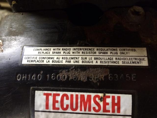

slf-uk 914 #35 Posted March 8, 2015 I took a quick picture of the engine number. The spec number is hard to read but the serial number is clear. From my reading that is the 345 day of 1976, which is consistent with the age of the tractor. Iain 1 Triumph66 reacted to this Share this post Link to post Share on other sites
OldBuzzard 186 #36 Posted March 8, 2015 Right then, being a 1976 engine would make your tractor a 1977. 2 Triumph66 and slf-uk reacted to this Share this post Link to post Share on other sites

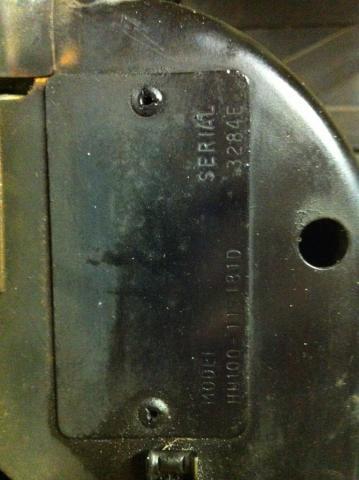

slf-uk 914 #39 Posted March 10, 2015 Not too much to report on the G14. I have made the replacement engine spacers but then found that I do not have any bolts of the correct length so that is on hold waiting for the postie. I have pulled the carb off in preparation for a quick rebuild, pulled the hood off to straighten the hinge area and also replaced more missing fixings. I noticed that I had another Tecumseh engines tractor in the workshop so I couldn't resist popping the hood to check the engine serial number. The tractor is a Bolens G10 but the engine ID tag on a HH100 is partial hidden behind the carb. I managed to get my phone behind the carb and take a picture. Using the formula kindly supplied by OldBuzzard is looks like a 1973 engine made on the 284th day, which suggest that this G10 is a 1974 machine. This is really additive. Iain 1 Triumph66 reacted to this Share this post Link to post Share on other sites
