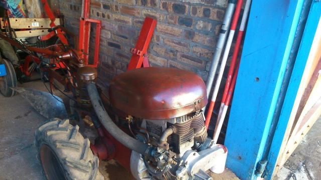

In the UK it is named Owatrol oil RIP But the one you are looking for is  Owatrol oil CIP.  brush off flaky rust then apply oil with a brush very thin coat and let dry then re coat again. I used a cap of a de-icer can.post-117-0-66947600-1425569304_thumb.jpg 2 caps did my Clifford that you see
You can use it as an under coat as well have tried it and it works well
I painted it in June of 2014 it looks the same as when I did it
It is a air dried oil does not seem to leave fingerprints when it is dry and dust does not stick to it
All in all I am very happy with the product
George S :england:  :tthankyou:
