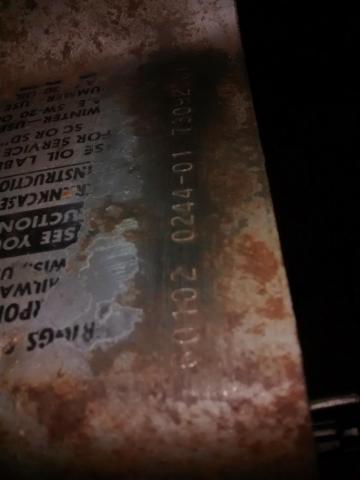

C-101plowerpower 548 #1 Posted April 7, 2015 OK got meself another engine/mower and i was wondering if any of you could date the engine. Share this post Link to post Share on other sites
C-101plowerpower 548 #2 Posted April 7, 2015 OK got meself another engine/mower and i was wondering if any of you could date the engine. Share this post Link to post Share on other sites
Anglo Traction 1,022 #4 Posted April 7, 2015 Sorry Nigel, I reckon 1973 . Can't read the rest of the number to get the month and day...... If you want to have a look at an Illustrated Parts List for it...... - http://www.partstree.com/parts/briggs-and-stratton/engines-horizontal-engine-with-recoil-starter/060102-0244-99-briggs-stratton-engine-rewind-starter/ . You can also download an IPL from B & S here - http://www.briggsandstratton.com/eu/en/search# Scroll the page down to see IPL and User manual choices. Share this post Link to post Share on other sites
pmackellow 2,738 #5 Posted April 7, 2015 First two digits of the third set of numbers = 1973 Share this post Link to post Share on other sites
