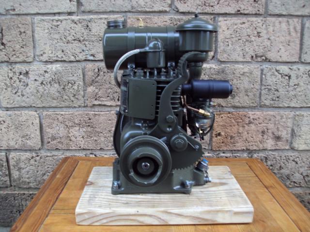

C-101plowerpower 548 #1 Posted July 12, 2015 Got a new toy! its a WW2 military compressor with a Briggs model N engine. we allready had it running after some fresh gas/petrol. not more than a few seconds but it ran. and here's some pictures 3 bowtiebutler956, Stormin and HeadExam reacted to this Share this post Link to post Share on other sites

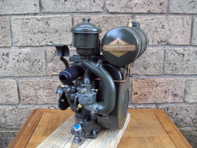

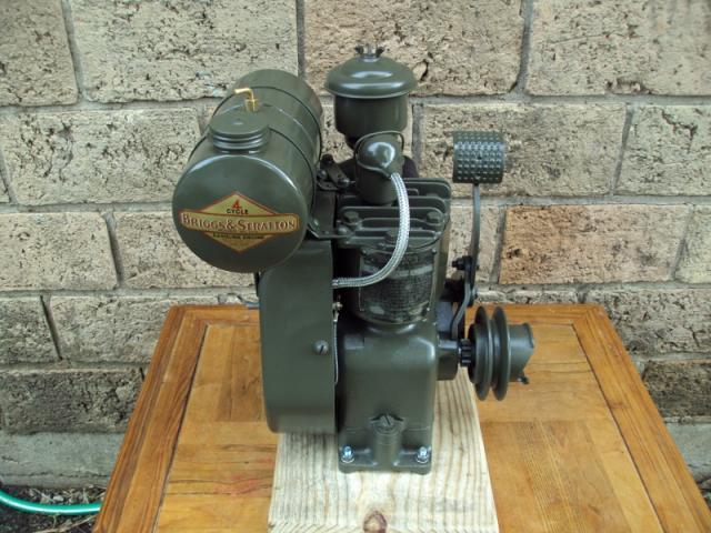

bowtiebutler956 166 #2 Posted July 12, 2015 That is awesome Koen, and I'm jealous! Parts for the Model N are still fairly easy to find if you need them. There is one thing you will need to take care of before running it for extended periods of time. Its missing the shield that wraps around the cylinder to circulate air all the way around for cooling. I like the early models like that one, as they use an oil pump instead of a dipper on the rod. I have a very similar engine to that one, except yours is a couple years older. Here is a pic of mine. Look forward to updates! Matt The last couple pics are of an original one, and it belongs to a friend of mine (Den). 1 C-101plowerpower reacted to this Share this post Link to post Share on other sites

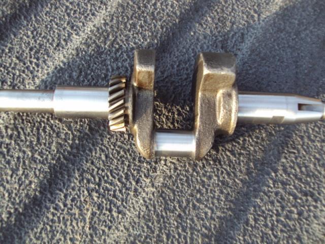

C-101plowerpower 548 #3 Posted July 12, 2015 Thanks Matt, found out that putting briggs part numbers through eBay gives you all ya need one thing i'm almost certain of is that i'll be searching for a new crank. I dont think the keyway should be gone, or rather filled up with werd by the looks of it 1 bowtiebutler956 reacted to this Share this post Link to post Share on other sites

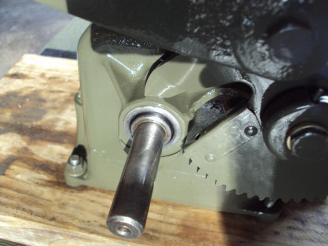

bowtiebutler956 166 #4 Posted July 12, 2015 Thanks Matt, found out that putting briggs part numbers through eBay gives you all ya need one thing i'm almost certain of is that i'll be searching for a new crank. I dont think the keyway should be gone, or rather filled up with werd by the looks of it The cranks on these kick start engines don't have a keyway Koen. They just have a hole drilled in them for the pulley set screw. Here is a picture of mine. Matt 1 C-101plowerpower reacted to this Share this post Link to post Share on other sites
C-101plowerpower 548 #5 Posted July 12, 2015 Oh good that is one less headache 1 bowtiebutler956 reacted to this Share this post Link to post Share on other sites

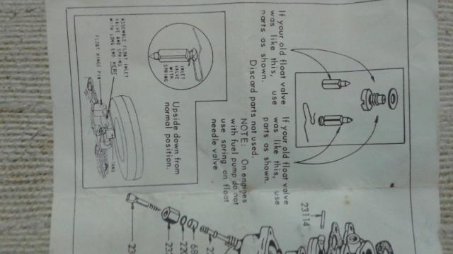

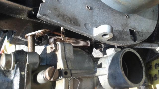

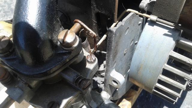

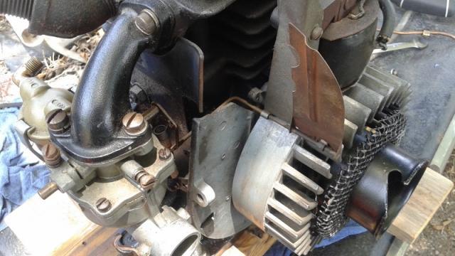

bowtiebutler956 166 #15 Posted July 13, 2015 If your unable to get the needle and seat sealing properly, the Briggs part # for the carburetor kit is 291691, and they are still available from Briggs, and aftermarket. Most of the modern kits don't have all of the proper parts for these old carburetors. However, the needle and seats they supply usually work ok, although they require bending a tab down on the float, because the needle in the kits is usually taller than oe. The main body gasket in the modern kits work well, although the venturi gasket supplied in them is not the correct one for our carburetors, but most the time, you don't have to replace that gasket. If you want a kit with all the correct parts, you have to buy one of the vintage Briggs kits like this one. http://www.ebay.com/itm/NOS-Vintage-Briggs-Stratton-Carburetor-Kit-Part-Number-291691-/151732059572?pt=LH_DefaultDomain_0&hash=item2353ef7db4 Here are a few pics of the governor on a model N. Matt 1 C-101plowerpower reacted to this Share this post Link to post Share on other sites

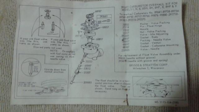

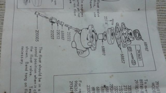

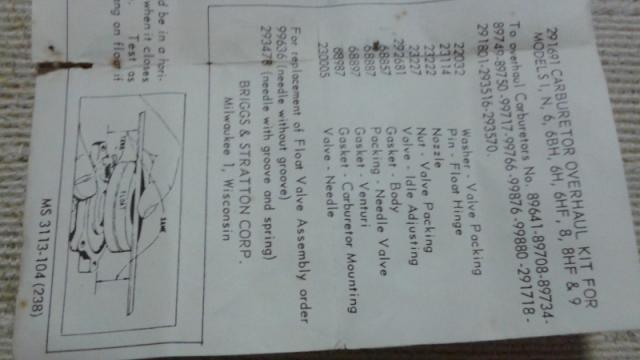

bowtiebutler956 166 #16 Posted July 13, 2015 Here re some detailed diagrams from one of my vintage Briggs 291691 kits. Matt 1 C-101plowerpower reacted to this Share this post Link to post Share on other sites
C-101plowerpower 548 #17 Posted July 13, 2015 thanks Matt, i'll be purchasing that and a couple of other parts soon then 1 bowtiebutler956 reacted to this Share this post Link to post Share on other sites
