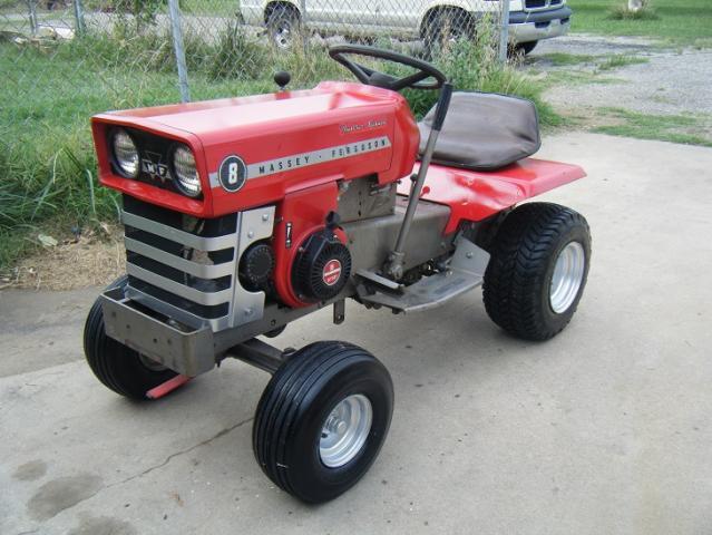

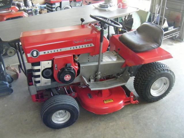

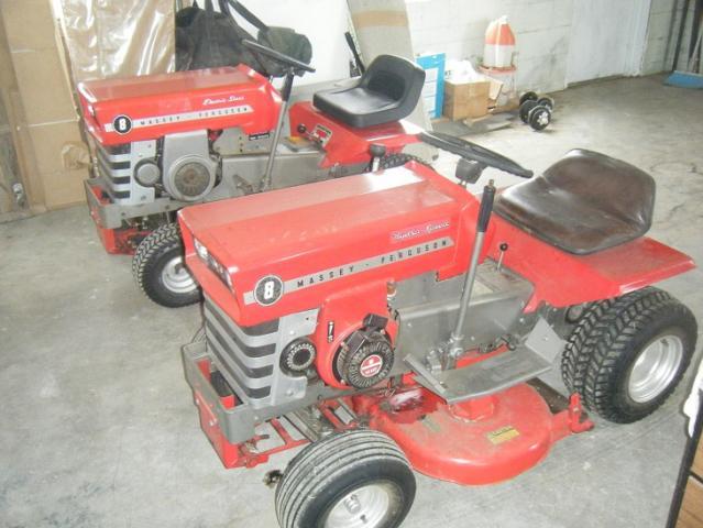

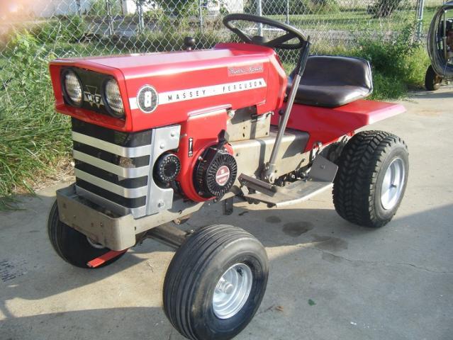

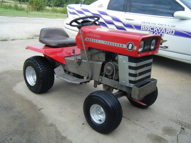

I used a new 10hp Tecumseh to replace my 8 hp Tecumseh from my Massey MF-8, they were exactly the same size and the old exhaust and  air box bolted right onto the new engine. The new air box was oval, not round, and would not fit through hood, so I was glad  the old one fit and I didn't have to cut the hood. The new 10hp Tecumseh was about 295.00
