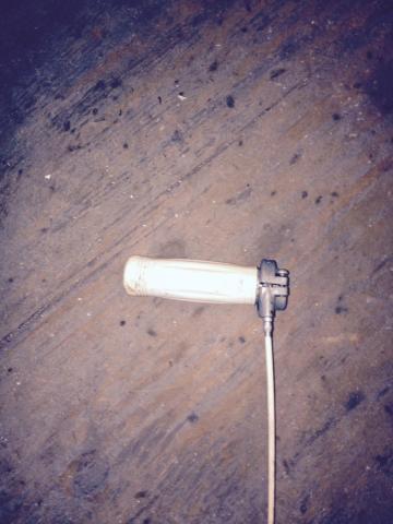

O&RBike 47 #11 Posted August 13, 2015 Curious what you guys are using for throttle cable setups on these. I'm trying to rig up a mini bike type twist throttle and looking for ideas. It doesn't seem possible that it will spring back to idle unless there is some kind of return spring in the handlebar throttle itself as the spring at the butterfly is so light. What does a stock throttle cable look like ? Thanks Share this post Link to post Share on other sites
Wallfish 718 #12 Posted August 13, 2015 The O&R throttle setup on these carbs are a little different for hooking up a throttle cable in the sense that the cable does not pull the butterfly open, but it needs to push the butterfly closed to get to the idle position. Most twist throttles will have a return spring built into them. here's a pic of an O&R throttle. Not sure where to get the small conduit but maybe a bicycle shop will have it. Where about in Jersey are you? Grew up in the Cherry Hill area across the bridges from Philly. Share this post Link to post Share on other sites

O&RBike 47 #16 Posted August 14, 2015 (edited) here's a pic of an O&R throttle. Not sure where to get the small conduit but maybe a bicycle shop will have it. Where about in Jersey are you? Grew up in the Cherry Hill area across the bridges from Philly. OR throttle.jpg I am in Cranford...pretty much in the center of the state. How hard is it to find an original throttle...do they come up for sale on this forum or Ebay? Should I be searching under Ohlsson & Rice or Orline? Edited August 15, 2015 by O&RBike Share this post Link to post Share on other sites
Wallfish 718 #17 Posted August 15, 2015 Have only seen 2 show up for sale but that doesn't mean I missed some. They come mostly from Chicken Power engines. The one in the pic came from an Orline hedge trimmer. You can try sending a PM to member Webhead and see if he has one for sale. As a last resort, I can probably sell the one in the pic even though I need it for a Chicken Power. I'll never use it to mount on a bicycle but I like to keep my engine stuff complete. I'll let it go if I have to because I'll probably come across another one before you do. It will need a longer conduit and cable for use on a bicycle. Share this post Link to post Share on other sites
O&RBike 47 #18 Posted August 15, 2015 (edited) As a last resort, I can probably sell the one in the pic even though I need it for a Chicken Power. I'll never use it to mount on a bicycle but I like to keep my engine stuff complete. I'll let it go if I have to because I'll probably come across another one before you do. It will need a longer conduit and cable for use on a bicycle. 'That would be most awesome if you are willing to part with it just name a price. I usually take forever to finish a project and it doesn't bother me to look for weeks or months for a part but this one is for my kid and you know how kids are he is all amped up to get it done so he can ride it around school. I'll take a look around first. Edited August 15, 2015 by O&RBike Share this post Link to post Share on other sites
