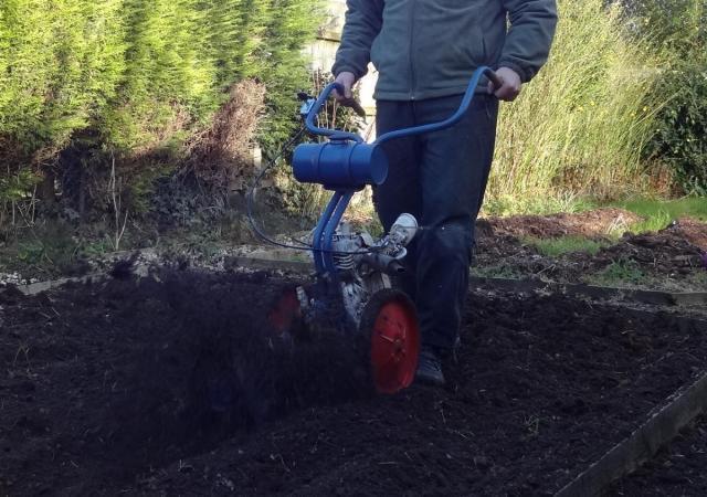

It´s working! Some valve grinding, cleaning the fuel tank, new oil, a new cheap-ish carb and a new lever + cable did the job.
A BIG "Thank You" for all your helpful comments   :)
The only miracle is the governor... the cable is a stiff wire and the lever keeps it in place. no chance the governor can push it back to reduce the engine speed. How can this be solved? At the moment I regulate the engine speed with the lever and make sure it is not too high.
