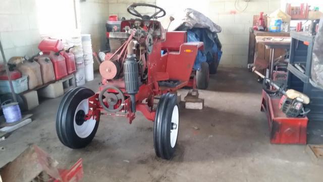

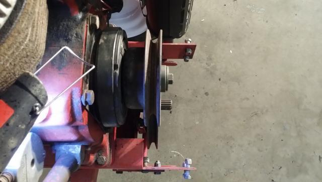

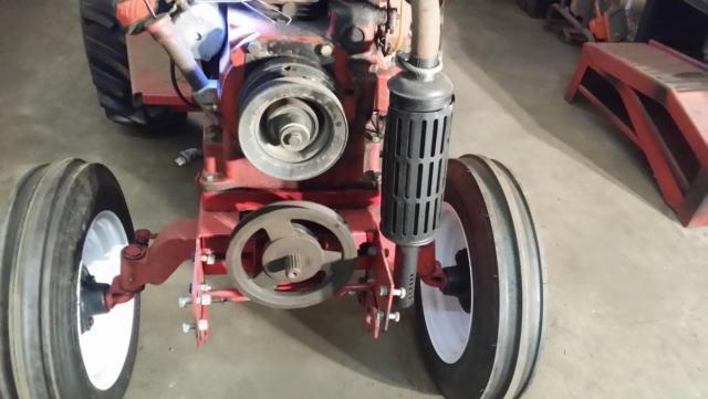

HeadExam 1,783 #1 Posted March 27, 2016 The Kohler powered D series Wheel Horse all came with a manual clutch, but the Onan's used an electric clutch, don't know why. Since this donor tractor was a Onan powered machine I decided to remove the manual clutch from the Kohler D series engine donor tractor and replace it with an electric clutch from a Allis 416H parts tractor. I can now employ the switch in the dash to engage the electric clutch on the Kohler K341 to turn the rear PTO. The bolt holes, shaft, and pulley's lined up perfectly. I feel like a multi appendaged farm animal. 4 Alan, Triumph66, nigel and 1 other reacted to this Share this post Link to post Share on other sites
