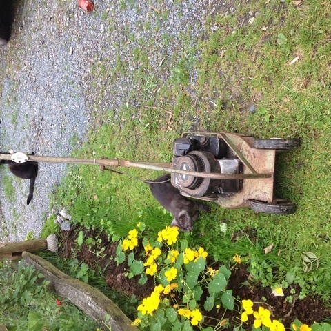

Viking 14 #1 Posted August 25, 2016 Hi everyone hopefully I am in the right place ! I've inherited an old Hayter Hawk cemetery mower and I'm having trouble finding any references online. The Hayter website timeline mentions it briefly in the 1970s section but I'm after specifics! trying to find out the year of manufacture and the size of the cutting deck and height of cut, which is not adjustable. Did it ever have a collection bag? Mine doesn't but is otherwise fully working aside from chipped paint I was pretty impressed considering its age, whilst I don't have much need for a graveyard mower when I tried it out I was impressed at how well It runs and cuts and would love to find out a bit more about it. Would anyone be able to point me in the right direction please? Thanks 1 Triumph66 reacted to this Share this post Link to post Share on other sites

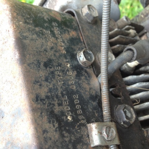

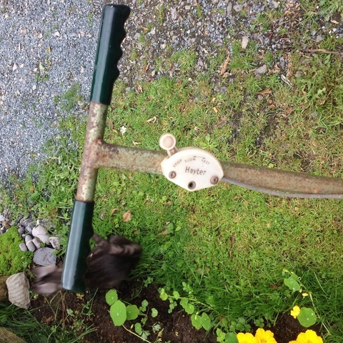

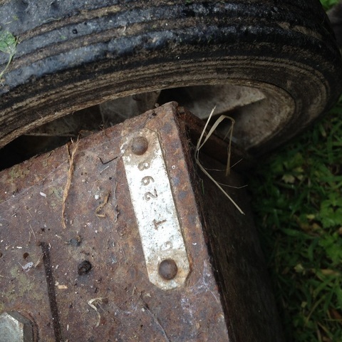

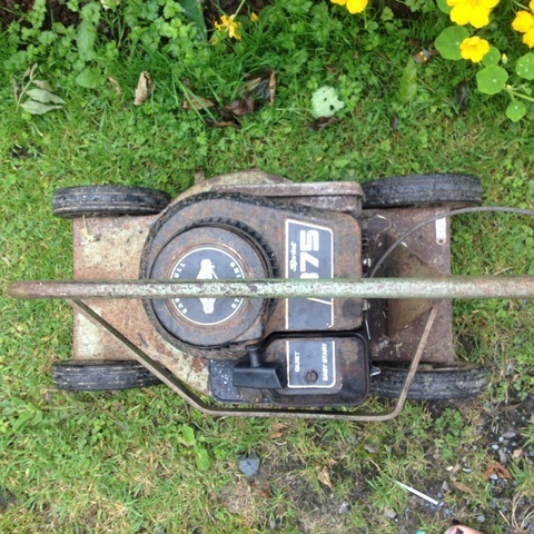

Viking 14 #3 Posted August 25, 2016 Thanks very much for the link Head exam - trouble is not really sure what I'm looking for ill add some photos and maybe someone with more knowledge than me can correct me if I'm wrong might not even be what I think it is Share this post Link to post Share on other sites

HeadExam 1,783 #7 Posted August 25, 2016 It appears your mower is a Hayter Hawk Major serial code 60/7143 by my link. I say that because of the curved handle and the throttle choke lever is only like this on this model, at least one this old. Speaking of old the Hawk came with a motor that Hayter lists as a 133702-103-01, however your engine is a 989022 0306-01 94010505, which means it was made on January 5, 1994. So, either that is a replacement engine or this model was produced into the 1990's, hard to fathom. Should be a discharge chute guard (flat plate) in front and a roller right behind it, It's listed as a 12" width mower 1 Viking reacted to this Share this post Link to post Share on other sites
Triumph66 1,256 #8 Posted August 25, 2016 Viking, as far as I am aware there was no collection bag with these cometary mowers. I attach a photo of a Hayter mower lifted off the Biddenden Show for comparison. This has the original Briggs engine on it. Whereabouts in Devon are you? 2 Viking and HeadExam reacted to this Share this post Link to post Share on other sites

Wristpin 400 #12 Posted August 26, 2016 (edited) You have what was originally called the Hayter 12" Rotary Mower that subsequently acquired the Hawk name. As supplied it would not have had front wheels but just a large diameter anti scalp roller. The wheels were an optional extra. Your comment about it not having any height adjustment is not strictly correct - as you say, there is no lever or other on the move adjuster but if you look at the sides of the chassis there are alternative mounting positions for the wheels and / or the roller. The original machine was then joined by the 19" Hawk Major , the Briggs 13 prefix to the model number signifying a 5HP engine instead of the 3.5HP engine on the 12" machine. Confusingly the Major parts list shows an optional 16" blade. Not sure why anyone would want to put a 16" blade in a 19" chassis. Why was it called a graveyard or cemetery mower? That is what the original machine was designed for ; narrow to get between the headstones, the anti scalp roller to deal with humps and bumps and the nylon rubbing strips to prevent damage to both itself and the masonry. I was told, but cannot confirm, that the original 12" machine was designed at the request of the Commonwealth War Graves Commission for maintaining the orderly and close packed cemeteries both in the UK and in foreign parts. Confusingly Hayter re-used the Hawk name on a light weight version of the 16" Harrier which was mainly sold through the sheds and by mail order leaving the Harrier model name mainly the preserve of the mower trade. https://www.dropbox.com/s/n0qgwb5nfcq725q/Hayter Hawk 12 and Major190001.pdf?dl=0 Edited August 26, 2016 by Wristpin Typo! 3 HeadExam, Triumph66 and Viking reacted to this Share this post Link to post Share on other sites
