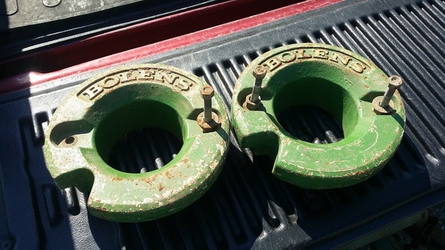

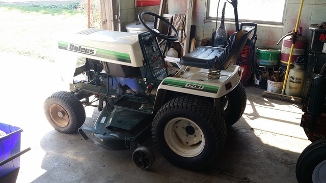

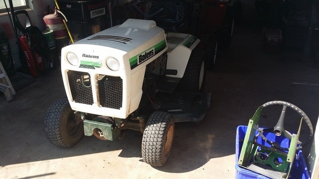

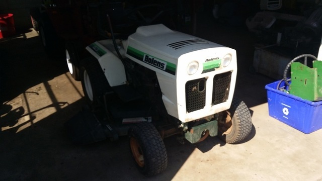

HeadExam 1,783 #1 Posted September 4, 2016 A friend of mine bought a Bolens 1700G with a Bolens snow plow and snow blower that had a blown KT17 in it (in boxes) for 250.00. He said I could have the tractor, if I would travel the 200 miles to get the whole lot and sell the KT17 engine parts on eBay so he is able to defer the 250.00 outlay. I jumped on that deal. The owner also had a set of chains and Bolens weights that went with it so I got to keep those as well. The KT17 engine was a lemon from the get go, and I don't know why this one had a Series one KT17, it was a 1985, tractor, way past the series one exploding engines. It should have been a Series two. I have a John Deere 314 engine, 16hp Kohler k341 single cylinder, that will fit right in without any modifications, this has a beautiful 48" shaft drive deck and will be my new mowing tractor. This model is a 4 speed, 1st gear having lockout. the wheel weights will get Bolens Regal Red paint and go on the 1476. Long drive, lots of disassembly, now to take pictures of the engine parts and list them on eBay. 5 Triumph66, wurzel, Joseph and 2 others reacted to this Share this post Link to post Share on other sites
