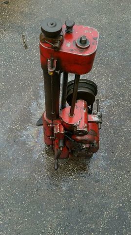

Mister Mad Mower 64 #5 Posted October 28, 2016 (edited) Been busy restoring the " BUMA" , got it striped and rebuilt with a new coat of paint ( Brush on machine enamel ) to keep it good for another 50 years ! . This turned out to all origonal , never been apart .I know this due to the knurled adjuster on the top having a grub screw to hold the centering shaft . The grub screw had a plug over it and the knurling had been done last to hide it all ? . I had to drill the plug out so as to be able to remove the grub screw and so split the gearnbox cases . I have left the hole so i can easily take it apart for greasing etc in the future . I found the grub screw after i noticed a scribed line on the front face of the knurled adjuster , pointing in line with what looked like a keyway down inside so i drilled down and found a cavity , with the grub screw 2 or 3mm below . Edited October 28, 2016 by Mister Mad Mower extra information 2 C-101plowerpower and Stormin reacted to this Share this post Link to post Share on other sites

Mister Mad Mower 64 #7 Posted October 28, 2016 2 hours ago, Stormin said: That's a nice piece of kit. It's a heavy bit of kit , around 70KG / 140lbs or so .Good job the motor has a quick release to take a bit of the strain out of lifting it ! . But yes , it is built to last .Even the main bar has twin Timken taper roller bearings with a 1 1/2" adjuster nut at the top to tighten them up . A bit of a shock really as i was expecting plain bronze or brass split bearings . And the metal componets which looked beyond redemption have all polished up a treat .( shiny ) I like the 2 oiler caps on the motor , even these have taper copper springs under them to keep the felt pads in contact with the shaft . To realise the size , the main bar is 2" / 55mm diameter and the machine is 3 feet high . I am currently working on new tool holders to fit into the head so i can use 8mm boring bars with the indexable SCLCL bits to bring it into the 21st century . And i am still awaiting delivery of the braided wire wrap so i can wire it up nice and neat . Have connected it up and it takes around 7 mins to wind down it;s full 12" of travel , So around 2 inches a min feed rate giving around 1 thou per revolution advance . Wont be long before it gets a good work out . Share this post Link to post Share on other sites

Mister Mad Mower 2 0 #10 Posted March 12, 2018 Hi Bob , sorry about the delay but i lost all my login details as ive not been on here for ages , Had to create a new account just to reply . Here we go - For moving around it's best to remove the motor as this almost halves the weight . The main pulley has the drive lock fitted , engage for cutting and dissengage for winding back / tool sharpening . You found the feed lock to the right of the main pulley , as you say this locks the shaft to engage the cutting feed . Under this is the plain shaft a pulley guard should be fitted to . Above the motor is the plain shaft the tool holder slides onto ( center top of the image of the open box ) for sharpening the cutting tools on the little diamiond wheel behind the drive pulley . The knurled knob on the top has 2 functions , 1- to centralise the boring bar in the cylinder 2 - to lock the tool holder in the boring bar Basically drop the bar in the cylinder without the tool holder fitted and wind the fingers out to centralise the machine , then after clamping it in positon release the fingers and wind the knurled knob back which also raises the locking pin in the boring head so after youve set the tool in the holder you can slide it into the bar end and turn the knurled knob down to locate and lock the tool holder in place . You should be ok with measuring the bore and setting the tool in the holder using the micrometer , the same hole that locates and locks the tool holder aligns the tool holder on the micrometer . On the side is the auto stop , set the depth of cut on the bar so it knocks the switch off once the tool has cleared the bottom of the cylinder . See youve got the table , mine is a portable one that simply sits atop the engine and a bar drops down the adjacent cylinder and a cross bar is used to clamp the machine in place using the engine block . Once again appologies for the late reply but i am back on here now so should be able to keep up from now on . Share this post Link to post Share on other sites

Mister Mad Mower 2 0 #12 Posted March 13, 2018 Hi Bob , yours look pretty good for it's age .Mine was solid rust but as it's British it cleaned up and polished nice and easy . The bore looks good , love the Rotax engines .A friend had a 650cc bike .90mph in 3rd gear in around 4 seconds . The clamp works by having a long threaded bar to drop down through one of the engine bores so you can secure a cross plate under the cylinder liner .Using a toggle bar at the top to turn the cam to clamp the machine down .( shown in your images as the plate / cam under the rear of the motor ) Belive that it works the same with the table , I re wired mine and added the plastic expanding cable sleeveing to the cables to stop any damage occuring to them . The return spring for the centering fingers is a real problem , unless you realise the model Mamod steam trucks use a long one as the drive belt ........ I got one and cut it to length , then twisted the springs together and i added a spot of solder over the joint to make sure it didnt slip apart when the machine was opperating . I am busy making a new tool holder . Bought a few small boring bars that take the tri pojnt carbide tips , Thinking along the lines of modernising to bring the cut upto modern expectations iff you know what i mean by that . Also got the metal and a new micrometer head unit to make up a new tool setter for the boring bar unit when i get it finnished as the bars are cranked so the alignemt will be out between the center line and the cutting tool iff you follow .( the tool will be in and cutting before the head enters the bore ) . Has your's got the number plate on it ? Mine is number 34 , just wondering mainly to see iff earlier ones were red and older ones blue ? Share this post Link to post Share on other sites
