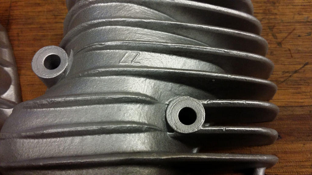

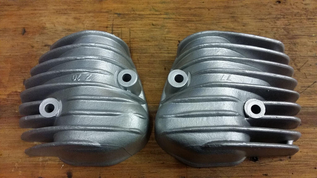

Twinsport 30 #13 Posted November 1, 2016 Greetings! I have used sodablasting for years. It's a mess and I have found that the price for having it done by a company equals the cost of materials. I think the greatest advantage is that since the soda is not reused, the parts that go for blasting is not required to be cleaned first. The soda does leave the aluminium with a matt, dull surface so I usually clean the parts with a pressure washer, dry them and blast them with aluminium grit. Cast parts gets a very nice surface from that. A surface that is very close to what it may have looked like when new. An example of this is the valve covers from My Zündapp: /Steen 1 Stormin reacted to this Share this post Link to post Share on other sites
