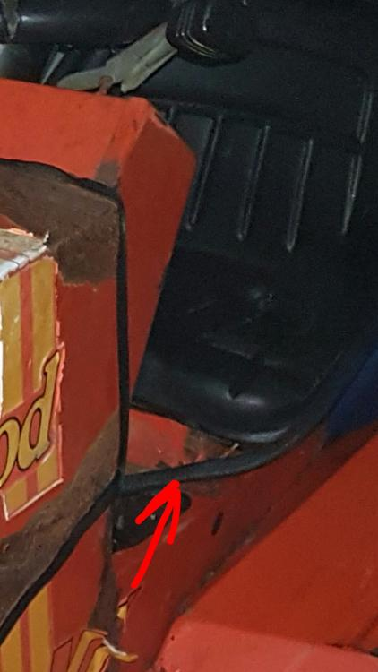

Jack rush 0 #29 Posted February 2, 2017 Where can i but this from and whats it called Share this post Link to post Share on other sites
nigel 1,880 #30 Posted February 2, 2017 Why do you need it jack it should just push back on Share this post Link to post Share on other sites
Wristpin 400 #31 Posted February 4, 2017 That seat trim is/was available as a Countax/Westwood part but otherwise just Google automotive trimmers or automotive trim suppliers. Share this post Link to post Share on other sites

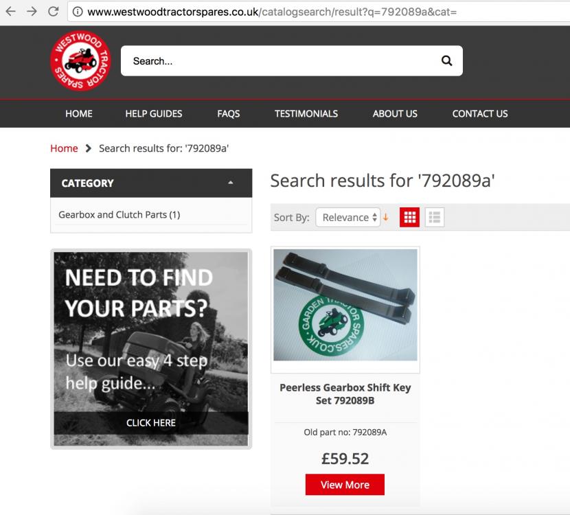

Jack rush 0 #32 Posted February 12, 2017 Hi where can I get 792089a shift keys from I've cracked my transaxle open and got them out just was stuck in finding them on the Internet. Also how do I fill the transaxle up with oil is there a fill valve of what? Thanks. Share this post Link to post Share on other sites
Cub Cadet 613 #33 Posted February 12, 2017 10 minutes ago, Jack rush said: Hi where can I get 792089a shift keys from I've cracked my transaxle open and got them out just was stuck in finding them on the Internet. Also how do I fill the transaxle up with oil is there a fill valve of what? Thanks. I'm pretty sure the gearbox should be filled with grease. I did a quick internet search and found this website with keys, i'm sure someone on here will have a better idea of where they can be sourced. Share this post Link to post Share on other sites
Jack rush 0 #34 Posted February 12, 2017 Thanks but now can I fill it Share this post Link to post Share on other sites
