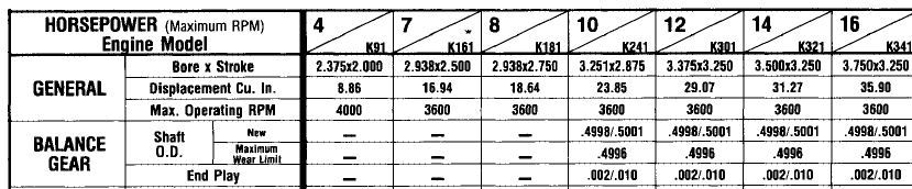

meadowfield 1,901 #6 Posted February 11, 2017 K341 and magnum 16 are usually set to 3000rpm governed speed. same size pulley on engine and pump will give you 3000rpm tops. Share this post Link to post Share on other sites
Anglo Traction 1,018 #7 Posted February 11, 2017 Mmm, My manual states it runs at 3600 which is max for a standard motor (except K91). Therefore 1800rpm at half throttle. Not recommended to run constant below normal full rpm for various reasons (e.g. Oil splash Lubrication, Alternator output and HP). Suspect it would be best to set your pump to run at it's normal rpm when the engine is at or near full speed (I set my engines to 3450rpm using a cheap Laser Tacho). Share this post Link to post Share on other sites
meadowfield 1,901 #8 Posted February 11, 2017 Hmm, my magnum 16 has a sticker saying 3000 is the max speed. I just assumed that was due to its size? Share this post Link to post Share on other sites
