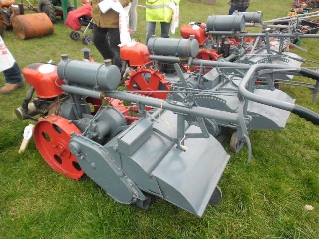

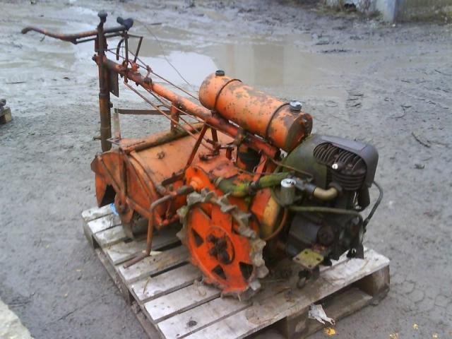

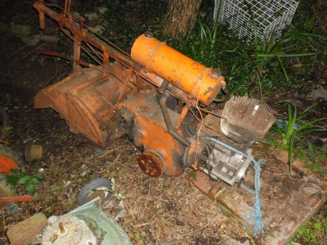

S1g 579 #1 Posted February 2, 2014 Here's some shots of my oldest and newest gems. The first is a roteho gem number g367. I'm still looking for a gearbox for this one( needs to come off a machine with the number g500 or lower).-if ny one can help? The second is a dowdeswell 650, this also needed a new gearbox, which I've now managed to turn up a correct period one. G367 is from 1942 and the 650 from 1988, even tough they are 46 years apart you can see bar the engine how little the design changed over the years. 3 Lauber1, HeadExam and simar kid reacted to this Share this post Link to post Share on other sites

howardman 30 #3 Posted February 2, 2014 The Dowseswell looks like it had a hard life...what horsepower is it ? its a big engine compared to what powered the earlier machine. Hope you get the parts for the earlier BJ gem , ive got to like the British junior engine (working on one at present as you know ) but cant stop checking oil tank to be sure oil is pumping back to tank!!!,,,,,,looks similiar to the earlier australia built Aj engine. Share this post Link to post Share on other sites
S1g 579 #4 Posted February 3, 2014 Hi pat, the dowdswell does look a bit rough in the photos however most of it is superficial. The biggest problem with any diesel gem but particuarly the ruggerni version is that no thought was given to the extra vibration trying to shake the machine to pieces. The reason this one needs a gearbox is the original owners son used to start it up for the old boy in the morning then it was left ticking over all day and all the shafts etc have worn away at the casing. The rear rotor covers have in exceptional condition and it is still supposed to be on its original set of tines. I believe it is rated at 9-10hp. With reference to the earlier machine ive also got an Australian junior, apparently quite an early example, probably dating from around 1930. There is a lot of similarities. The roteho in picture has a British junior fitted however after researching its history in the factory records it would of originally had a jap engine instead, so I have obtained a 1940's example redy to fit should I ever turn up another gearbox. From g501 onwards the gearbox (and thus main frame)was lengthened by about 2inches to incorprate a change of design to the the main shaft berring. Here's a shot of g621, another early gem that I own, after nearly two years of trying I still haven't persuaded the clutch to come off the main shaft. Also here's my Australian junior. Share this post Link to post Share on other sites

S1g 579 #8 Posted February 4, 2014 Hi Gareth I always had it in my head that the early British built Howard gems had the BJ engine...didn't realise that the jap engine was available in the those first few hundred machines. Was expecting the ruggerni version to be bigger horsepower. Any idea when the last British Juniors engines were made? Hi pat just looked it up in the dowdswell price list of 1986 and its actually listed as 12hp. If its any interest the list price was £2678, in those days a small car wouldn't of cost that much more new! Share this post Link to post Share on other sites
