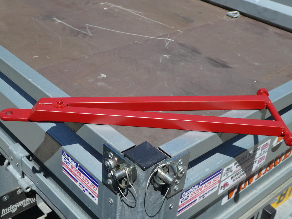

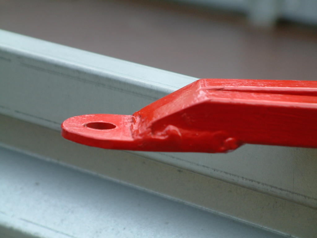

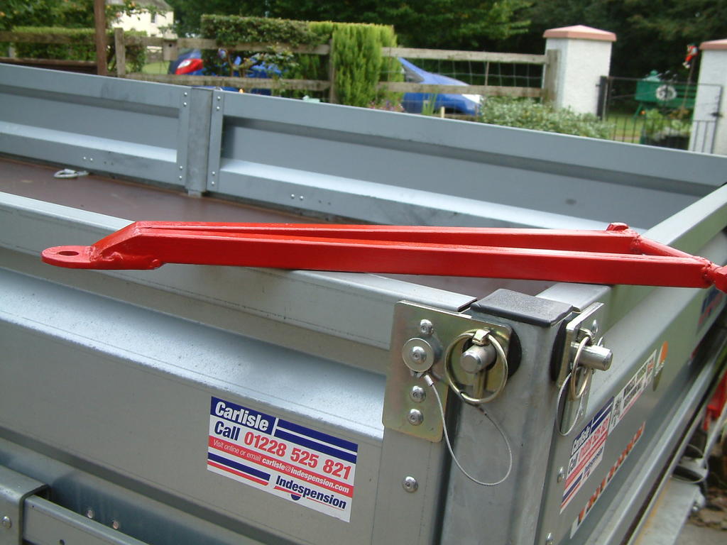

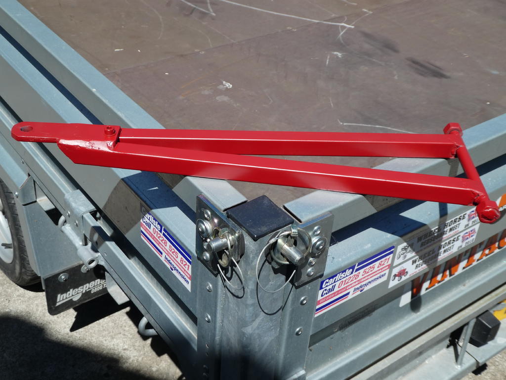

Stormin 4,458 #3 Posted August 30, 2017 When the Showman tried out the one I made for him, a small problem reared it's head. The ends of the box section under the towing eye were catching when turning. Should have made the plate with the pin hole longer, but it was all I had. A piece left over from the slot hitches and cut in half. Yesterday I did a little mod to mine. Works ok now, either way up.. 2 the showman and Alan reacted to this Share this post Link to post Share on other sites
the showman 4,074 #4 Posted August 31, 2017 That's better Norm, wondered if they should be a bit longer ? Share this post Link to post Share on other sites
Stormin 4,458 #5 Posted August 31, 2017 They could but cut and extended using the other box section as an insert/sleeve. Share this post Link to post Share on other sites
the showman 4,074 #6 Posted August 31, 2017 Hadn't thought of that. That's what I'll do. Share this post Link to post Share on other sites

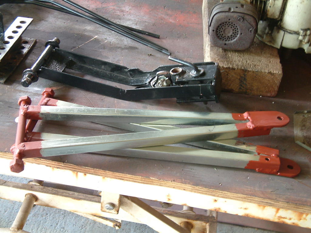

Stormin 4,458 #7 Posted July 1, 2018 Knocked up another one last week. I can now tow two tractors at once. Now all I have to do is try towing two at once. 2 the showman and Alan reacted to this Share this post Link to post Share on other sites
the showman 4,074 #8 Posted July 2, 2018 Ive got one just like that. Share this post Link to post Share on other sites
