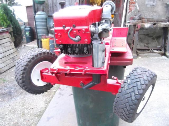

norlett 32 #1 Posted February 4, 2014 Getting Ready For Newby Hall Tractor Fest June 2014 Half way through Lawn Ranger Rebuild Waiting for Warmer weather so I can paint out side Rain and paint doesn't mix Colour doesn't look great That's me not good at taking picks Share this post Link to post Share on other sites
neil 524 #2 Posted February 4, 2014 Thats gonna look nice when she`s done , you just need find someone to make you some nice Decals , How long you got to go before complettion ? Share this post Link to post Share on other sites
norlett 32 #3 Posted February 5, 2014 It will be at our Bronte Vintage Gathering mid May There will be some pictures taken with the other Wheel Horses on show Think we have booked about six in Got the decals ready to fix (does a good job with them Meadow field) Share this post Link to post Share on other sites

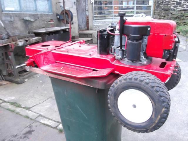

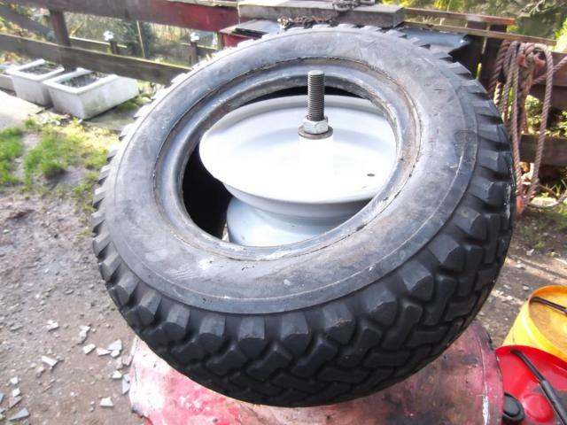

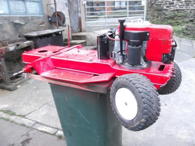

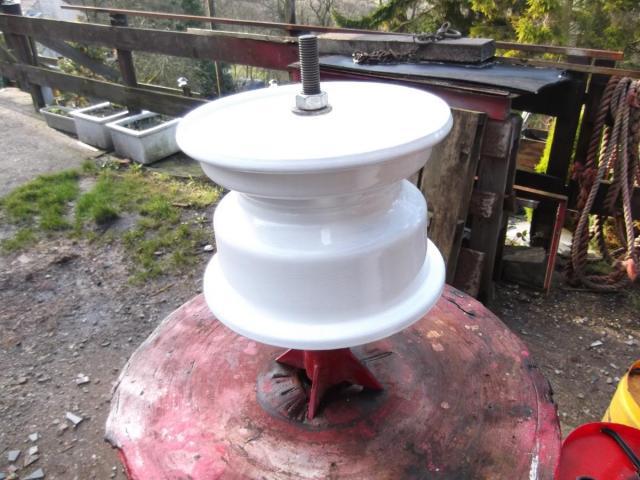

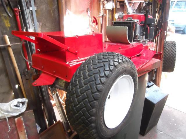

norlett 32 #4 Posted February 11, 2014 Attaching wheel rim to tyre machine before soaping tyre. First fitting tyre over rim. Using our other tyre machine attachment with wheel to press tyre on. Stops catching freshly painted rims. Finished product. all tyres now on painted rims ready to fit. Next job painting (weather permitting) 2 S1g and meadowfield reacted to this Share this post Link to post Share on other sites
pmackellow 2,738 #5 Posted February 11, 2014 Looking good !! Share this post Link to post Share on other sites

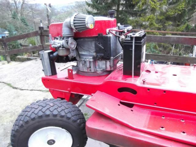

Ian 2,417 #7 Posted February 11, 2014 A nice project, not too much left to do to finish it by the looks of it. I like the more sporty air filter Share this post Link to post Share on other sites
meadowfield 1,901 #8 Posted February 11, 2014 A nice project, not too much left to do to finish it by the looks of it. I like the more sporty air filter A briggs with a K&N that'll boost the HP by at least a few... Share this post Link to post Share on other sites

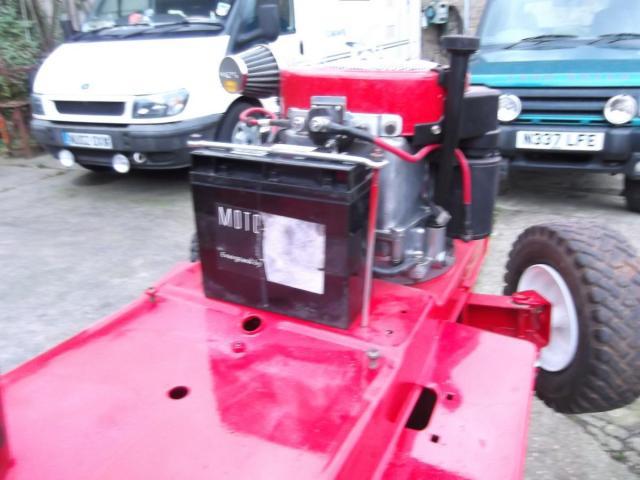

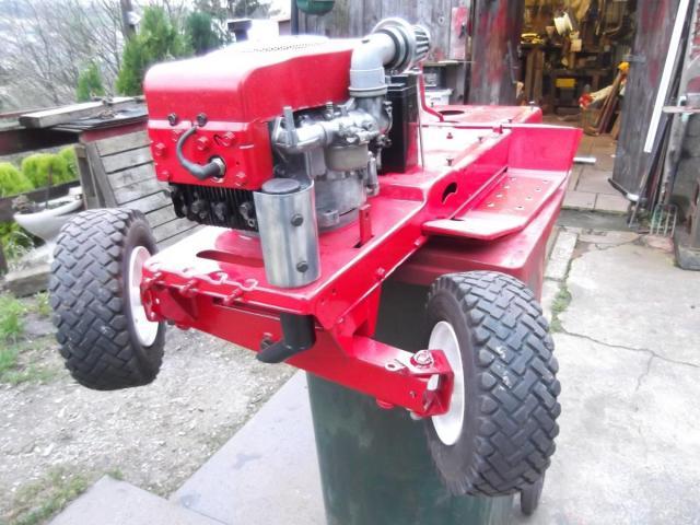

norlett 32 #9 Posted February 11, 2014 Yes you will have guessed. Wrong engine Etc So had to fit K and N filter B/S Carb and filter wouldn't fit under bonnet Notice exhaust and heat shield to keep heat away from fibre glass bonnet Trying to beat Mark (meadowfield) to have it finished for our first outing Share this post Link to post Share on other sites
neil 524 #10 Posted February 11, 2014 Id like to know where i can buy one of those special stands that you have the Lawn Ranger Resting on . Share this post Link to post Share on other sites
norlett 32 #11 Posted February 11, 2014 On a good windy day go out side And presto one comes down the road Empty (You hope) 2 neil and meadowfield reacted to this Share this post Link to post Share on other sites
pmackellow 2,738 #12 Posted February 11, 2014 Best bit of recycling I have seen in a long time !! Share this post Link to post Share on other sites
