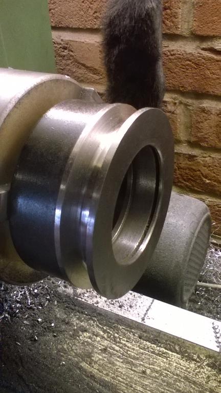

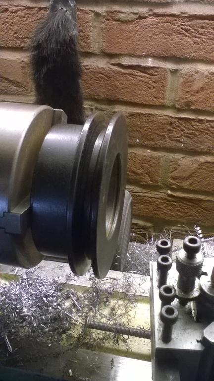

I've got nothing to loose by trying it so I turned the clutch pulley down as small as I dared today. Not sure what it was made from but it was a bit of a struggle on my little lathe.
The before and after. I've ended up with the smaller of the two pulleys I found for sale, if they had any in stock. It was 128mm OD and is now about 110mm. If I do decide to get a bigger pulley for the gearbox it won't need to be quite as big now.

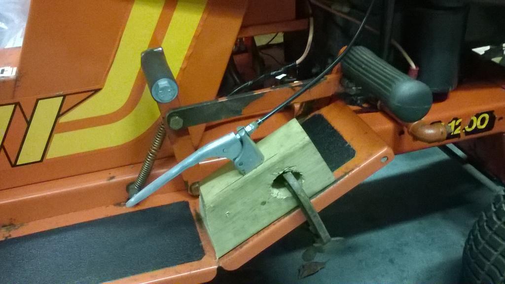

Todays other modification, or rather quick lash up to see how it worked was to fit a foot throttle. I've seen people have fitted bike brake levers so for now I have done similar using an old racer lever I straightened up a bit. The hole in the bit of wood isn't a clever design feature it just happened to be lying about. The good thing is it actually allows more gentle take offs so I will give it a try tomorrow to see if it's any more driveable now.
Like that brake lever / throttle idea :thumbs: even if it does sound like it wants to go and stop at the same time. :confused:  Could possibly use that arrangement on my Half a Horse / trailer build. :)

The throttle pedal worked OK but needed a far heavier return spring on it.  An alternative I've seen on small quad bikes it a combined brake lever with a thumb throttle, depends if you have a steering wheel of handle bars though.
