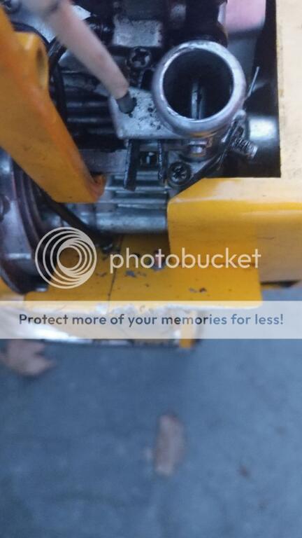

RadRacer203 1 #3 Posted February 10, 2018 Here's a picture of what I think is a vent of some kind. I decided to rob the diaphragm off my running Tiny Tiger generator so that's basically new. I'm pretty certain it's not the crank seals since I didn't feel any play when I had the flywheel off, and even though it was dirty and oily, there was hardly any oil behind the flywheel. Sorry about the bad quality of the picture, but what I was talking about is the little fitting that looks just like the fuel pickup but to the right and down from the fuel pickup Share this post Link to post Share on other sites
revmix 2 #4 Posted February 10, 2018 (edited) I have the same Mustang & color, that copper tubing is the vent & goes up to the top of the fuel tank, can be seen next to the fuel cap opening, maybe the needle valve needs to be adjusted or the hole cleaned [built up dust due to long storage], also the idle RPM maybe too low, when starting give it a bit throttle Edited February 10, 2018 by revmix Share this post Link to post Share on other sites

revmix 2 #6 Posted February 10, 2018 (edited) the tube looks clean if gas comes through & no need to remove the tubing [mine was plugged with oily sawdust & cleaned it with wire pushed through], try to run the engine spraying fuel-mix into the carb, I always do that before getting into the carb Edited February 10, 2018 by revmix Share this post Link to post Share on other sites

revmix 2 #11 Posted February 10, 2018 Quote some fuel seeping out of the vent. it's normal, there is no check valve on the copper tubing, a rubber duckbill can be installed on the bottom Share this post Link to post Share on other sites
