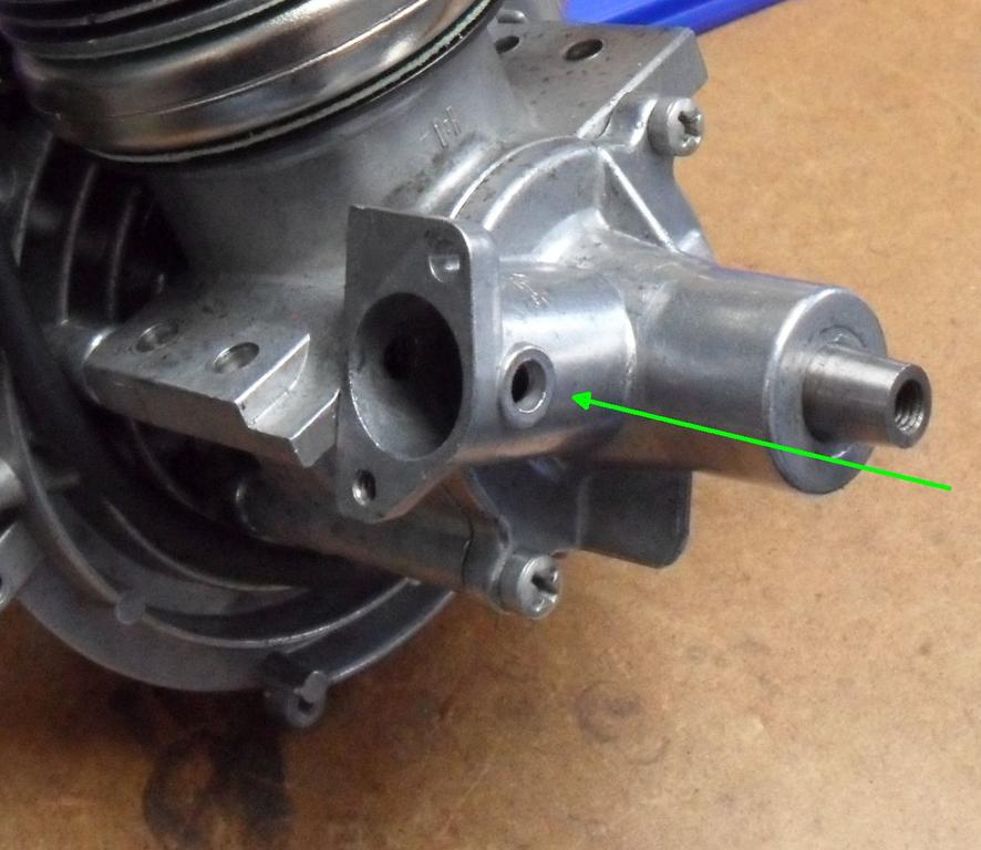

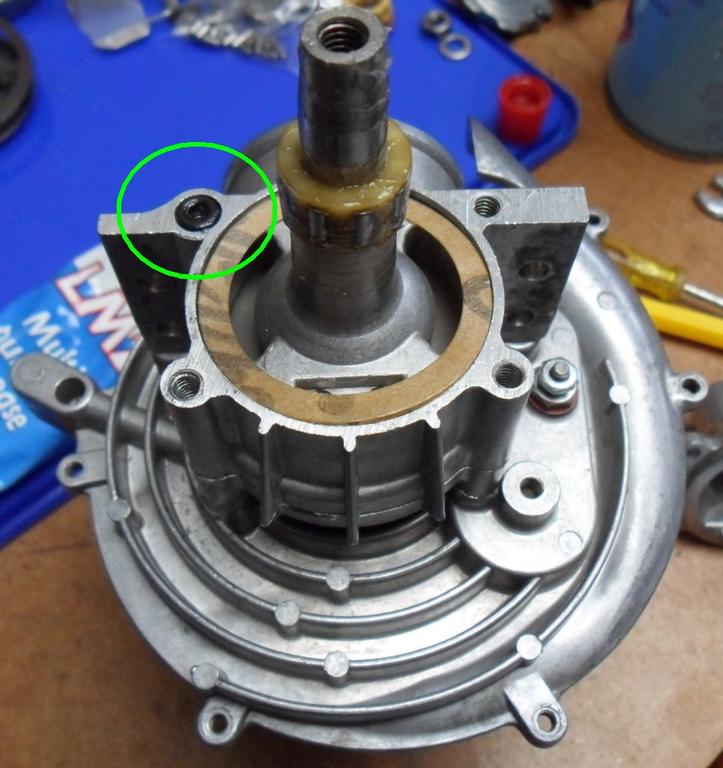

RadRacer203 1 #41 Posted February 19, 2018 Which o ring are you talking about for the "fuel intake on the induction housing"? I don't quite know where you're talking about. If the seal is bad, it's definitely on the side opposite the flywheel. The seal under the flywheel is in good shape still. I have the carb with the slot in the needle, so I had it about half a turn out. The spark plug had a little bit of oil after it popped the once but no more than I might expect. And I'm using the cj14 right now until I can get to the store to get a cj8. Share this post Link to post Share on other sites
factory 487 #42 Posted February 19, 2018 3 hours ago, RadRacer203 said: Which o ring are you talking about for the "fuel intake on the induction housing"? I don't quite know where you're talking about. The picture below shows the O ring I was talking about, it seals where the screw that passes through the induction housing intake that is behind the carb, it often drops out unnoticed. The arrow shown in the picture below indicates where the screw passes through the induction housing intake. There are two seals on the back-shaft (PTO) and another in the gearbox output shaft (that shouldn't cause the problems you are having, it would just leak oil out around the output shaft for the chain sprocket). David Share this post Link to post Share on other sites
RadRacer203 1 #43 Posted February 19, 2018 Ok, I'll definitely check that. Share this post Link to post Share on other sites
RadRacer203 1 #44 Posted February 19, 2018 I don't think I've ever had to take that cover off before but I guess I have to now to check that and the crank seal. I think there's gas dripping out the carb because the check valve isn't sealing very well still. Are there any known problems with that? I made sure it was sealing well on the bench before I put it back on, but when I leave it sit, a puddle starts underneath it Share this post Link to post Share on other sites

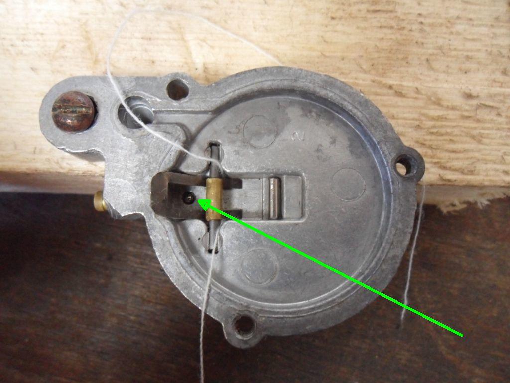

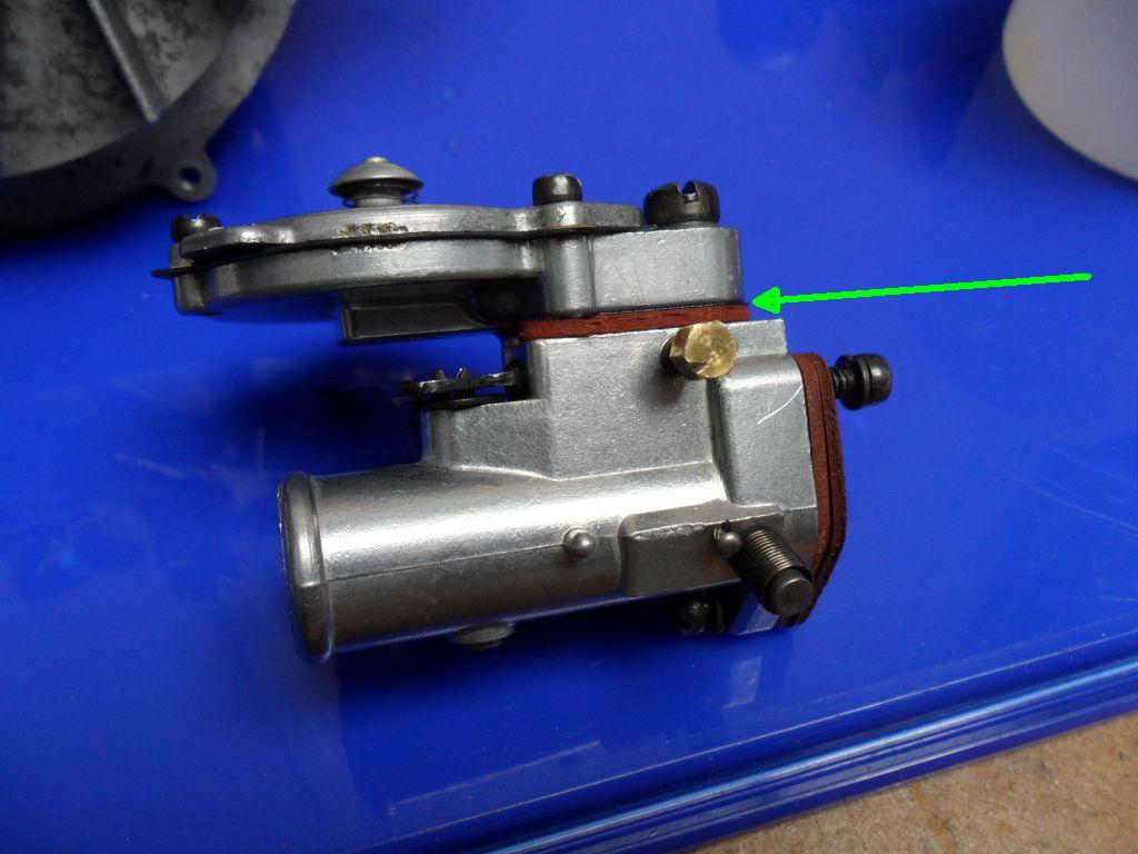

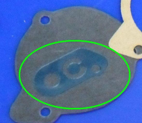

factory 487 #45 Posted February 19, 2018 8 minutes ago, RadRacer203 said: I don't think I've ever had to take that cover off before but I guess I have to now to check that and the crank seal. I think there's gas dripping out the carb because the check valve isn't sealing very well still. Are there any known problems with that? I made sure it was sealing well on the bench before I put it back on, but when I leave it sit, a puddle starts underneath it Do you mean this check valve? Which can sometimes cause problems or fail completely on early engines. Or the check ball in the carb diaphragm bowl? Which can stick closed even after cleaning (but that doesn't sound like it would cause too much fuel/gas to pass through, unless stuck open or the spring is missing). Note there are two different sizes of this check ball depending on the age of the carb (earlier ones had the small one shown below). I definitely would check these first before taking the engine apart, if you do strip the engine do prepared for the bearing rollers that can drop out (have something underneath to catch them). David Share this post Link to post Share on other sites
RadRacer203 1 #46 Posted February 19, 2018 From what I can see, the fuel keeps flowing when the engine is not running, and more than would be left in the diaphragm area, so what I think it's the little ball under the diaphragm sticking open. The check valve between the carb halves seems to be fine as far as I can tell. I checked it all over before reassembling the last couple times, and all seemed to be fine on the bench. Share this post Link to post Share on other sites
