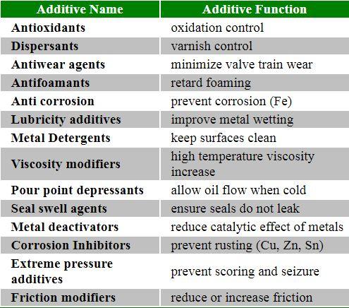

Anglo Traction 1,022 #2 Posted June 30, 2018 Hi, I'm no expert with these engines, but I checked the records for an O & R 1 Hp Chainsaw model from early 1960s and it lists ratio as 16-1. Now I have had discussions with the Chainsaw Website owner in the past and he reckons that if you have an engine that has a Chromed bore, then that Petrol/Gas ratio can be increased safely to 25-1. My 72 Beaird-Poulan Chainsaw has a Chromed Bore and I use that ratio, as well as classic 40wt Mineral Oil (to avoid any issues with synthetic additives affecting the old Oil Seals). I also find that 25-1 is mentioned for these O & R engines on U-tube examples. As for a suitable Oil available in your Country, I found this example is basic Mineral with no Additives- OIL API-SA grade is devoid of Additives listed here- I'm sure there will be a fellow expert Countryman along at some stage to offer guidance, as I'm on the other side of the Pond. Hope this helps 1 1 HeadExam and Jflair reacted to this Share this post Link to post Share on other sites

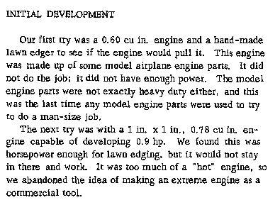

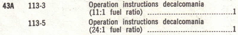

factory 487 #7 Posted July 1, 2018 (edited) On 30/06/2018 at 11:49 PM, Anglo Traction said: Hi, I'm no expert with these engines, but I checked the records for an O & R 1 Hp Chainsaw model from early 1960s and it lists ratio as 16-1. I'm not sure where you found that information but there were no 1HP O&R engines in the early 1960's (only 3/4HP) and the only mention of a 16:1 ratio is for the much later 1970's 1.6HP Model 20A engine, there seems to be a lot of incorrect information around for these engines. Here are some old fuel/oil mix ratios from the various O&R manuals & literature I have, the ratio changed over the years; 1961 & 1962: 3/4 pint #30 SAE oil per gallon (11:1 ratio), these early compact engines where rated at 3/4HP. 1963: 1/3 pint #30 SAE heavy duty oil per gallon (24:1 ratio), again only 3/4HP compact engines available then. 1966: 1/3 pint #30 SAE heavy duty oil per gallon (24:1 ratio), for all 3/4HP, 0.85HP, 1HP compact engines. From the NIAE test report (published 1964), "the petrol/oil mixture has been changed to 24 parts petrol to 1 part oil and the recommended grade of oil is heavy duty M.S. type SAE 30" (was 3/4 pint to 1 gallon when they did the testing in Jan-May 1963) many design changes were made following this report. There was also a mention of chrome cylinder linings, here is the information I have for some of the O&R engines; 1963: Early compact engines had a steel sleeve cylinder with chrome piston rings (earlier information from 1960 doesn't mention the rings being chromed) 1975: Model 13B engine (1HP) has steel cylinder liner with special alloy cast iron rings, and to confuse things more the brochure (undated) for the newer Model 20A engine (1.6HP) gives a 16:1 fuel/oil ratio using either SAE 30AD or MS motor oil, these engines had a chromed cylinder bore. Forum recommendation for fuel/oil mix ratio; We have been recommending a 32:1 fuel/oil mix on the forum for using modern 2-stroke oils, I have been using a high quality mineral based 2-stroke oil from Stihl, another forum user had problems with the synthetic version of 2-stroke oil from Stihl, see this thread; Obviously you may need to experiment to find something suitable that is available where you are, but I do not recommend oils sold by petrol stations for use with scooters (tried some of that in a Villiers engine many years ago, it was far to smoky), the best stores to try and find something suitable would be a local store that sells & repair garden or ground maintenance equipment, chainsaws etc. Note the all the O&R compact engines & the newer Model 20A have seals made from rubber and also on earlier production engines they used plastic cages for the bearings, these can be damaged by certain additives in some types of fuel/oil. Also if you intend to store the engine for any long period it's recommended to drain all fuel and to put some oil down the spark-plug hole, pull the starter a few times to coat the cylinder & piston and leaving the piston blocking the exhaust ports. I must admit I don’t know if the fuel sold in the UK has ethanol in it, I guess that is something else to look out for which may or may not have harmful additives. David On 01/07/2018 at 5:46 PM, Jflair said: This is great thank you guys for the input! This forum is the place for the O&R info! BigUP I forgot to add that you should check out the carb repair thread if you haven't already and it's a good idea to clean out any old crumbly filter foam from the air filter housing, it can damage the engine if any of it gets sucked in. David Edited July 2, 2018 by factory edited 1961/62 ratio (see post #12 below) 2 HeadExam and Jflair reacted to this Share this post Link to post Share on other sites
