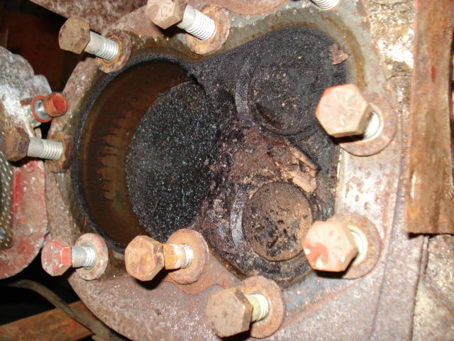

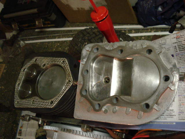

Anglo Traction 1,018 #9 Posted October 21, 2018 This Gasket looks perfectly serviceable as an example (others are available)- K341 . Someone has de-coked that in the not-too-distant past and may not have checked the flatness before refitting, or bolted it down in the wrong sequence and torque setting. Clearly burning fuel at a rich setting, as the exhaust valve should be pale fawn/white colour. The good news is, it is not yet burning any oil from worn rings or cylinder. You should not have a problem cleaning the face up on the head. It's quite straight forward. Just take it slow and let the weight of the head sit on the W or D paper when circulating it. You can use a P320 grade or P240 if it's rough to start, then progress to finer grades. No need to press down hard on it. Use a brush to clean the dust out of the paper regularly (use a mask). If you find it hard to tell the high/low spots, use a coloured felt tip pen to highlight them. I had to learn and have done all my engines that way, even if they didn't need it. I had to start with examples like this- to this- Done properly, you won't need to revisit it after. 1 Cub Cadet reacted to this Share this post Link to post Share on other sites
Westie1 29 #10 Posted October 21, 2018 Good grief that's some transformation! What did you use to remove the carbon from chamber piston and valves? From what I have read this is a result of the throttle shaft play running it lean and warping the head so with head sorted and it's new carb I should be sorted....hopefully. Any tips on cleaning up the outside ready for engine paint? You seem well versed in these things. Much appreciated Share this post Link to post Share on other sites
Stormin 4,458 #11 Posted October 21, 2018 To remove carbon, I use an old 6" rule very carefully. Also a piece of brass strip. I finish off with Scotch Bright or wire wool. For the outside, wire brush, scraper and plenty of patience. 1 Westie1 reacted to this Share this post Link to post Share on other sites
Anglo Traction 1,018 #12 Posted October 21, 2018 24 minutes ago, Stormin said: To remove carbon, I use an old 6" rule very carefully. Also a piece of brass strip. I finish off wi.th Scotch Bright or wire wool. For the outside, wire brush, scraper and plenty of patience. Yep!, and just to embelish what Norm says, the basic rules are - always use a metal that is the same as, or softer than the parent metal (unless you are very careful). Hard Carbon can be removed easier after soaking with various types of oil. I use an old brand called Redex, but even WD40 will assist it. The added advantage of this is that the bits of Carbon will stick together and to the scraper, rather than fall down gap like the side of the piston. I found bringing the piston to top dead centre. Cutting a strip of card that is just thin enough to fit down around the side of the piston. The length of the strip depends on the piston diameter. In your case, it needs to be almost exactly 300mm long and probably 7mm wide. Clean gap out first with a piece of pointed plastic of the same thickness. Add engine oil to the gap around the piston and set the cardboard down around the gap. This will stop most of the carbon rubbish being trapped there while cleaning the piston crown off. I stuffed pieces of rag into the bolt holes and removed afterwards. Clean the cylinder gasket face and valve area first, then do the piston crown last. Clean the piston, then remove the cardboard with any bits still stuck to it. Wipe area again with a lightly oil moistened lint free rag. Add oil around the gap again. Lower the piston in the cylinder and wipe any remaining bits of oil/carbon away. Re-assemble. Just a note on your point ref the worn throttle shaft, yes it can be a running issue, but it's affects are assuming that- -the Air Filter is new and not clogged. -the Carb is at least set to the correct preliminary settings and the ignition is correctly set. Only then will the engine be running lean with extra air. It will also run hotter, which will show up on the exhaust valve colouring. In your case the exhaust valve is black which indicates running rich. I suspect your Air Filter is not new, as the extra air through the throttle shaft is being compensated by the lack of it through the filter making the mixture rich. Hope I explained that clearly for you. Good luck and let us know how you get on. Share this post Link to post Share on other sites

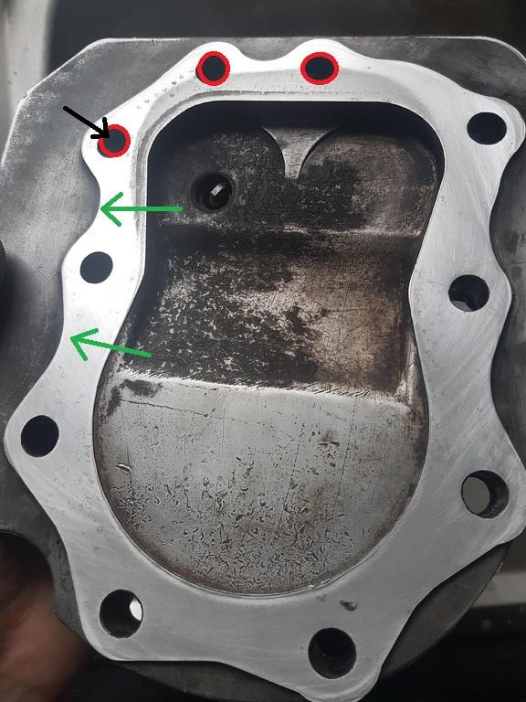

Westie1 29 #14 Posted October 25, 2018 After many hours with course grit wet and dry (still not completely done, it was like a banana!) I'm still not quite done. My head gasket turned up and isn't a perfect fit with the combustion chamber. Is this a problem or not? Thanks Share this post Link to post Share on other sites
Stormin 4,458 #15 Posted October 25, 2018 Not a problem with that, Rob. Share this post Link to post Share on other sites
Westie1 29 #16 Posted October 25, 2018 Smashing I thought best check cheers mate. I best finish this high comp head now lol Share this post Link to post Share on other sites
Westie1 29 #17 Posted October 27, 2018 After about 5 hours with 240 grit I'm still left with this, does it have to be perfectly flat or will the head gasket make up for some? Loosing the will to live and been through lots of paper. Wish I could get bigger sheets than A4 Share this post Link to post Share on other sites
Anglo Traction 1,018 #18 Posted October 27, 2018 Comparing what you started with, it looks a whole lot better. I have never seen one that badly distorted. In an attempt to be practical and honest, I can't help thinking that it needs more done to prevent further leaks?, but I'm a pretty fussy over-cautious person. If you stop there, call it a day and fit it, there is a risk it will leech gasses past the gasket to the two uppermost, red circled bolt holes. I can''t say what the level of risk is. At least the head would not be distorted again when bolted down to spec (unless the cylinder gasket face is not flat). I can't be sure but I think those 2 bolts go onto blind holes?, so may contain any further leaking, but will make it difficult to remove them in future. The 3rd red circled hole with the black arrow carries the bolt which I believe sometimes breaks into the Exhaust outlet chamber. That looks like it would be ok, as you have a small, clean flat face between it and the head chamber. I understand/admire your self disciplined, marathon efforts to get to this stage, but it's your call really. Maybe if you could continue at least to the point of obtaining a flat 'land' on the chamber side of those two top circled bolt holes?. It may help if you place the head down on the paper and presuming you are right handed, place the palm of your hand (ball of your thumb) over the Spark Plug hole area, you can apply slightly more pressure to that area and less over the opposite end. You would emphasise more localised metal removal that way and still achieve flatness. I don't think there is any issue with Valve (lift) Head clearance as a result of metal removal, but it would be worth checking anyway. Just wondering if you have obtained/downloaded a copy of the K series Engine Service Manual?. It's very helpful. Keep at it, you'll be rewarded with a better running Kohler in the end. 1 Cub Cadet reacted to this Share this post Link to post Share on other sites

Westie1 29 #22 Posted October 27, 2018 After burning through 3 more sheets of 180 grit I have flatted all but the depression from the previous gasket. It was much better quality paper I'll buy more Monday. Share this post Link to post Share on other sites
Anglo Traction 1,018 #23 Posted October 27, 2018 To be honest, I would say you are there with it. Hopefully the new gasket rolled lip will sit in the same depression area remaining. You have enough flat area for a gas tight joint now. The original pic of the head showing the blown gas leak areas, which I later showed and denoted (but forgot to explain) with green arrows are now fine. There is just the chamber carbon deposit areas to finish back to bright and you're done with the C/head. Nearly time to arm yourself with a torque wrench and bolt it down to the sequence in the manual. 2 Cub Cadet and Westie1 reacted to this Share this post Link to post Share on other sites
