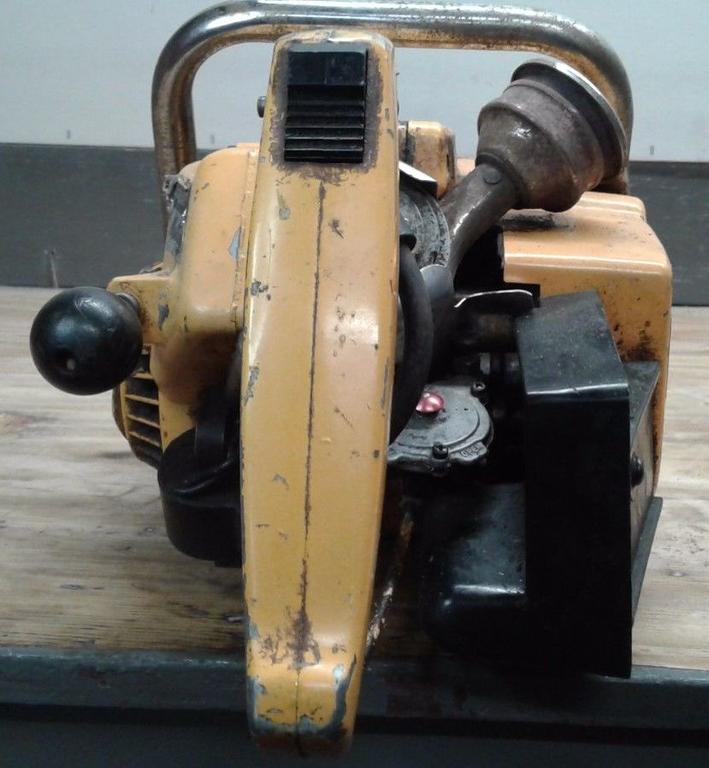

CNew 407 #1 Posted December 28, 2018 Started cleaning up a Mustang 149 chainsaw this afternoon and noticed it doesn’t have any sort of air cleaner. The engine is a Type 236. The intake end of the carburetor does not have a little bar inside the throat or a hole drilled through the edge to use the standard screw hook and air cleaner assemblies common to these engines. Anyone have a guess at what kind of air cleaner would have been used on this saw? And if you know, does anyone have an extra they would like to sell? Thsnks, Clint Share this post Link to post Share on other sites

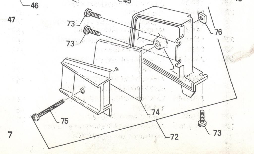

factory 487 #2 Posted December 28, 2018 This is what you are missing; David Share this post Link to post Share on other sites

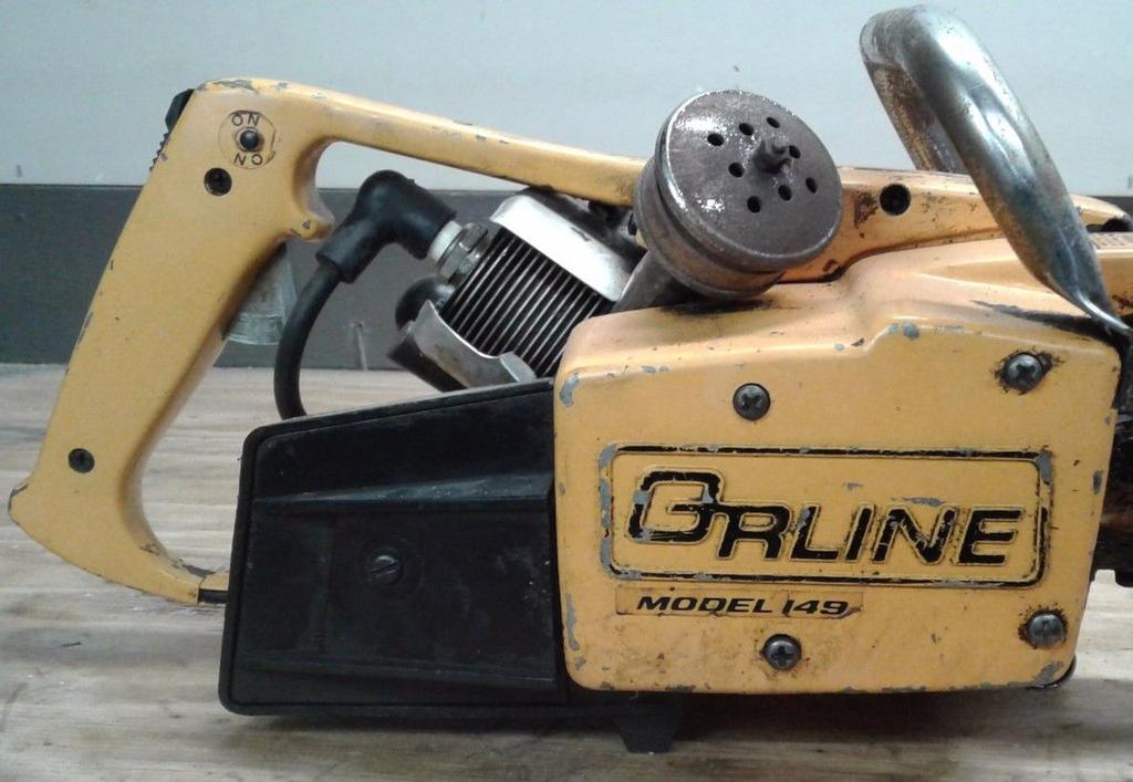

factory 487 #3 Posted December 28, 2018 Here are some pictures of a Model 149 (not mine) showing the air filter assembly; David Share this post Link to post Share on other sites
CNew 407 #4 Posted December 29, 2018 David, You’re amazing. Well that’s not what I was expecting, very interesting air cleaner. I’m a little bummed because that doesn’t look like a common part and it will probably take me quite some time to find one, if ever. Another question, it looks like the fuel line/pick up tube inside the tank is not metal and has the original rubber fuel line which has all but degraded. I doubt I’ll ever find a NOS gasket for the tank. Have you had tried or had any success using RTV type silicone gasket from a tube on these types of applications? Tha is, Clint Share this post Link to post Share on other sites

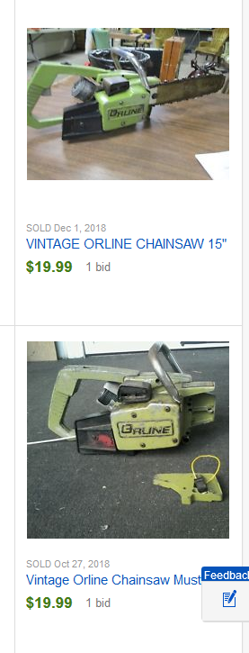

factory 487 #5 Posted December 29, 2018 I was going to suggest a seller that may have one (but they must be on holiday as their listings are hidden), but it may be cheaper for you to buy another saw than an air filter. Found these bargains under completed listings (we can only dream of finding an O&R chainsaw at those prices over here in the UK); Keep looking, I don't think it will be as hard to find as you think. Also I have seen the tank seals on ebay (none recently though), I would advise not taking them apart unless you need to, as the service notes mention the seal swells if it has been used; I would advise against using any silicone sealant that is acid based/curing as it will corrode the alloy, read the safety data-sheets of anything you find as they usually mention the chemicals used and also make sure it won't be dissolved by the gas/fuel. I haven't taken any of my tanks apart, but 'Terry L' on here did (a base tank) in this thread here; David Share this post Link to post Share on other sites

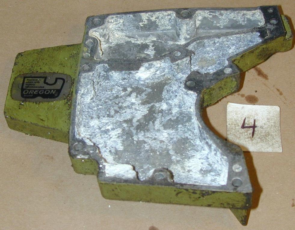

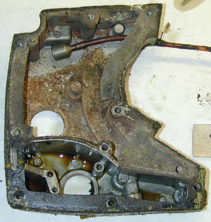

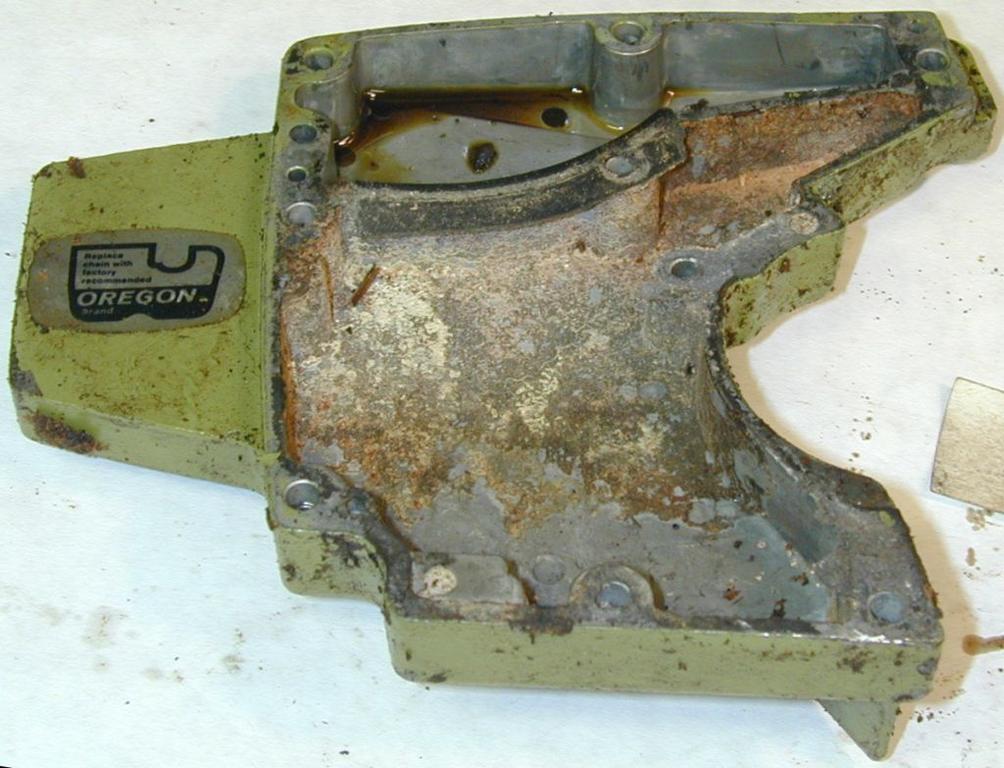

factory 487 #17 Posted December 31, 2018 I'm surprized this one is still available, I've linked it before a long time ago when someone else was looking for one (it's still wrongly listed as a muffler ). https://www.ebay.com/itm/151587552778 1 hour ago, CNew said: I’m really not looking forward to splitting the fuel tank but it’s so corroded I think I have to. I’m wondering if the previous owner did something wrong with the gas/oil mixture or something. The oil reservoir looks really clean, it’s the fuel side that is in really bad shape. Was the saw you bought this one? https://www.ebay.com/itm/2047675.l2557 It looks nice & clean from the outside, usually the alloy rots badly if the original owner didn't clean the sawdust off (the sap is corrosive) after use. If the inside of your tank looks like one in the first two pictures then it may just be crud, the third picture shows a tank with alloy that is self corroding. Note there were three different tank seals depending on the serial number of the engine. David Share this post Link to post Share on other sites
CNew 407 #18 Posted December 31, 2018 David, I’ve actually had that air filter assembly in my Watch List for awhile now and even asked the seller to send more photos, but nothing yet. I may try again. I want to make sure it’s in decent condition. Yes, that’s the 149 I bought - you’re good. It is overall a very clean saw except for the tank. It needs a good cleaning for sure and I haven’t checked the gear box or anything yet. I did have to dismantle and thoroughly clean, oil and re-tension the recoil spring. Interestingly the corrosion in the tank doesn’t look like typical junk or the white discoloration typical of alloys. Rather, it’s all black and yellow inside - almost what you would expect for burnt oil residue. I tried everything to get a good photo but just could get good lighting inside one pic isn’t of the oil chamber and the other isn’t the fuel/oil chamber. It’s basically a charred black inside and all the fuel lines and filters are rotted. Share this post Link to post Share on other sites
