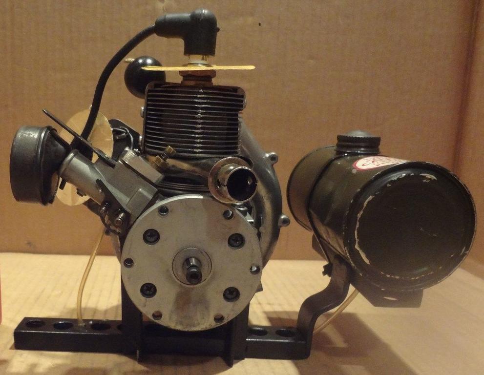

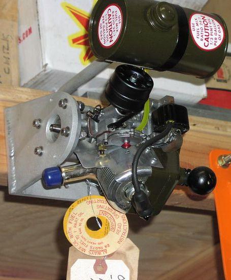

CNew 408 #9 Posted February 17, 2019 (edited) Saw an interesting photo on Pinterest of one of these engines mounted to an aluminum weldment and it had a bent tubular projection off the side for the tank mount. Not sure if it was a complete item as intended or only a partial unit. Edited February 17, 2019 by CNew Share this post Link to post Share on other sites
factory 487 #10 Posted February 18, 2019 Do you have a link for it or the picture? Can't really comment much without seeing it. Or was it this one (picture from ePay, sold in 2016) ? David Share this post Link to post Share on other sites

CNew 408 #13 Posted February 23, 2019 https://www.pinterest.com/craigowens79/garage-scenes/ I thought I would try again but I’m not sure if it will show up with this link or not. After looking at it again I’m guessing it’s just someone’s custom mount for displaying the engine and not necessarily a mounting as part of the original application. Share this post Link to post Share on other sites
factory 487 #14 Posted February 24, 2019 Thanks for finding it again, it does look like someone has made the stand for it, also the two round labels are still with it (that would have been around the spark-plug when new). And finally the filename gives it away too "Ohlsson & Rice engine...NOS military surplus". Here is the picture in question in case it disappears; David Share this post Link to post Share on other sites
