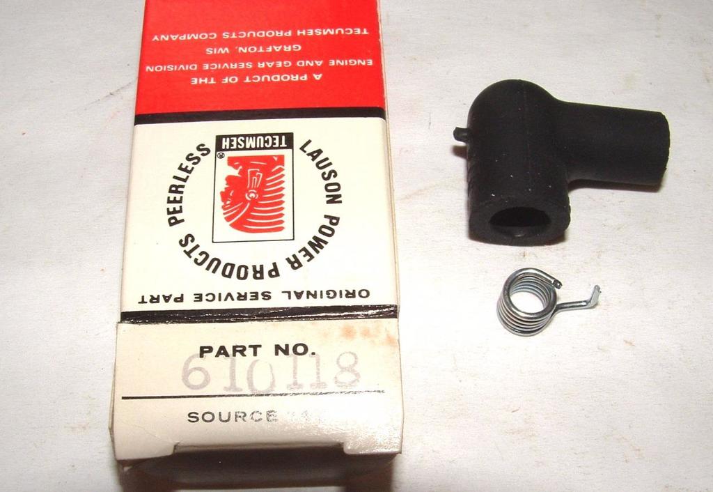

factory 487 #9 Posted February 17, 2019 If you ever need a replacement spark-plug boot, I did find that some made for Tecumseh engines were the same as those used on the O&R engines (apart from the early ones), just check with the supplier that it matches the picture, as you may get a useless modern one instead (been there done that), I did actually salvage & re-use one from a knackered coil too (note; they are a little tricky to fit due to the rubber hardening with age). David Share this post Link to post Share on other sites
CNew 408 #10 Posted February 17, 2019 David, Good to know, I will tuck that away for future reference, more than likely I’ll need to replace one of these boots at some point. Clint Share this post Link to post Share on other sites

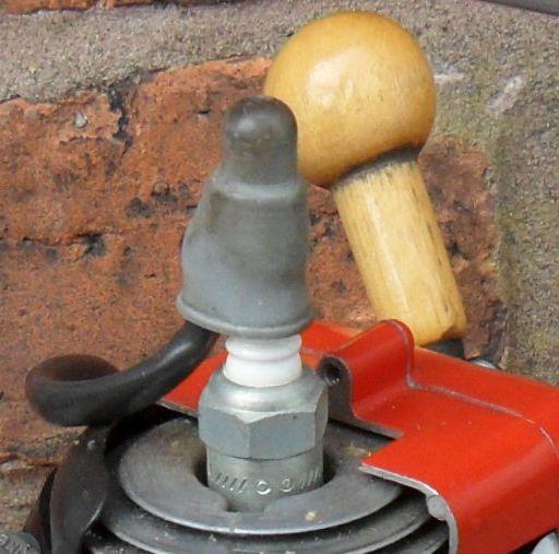

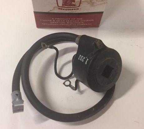

factory 487 #11 Posted February 18, 2019 Here is an example of a NOS Tecumseh coil, googling that you may find something similar to the O&R ones, but it would be best to contact anyone selling one you've found to make sure the sizes are the same and ignore any sellers that can't be bothered to respond. Certainly the primary side wiring looks a bit short on the coil pictured above. On 2/17/2019 at 2:56 PM, CNew said: Good to know, I will tuck that away for future reference, more than likely I’ll need to replace one of these boots at some point. Clint You mentioned you work in 3D printing in another thread, are there any fuel resistant rubber materials that can be used with 3D printing? If there is something suitable, some copies of these older spark-plug insulators would probably be of interest to quite a few of us. Note: these were an option on early engines instead of the spark-plug short out spring. David Share this post Link to post Share on other sites
Wallfish 714 #12 Posted February 18, 2019 Jim, usedtoolman had made some of those spark plug covers using Plasti Dip. It's for rubber coating tool handles and available in black. He may have done a thread on the old forum about it and they came out very nice Share this post Link to post Share on other sites
CNew 408 #13 Posted February 18, 2019 Our company just released a new TPU elastomer material for our 3D printers. I’ll have to look at the chemical resistance specs. This would be a great application! The Plasti Dip idea is a good one too! Share this post Link to post Share on other sites
factory 487 #14 Posted February 19, 2019 I can't remember it from the old forum, but Plasti Dip sounds interesting and unusually it actually seems to be available in the UK (but they do need to update their website, as one of their clients "British Rail" ceased to exist over 20 years ago!). Looks to be available in many colours too; https://www.plastidip.co.uk/colour-swatches/ Must be good stuff as it contains lots of hazardous chemicals, better buy some before they ban it! https://www.plastidip.co.uk/wp-content/uploads/2018/12/Plasti-Dip-Black-SDS-GETF954154C3-UV-1.pdf I'm guessing Jim used a mould to make the spark-plug insulators from Plasti Dip? David Share this post Link to post Share on other sites
