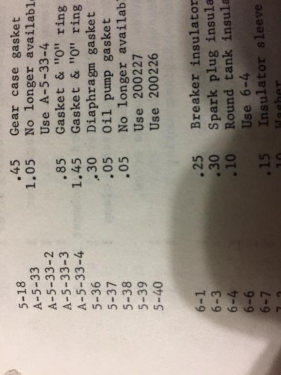

Wallfish 718 #28 Posted January 4, 2020 On 1/3/2020 at 7:46 AM, CNew said: By the way, I’m likely to order some O-rings for the standard O&R chainsaw gas and oil caps. I can’t seem to find anything less than a quantity of 100 so if you guys are in need of a few to refresh your caps just let me know. Those aren't Orings but more of a flat washer, although I'm sure Orings will work. You can make them out of thick gasket material. Share this post Link to post Share on other sites
CNew 408 #29 Posted January 4, 2020 Hmmm, interesting- good to know. I have half a dozen caps that all have worn out O-rings, someone must have replaced the washers over the years. Share this post Link to post Share on other sites
Wallfish 718 #30 Posted January 4, 2020 Only looked at the cut off saw cap and the 2 on the donor Mustang saw when posting Just went out to look at more and the Lancaster saw does have Orings but the other Mustang also has washer type seals. They must have changed over at some point and maybe the IPLs will show different part numbers. Let me know if you want pics of the washer type Share this post Link to post Share on other sites
JUST O&R 237 #31 Posted January 4, 2020 (edited) Found this in the books I have. the oil cap is a 5-40 the new # is 200226 the fuel cap is 5-39 new # is 200227 in the price list it shows to be o ring at some point they must have changed them. looket at a few of the one I have all oring now can only put 2 pic's Edited January 4, 2020 by JUST O&R Share this post Link to post Share on other sites
CNew 408 #32 Posted January 4, 2020 Huh, interesting. Thanks for all the research. Well I already ordered the O-rings so I’ll have plenty and they should work ok, it’s not like I really use these engines/tools much more than firing them up to enjoy them or show’em off... Share this post Link to post Share on other sites
