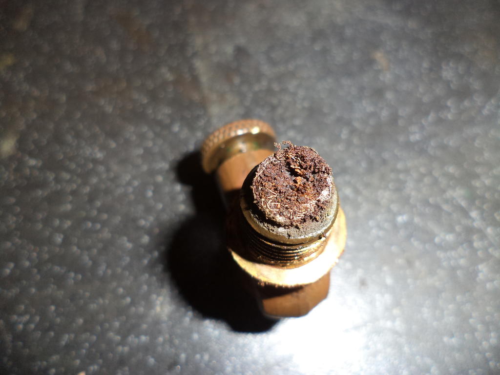

The cork seal on the tap plunger had dried out and the plunger was very loose, after doing some research (IE google) I put it in boiling water for 10 minutes and applied some petroleum jelly to the seal. It seems to have worked.

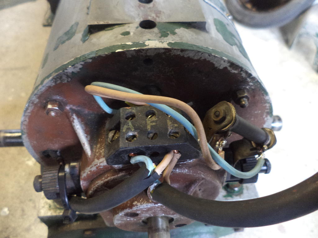

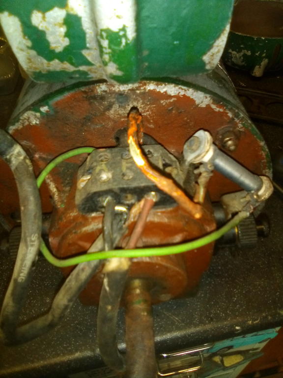

The wiring was in a really poor state so was all replaced.

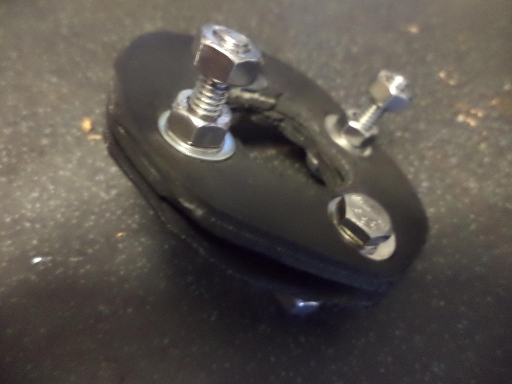

The brushes and commutator were cleaned up as well and I made this somewhat Heath Robinson flexible coupling as the original was falling to bits. A local engineering suppliers came up with a new fan belt for £3.

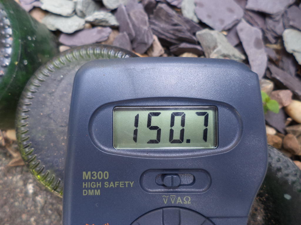

When I got it running again I connected a volt meter to the dynamo output...
We seem to have some extra volts!

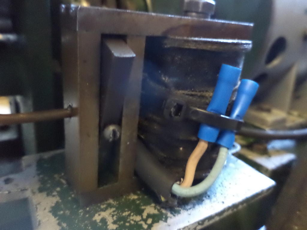

This coil is wired in series with the output and the plate is attached to the throttle and closes it against a spring, the throttle was opening and closing but with the spring detached it wouldn't run at low speed like it did without the dynamo coupled, I'm wondering if the output is controlled by engine speed?

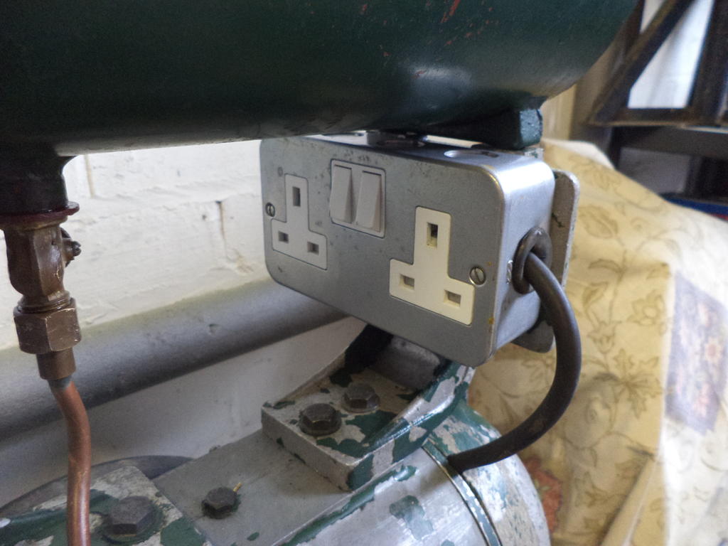

Looking on youtube there is a video of a set like mine running, the guy says it over revved and blew 110v bulbs so he had a 230v worklight (100w?) connected. I replaced the old socket with this one I had in the shed so I can do the same and see what it's like with some load on it.
