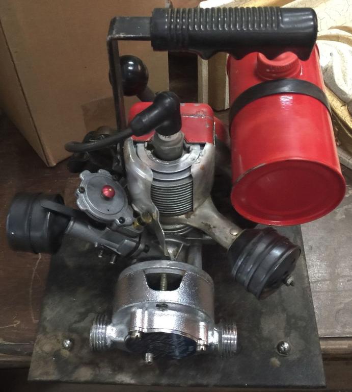

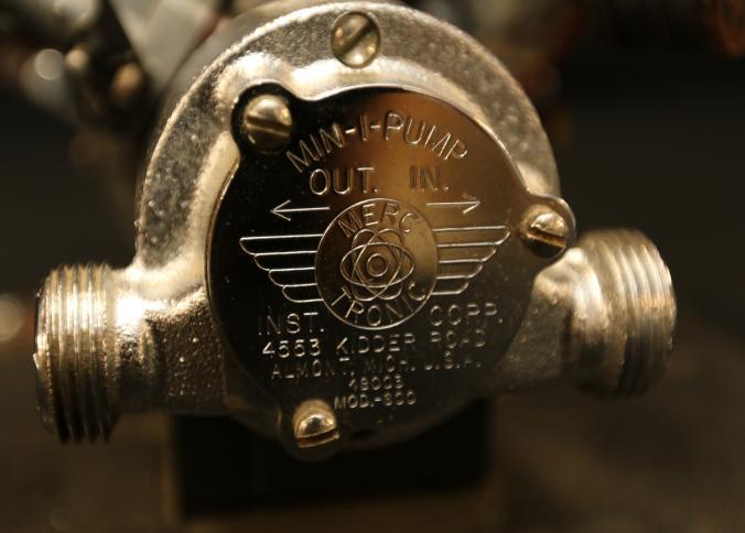

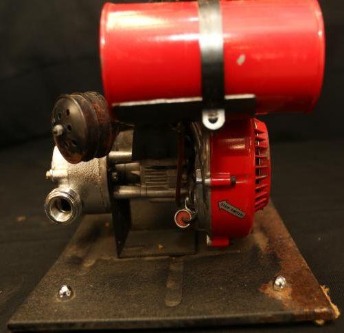

factory 487 #4 Posted March 2, 2019 45 minutes ago, CNew said: It’s a “scrap” engine that was mounted to a vintage stand I'm guessing it was this one, the engine looks in good condition to me, just needs some screws for the starter & a tank strap, air filter has gone as usual! https://www.ebay.com/itm/2047675.l2557 Actually I recognise the stand, it was originally a MERC-O-TRONIC MIN-I-PUMP, I would be asking the seller if they have the pump for it. Pictures below from ePay & another auction site, the second one had that piece of paper about the 'X' needle valve & was SN #122575, five numbers away from your engine. David Share this post Link to post Share on other sites
CNew 408 #5 Posted March 2, 2019 Unfortunately the engine I have is completely seized up. After opening it up it looks like the piston and crank may be royally jammed up. It’s completely rusted inside the piston bore. I’ve got some penetrating oil in it to hopefully free it up but it doesn’t look good at all on the inside. As always seems to be the case mine is also missing the air cleaner assembly. I will also need a flywheel shaft key and tank strap as those are both missing. Screws for the recoil cover are easy. That is indeed the same style base that came with mine. Glad to know what it was originally used for, never heard of the Merck-O-Tronic. My base has seen better days and it is bent quite a bit so it’s not at all flat and stable. I’m hoping I can straighten it out somehow, at least enough to make it functional. Share this post Link to post Share on other sites
Wallfish 718 #6 Posted March 3, 2019 Man, David is good! Bet if you poked around some you could find a replacement pump, make a handle going by the pics David provided and get another display tool out of it when you have a spare running engine. $0.02 Share this post Link to post Share on other sites

CNew 408 #8 Posted March 3, 2019 David- your sleuthing abilities are astounding. Yep, that’s the plan. I put some oil in through the spark plug hole and I’m letting it soak this week. It’ll be a little bit before I have time to work on this one anyway, I’ve got a couple projects ahead of it. I may have a key from another engine I can use and as you suggest it doesn’t look like it would be too terribly challenging to fab a key. John, great idea with the pump - I think that’s exactly what I’ll end up doing with this one. If I can tweak the base and tidy it up a bit this could be a nice item (even better when I get this engine working). Good to know, thank you for the tip! Share this post Link to post Share on other sites
factory 487 #9 Posted March 3, 2019 20 hours ago, CNew said: David- your sleuthing abilities are astounding. I collect pictures of anything unusual, the pump is the same as others used with O&R's but with the custom cover plate for MERC-O-TRONIC. It's a shame you can't just buy the pump from Proven, which I believe was the OEM. Note, the bases on the other two of these pumps I have saved pictures of look to be bent too. A tank strap should be easy to make from some steel strip, or use a temporary permanent fix, a large cable tie. David Share this post Link to post Share on other sites

factory 487 #15 Posted May 14, 2021 It'll be branded Merc-O-tronic on the bit your missing, no idea why I didn't post this before (no it not mine either). Could you find another Orline and transfer the pump over? don't know if they are any easier for you to find in the US. David Share this post Link to post Share on other sites
