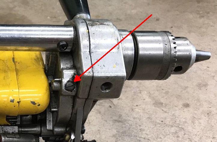

factory 487 #29 Posted March 17, 2019 I can't help with the exact amount of oil for the Drillgine, but the Bridges used one tablespoon of oil (SAE 30 or SAE 10 below 40°F) and one teaspoon added every 10 hours of use. But I'm beginning to think they may have changed to grease at some point, as looking at the pictures of the gearbox on my Drillgine I can't see the two Oil fill screws that are present on earlier ones (and looking through my saved pictures all the later ones are the same as mine). Have you got any pictures of yours now it's apart? Also looking through the master service manual I'm struggling to find anything that says to use oil, the two service procedures for the chainsaws use grease for the gearboxes (Lubri-Plate and Union Oil Co Unoba F-1 grease are the two types mentioned). Can't help thinking I must be missing a service bulletin about this. David Share this post Link to post Share on other sites

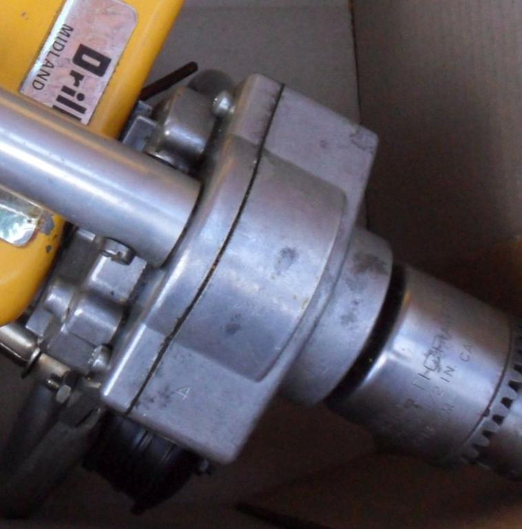

CNew 408 #30 Posted March 17, 2019 David, Thank you for researching through all your info. The Bridges reference is great to know, that’s much less oil than it would take to fill the gearbox chambers so that helps me think the amount needed is just enough to keep things generally lubed. When I cleaned everything this afternoon the only trace of remaining oil had all dried up and if I had to guess may have been about a teaspoon worth all said and done for what I probably scraped out. My drill is like the one in your second photo with the two fill holes. 1 factory reacted to this Share this post Link to post Share on other sites

factory 487 #33 Posted March 17, 2019 11 hours ago, factory said: Also looking through the master service manual I'm struggling to find anything that says to use oil, the two service procedures for the chainsaws use grease for the gearboxes (Lubri-Plate and Union Oil Co Unoba F-1 grease are the two types mentioned). Can't help thinking I must be missing a service bulletin about this. I'm now pretty sure O&R changed to using grease at some point in the late 60's, maybe they knew the seals were a problem then. All but one of the revised (1968/9) parts diagrams in the master service manual have had the gearbox oil filler screw (part #26-36) deleted from the parts list & the # label removed from the diagram (if present). And the one that hasn't is Type 199 with a direct drive clutch only, no gears. So I'm also going to recommend using grease from now on too. David Share this post Link to post Share on other sites
