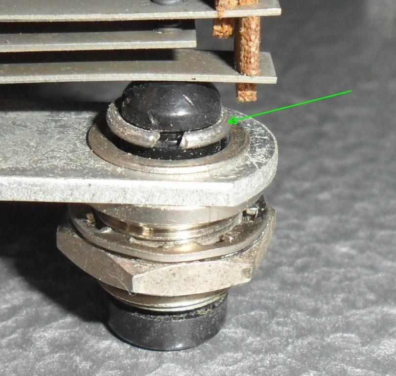

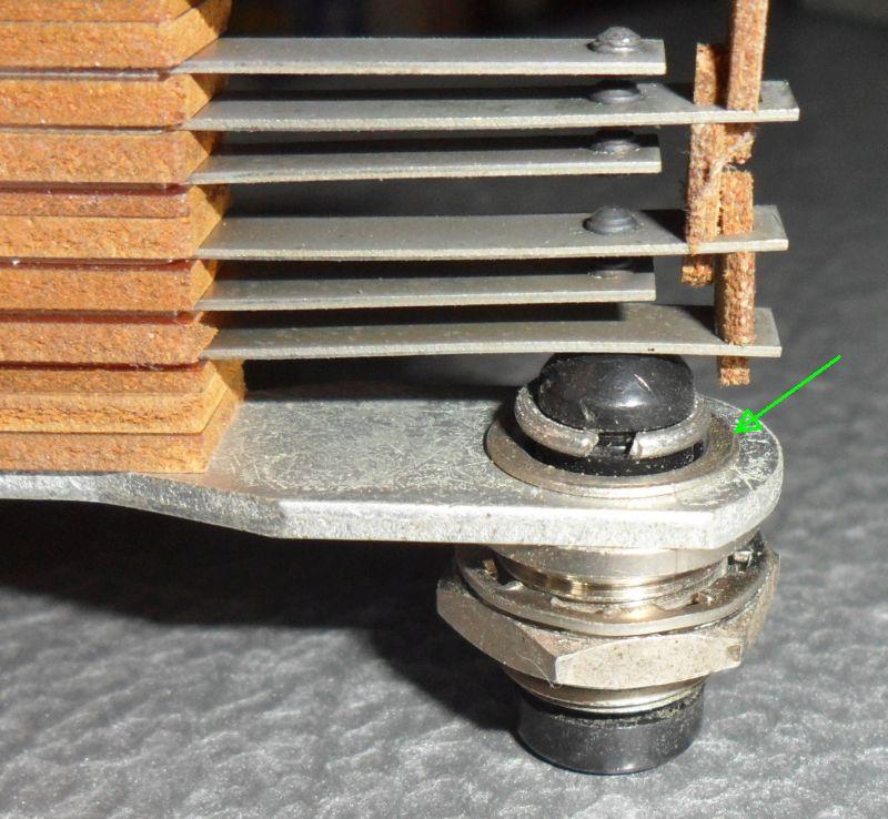

CNew 408 #1 Posted March 27, 2019 (edited) Did some investigating today in search of a replacement kill switch for one that is broken on one of my O&R tools. I thought this might be helpful if anyone else is in need of a similar replacement. The little red push button switch looks to be identical to the Switchcraft 951 from Switchcraft. They have a model “A”, “B”, and “C” and I think it is the “A” version. I have one on order and will confirm once I receive it. This photo is of a good working order switch on a Drillgine. Clint Edited March 28, 2019 by CNew Auto fill was wrong 1 pmackellow reacted to this Share this post Link to post Share on other sites

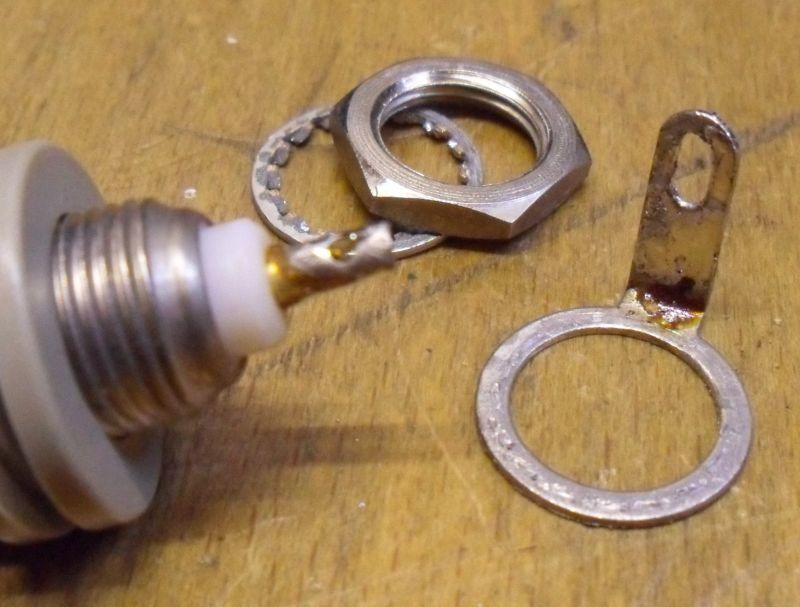

factory 487 #10 Posted March 31, 2019 OK it sounds similar to your other one, is there much missing or damaged on it? 6 hours ago, CNew said: It has one extra tab so I’ll have to figure out which tab to solder the wire that goes to the threaded post on the back side of the points. The original switch will have one tag directly connected to the threaded part (the engine case is the return connection for it), the new switch has insulation in-between as indicated below. You will need to use both of the tags on the new switch, solder an insulated wire to one tag to go to the points, solder a bare wire to the other tag (the one nearest the case would be best) & wrap it around the threaded part of the switch before attaching it to the casing. Of course if you have a suitable sized tag washer similar to the one in the picture below you could use that instead. David Share this post Link to post Share on other sites

Wallfish 718 #12 Posted March 31, 2019 If the switch comes apart, you can just remove that insulation ring which David pointed the green arrow to. The switch body appears to be isolated from those tabs and by removing that insulation ring you are just connecting the tab to the switch body. The switch body will connect to ground when it's installed on the handle and therefore ground the the wire when the the button is pressed which connects those 2 contacts. Either way you do it will work fine. Share this post Link to post Share on other sites

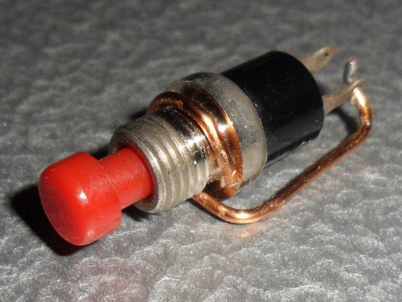

factory 487 #14 Posted March 31, 2019 1 hour ago, Wallfish said: If the switch comes apart If it's anything like this late 60's Switchcraft push switch then you will find that it's pressed together (see arrow) & cannot be taken apart without destroying it. This is what I meant by wrapping a bare wire around the threaded part of the switch to connect a tag to the switch body (demonstrated with a push switch from my electronics spares & a bit of scrap wire), obviously solder the tag on your switch and don't solder the wrapped part unless you want a melted plunger. David Share this post Link to post Share on other sites
CNew 408 #15 Posted March 31, 2019 David, That’s very helpful, thank you for the photo of the wire on the tag! You e got me curious now, I’ll have to go look at this switch and see if it’s all one piece like the one you show. Clint Share this post Link to post Share on other sites

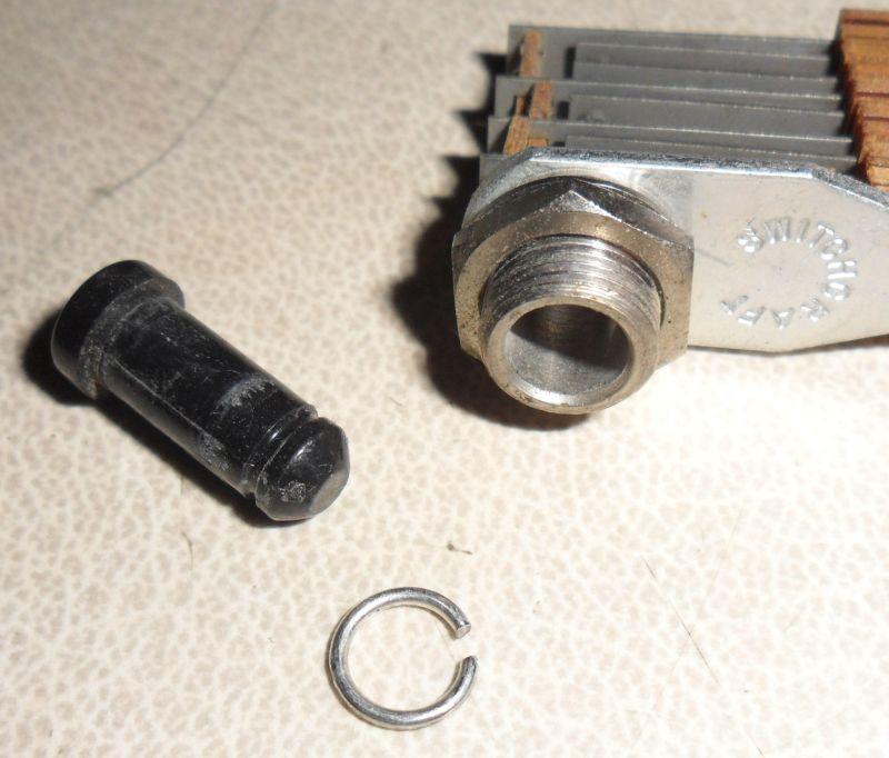

factory 487 #17 Posted April 1, 2019 Option C; I had a thought while I was at work, you may be able to swap the plunger. The spring clip can be carefully removed (hopefully it doesn't end up on a low earth orbit), getting the spring back on is a little trickier, but I've just successfully tried it with that larger Switchcraft push switch I found yesterday. I would try it on an old one that doesn't matter first. David P.S. A similar spring clip is used on the O&R engine PTO shaft. Share this post Link to post Share on other sites
CNew 408 #18 Posted April 1, 2019 Great idea David. I’ll take a closer look this evening to see how the plunger is attached. I don’t recall seeing a little ring clip but I’ll see if it has one or something similar. Clint Share this post Link to post Share on other sites
factory 487 #19 Posted April 1, 2019 It is hard to tell if it has the same type of clip from your picture, I took my picture with the switch pressed to make it more obvious how the parts are held together. David Share this post Link to post Share on other sites
CNew 408 #20 Posted April 1, 2019 David, As usual you are spot-on, there is indeed a small clip holding the plunger in place. Switch plungers might be the easy way for a fix! Thanks, Clint Share this post Link to post Share on other sites

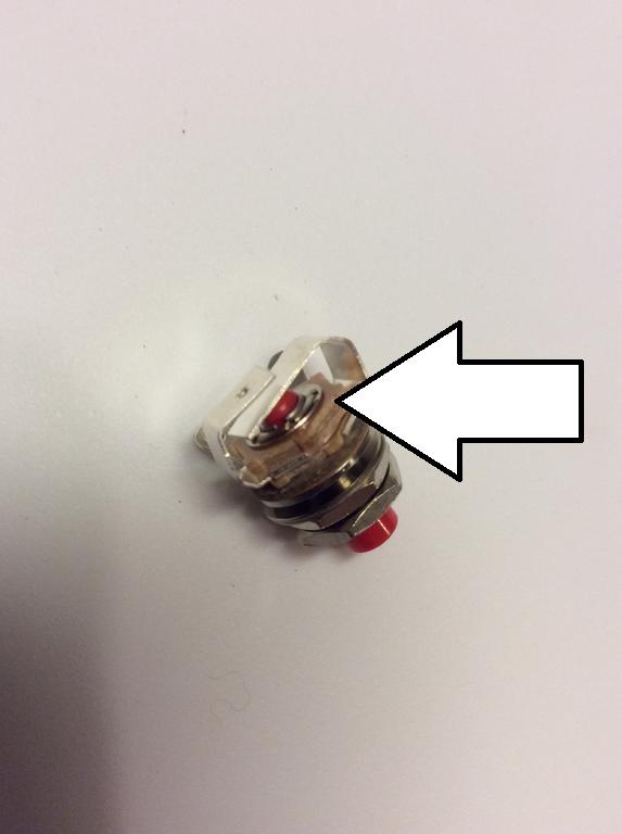

Wallfish 718 #21 Posted April 1, 2019 That appears to be a nut which holds the tabs and isolators all together. Share this post Link to post Share on other sites
CNew 408 #22 Posted April 1, 2019 (edited) John, That’s what I thought at first too but after closer inspection it is basically a very thin crimped metal retainer. It might be possible to gently lift the four little tabs that are folded over and crimped. I wish I had a couple spares to play with just in case it messes it up. I may scout eBay for some used ones to tinker with. Clint Edited April 1, 2019 by CNew Typo Share this post Link to post Share on other sites

factory 487 #24 Posted April 2, 2019 The data-sheet describes everything in detail, the crimped bushing will probably break if you try to undo the crimped part. The "button retaining ring" is the part I took off on my larger switch. http://www.switchcraft.com/Drawings/951x_961x_cd.pdf David Share this post Link to post Share on other sites
CNew 408 #25 Posted April 2, 2019 I think I’m going to try the retaining ring approach first to just swap the plunger. Thanks David! Share this post Link to post Share on other sites
