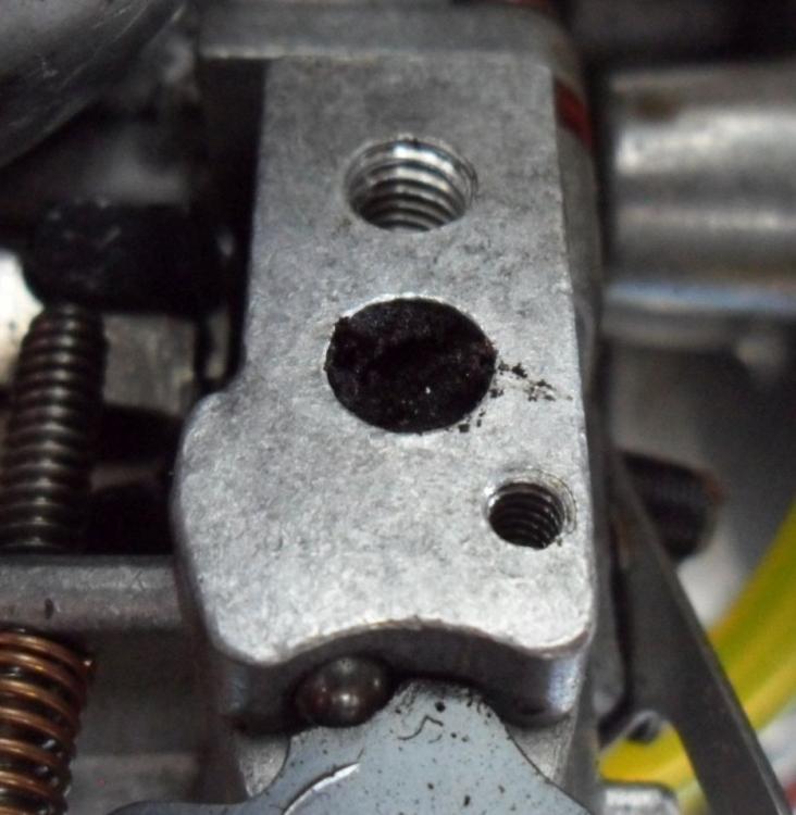

factory 487 #5 Posted April 4, 2019 On 11/28/2014 at 8:25 PM, factory said: Original post by Webhead (on the old forum). "I have a service bulletin in my dealer's manual that notifies all techs to remove the screen from the carb, on any engines that they worked on. Apparently the screen getting clogged caused more problems than if there was no screen at all. The later carbs were completely void of the screen." On 4/29/2017 at 3:49 PM, factory said: Some carbs have a second small fuel filter in the bottom half of the carb, I had a similar problem with a Tiger that wouldn't run after being restored the previous year, it had the filter which was clogged preventing fuel getting to the carb. There was an O&R service bulletin recommending that the carb fuel filter should be removed as it caused too many problems, later carbs don't have the second fuel filter. I just cleaned the filter on mine, as the tank filter is missing and the in-line filter I bought still lets some dirt through. I can't see where I posted the actual service bulletin, but I could find the above two mentions of the carb screen filter. I've left them in place too in any carbs I found them in, I think the above picture shows why they are actually a good idea, they clog to let you know the tank needs a more through cleaning. David Share this post Link to post Share on other sites
