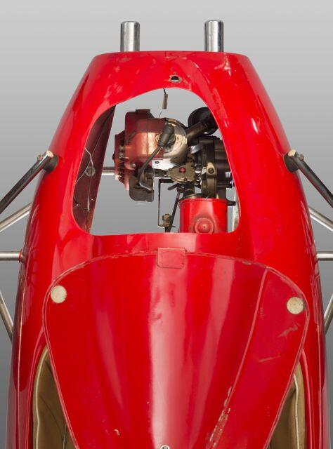

Wallfish 719 #29 Posted December 24, 2023 This is just a guess as to how the engine mounts and allows for reverse. It's also possible to slide the engine instead of tilting it Share this post Link to post Share on other sites

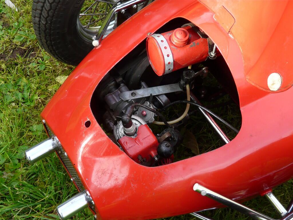

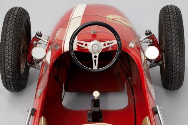

JUST O&R 237 #30 Posted December 24, 2023 That's nice been checking on here every now and then this is a great subject I will add some pic's I have they may help. The drive pulley works as forward and reverse the shifter in the drivers seat when you pull it back it gives slack on the belt and the flat side hits the rubber on the disc to go in reverse 1 Wallfish reacted to this Share this post Link to post Share on other sites
Wallfish 719 #31 Posted December 24, 2023 Maybe the engine mounts on that lower bar behind the axle. Also looks like it needs a brake assembly. Maybe something like this but I do not know the size of the axle https://www.ombwarehouse.com/drum-brake-assembly-for-coleman-ct200u-ct200u-ex-mb200.html?setCurrencyId=1&sku=VMC_1742-HUB001-200&msclkid=be931b774abc125132497effdac9c027 Share this post Link to post Share on other sites

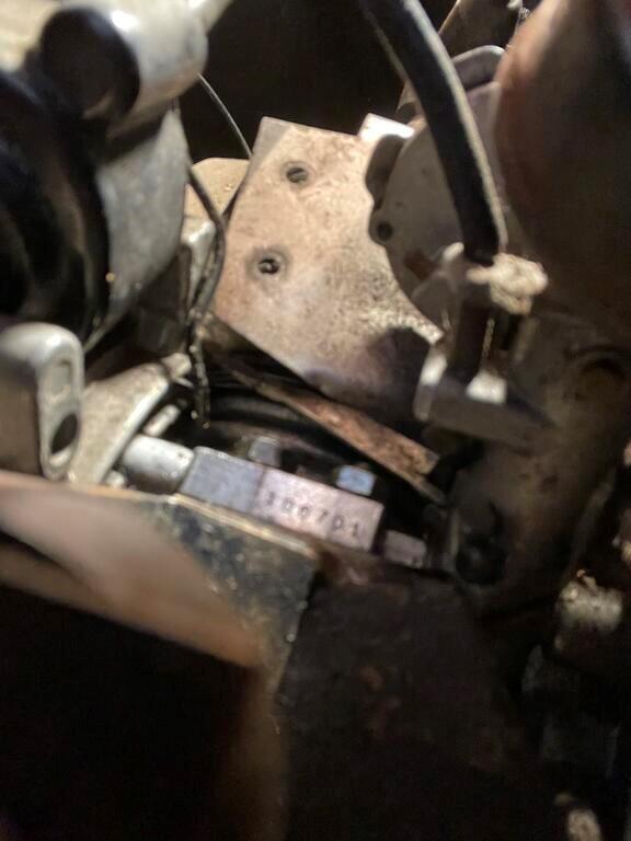

JUST O&R 237 #32 Posted December 24, 2023 Found another pic I had its not a very good pic of the mounting. I thought this might help a pic of the ser # 1 Wallfish reacted to this Share this post Link to post Share on other sites

factory 487 #36 Posted December 24, 2023 3 hours ago, Wallfish said: This is just a guess as to how the engine mounts and allows for reverse. It's also possible to slide the engine instead of tilting it The auction link in post #1 has a description of the reversing lever, I was thinking the same idea, the belt is loosen to slip and the flat part of the pulley is pushed towards the rubber tire on that large internal drive pulley. Quote It was powered by a two -stroke engine with an integrated fuel tank and a centrifugal clutch and had a reverse using a reversing lever located in the cockpit, while the start was by using a pull cord launcher. Powered by an American brand called Ohlsson & Rice, whose primary use were for chainsaws and other similar equipment, the engine had a displacement of 20cc, a cooling fan and a hair-raising max power of 0.86bhp, which allowed aspiring racers to get to between 15 and 20 km/h. So we have several pictures showing the larger size double reduction gearbox, this narrows it down to Models F & J at 900 RPM or Models U & V at 1750 RPM, the model or type is on the opposite side to the serial number, exactly where no one would photo it. Models J & V have a clutch fitted. David Share this post Link to post Share on other sites
Wallfish 719 #37 Posted December 26, 2023 5 hours ago, factory said: The auction link in post #1 has a description of the reversing lever, I was thinking the same idea, the belt is loosen to slip and the flat part of the pulley is pushed towards the rubber tire on that large internal drive pulley. So we have several pictures showing the larger size double reduction gearbox, this narrows it down to Models F & J at 900 RPM or Models U & V at 1750 RPM, the model or type is on the opposite side to the serial number, exactly where no one would photo it. Models J & V have a clutch fitted. David I'd imagine it's going to be the 900 RPM gearbox with a clutch. Just by guessing on those pulley sizes and the tire size, then putting those numbers into a RPM to ground speed calculator it estimates it at about 11-12 Km/h or about 7-8 MPH. Which would seem about right for a child's car Share this post Link to post Share on other sites
