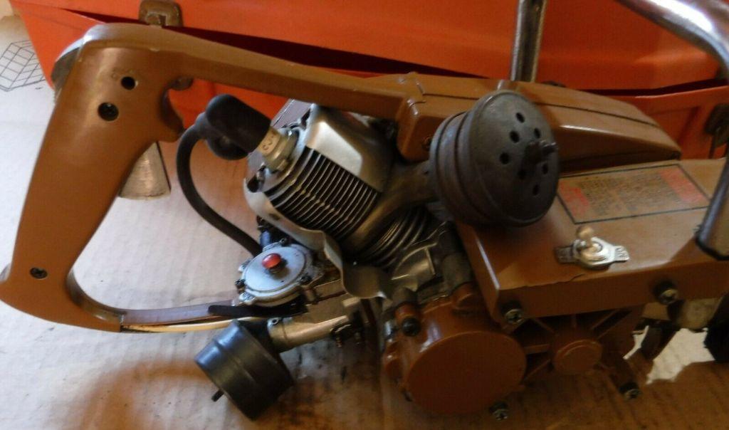

CNew 408 #1 Posted June 15, 2019 I’ve seen a few of the Orline Mustang chainsaws recently on eBay and this one came up this week. I was surprised by the level of interest in it vs the others that sat on there for awhile and weren’t generating as much interest. I can’t figure out what the draw is to this specific one. It looks to be in decent condition but I’m guessing it’s also been repainted. The metal cover over the gear box is different but that looks to be hand crafted and not part of the original saw. Is there truly something special about this one that I’m not seeing? https://www.ebay.com/itm/VINTAGE-ANTIQUE-O-R-ENGINES-CHAINSAW-WITH-BAR-CHAIN-SAW/333229306238?_trkparms=aid%3D111001%26algo%3DREC.SEED%26ao%3D1%26asc%3D20160811114145%26meid%3D6c212c4e5b094e64914e8f114437dc58%26pid%3D100667%26rk%3D3%26rkt%3D8%26sd%3D192947701968%26itm%3D333229306238&_trksid=p2045573.c100667.m2042 Share this post Link to post Share on other sites

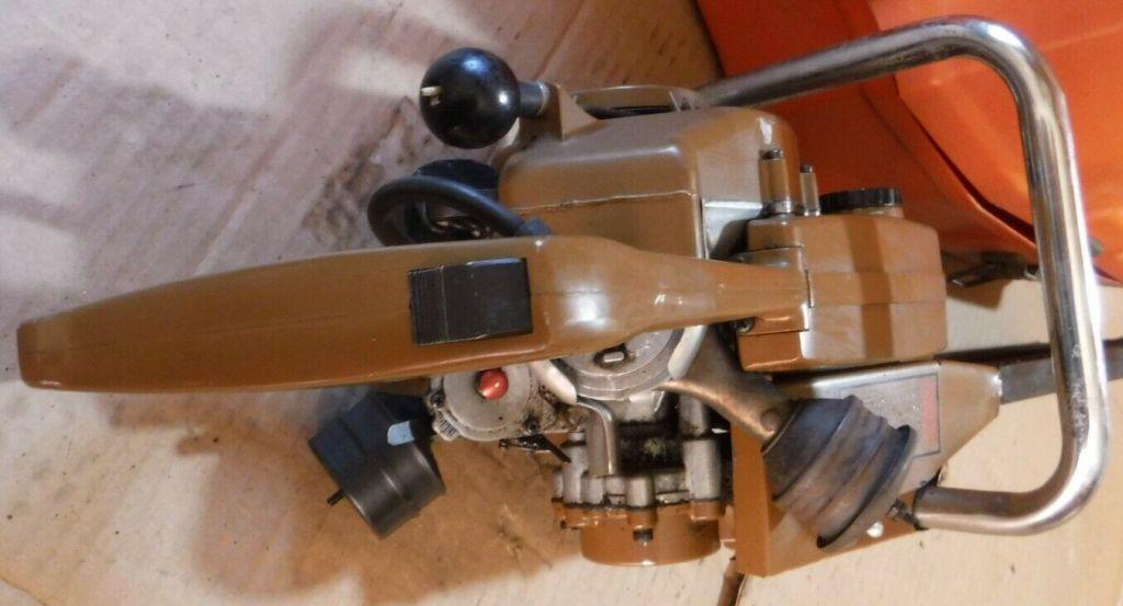

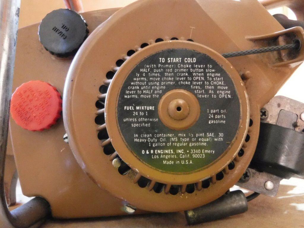

factory 487 #2 Posted June 15, 2019 Not seen one like that before. I'm not so sure it's been repainted (or partly repainted) as the decals looks original, including the clear instruction one on the gearbox shield. The chrome handle is different to the standard ones, as it isn't flattened at the gearbox end (where it normally screws on). Oddly the stop switch is right by the exhaust , also the handle still has the holes for the switch rod, maybe that got broken & swapped with an Orline one. David Share this post Link to post Share on other sites
CNew 408 #3 Posted June 15, 2019 That’s similar to what I was thinking, there is just enough odd about it. I was guessing that maybe someone rebuilt it or only had a partial saw to start with and then added the switch and cover shield along with a different handle. I’ve yet to see anything like this as an original unit but maybe it is. The decal on the cover plate threw me off too. I’m with you Share this post Link to post Share on other sites
factory 487 #4 Posted June 15, 2019 There are a lot of unusual variants of chainsaw, none of which turn up very often, together with a couple of variants from the magazine adverts (in the sticky thread) which I have yet to see a surviving example for sale (the Calif. Power Line Products Inc. chainsaw for example). Thinking about it, the original switch may have been damaged and as it's not an off the shelf part, they may have replaced it with the toggle switch. David Share this post Link to post Share on other sites

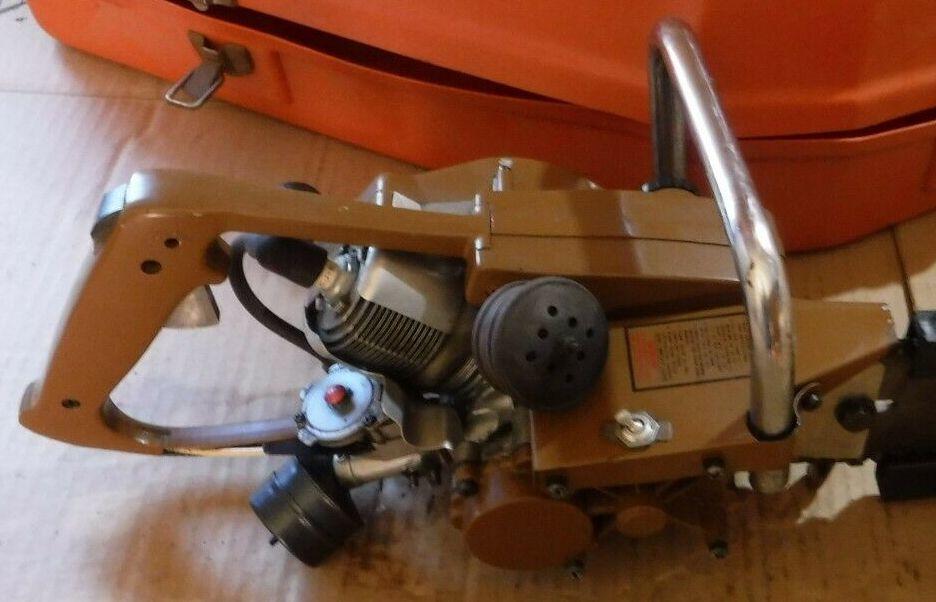

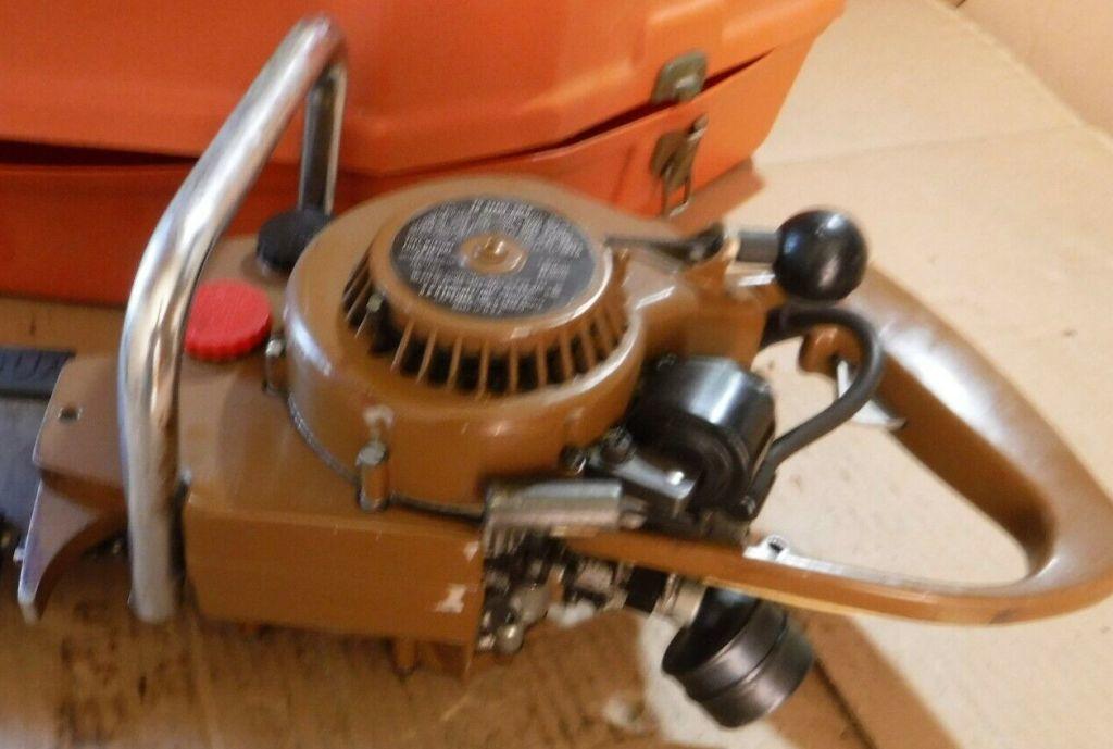

factory 487 #8 Posted June 26, 2019 Another possibility, the 1964 engine parts list does mention a tan starter (it doesn't state what it was used on), but what about the two decals and the different chrome handle? Also did you have a tan painted gearbox half? Here are some edited pictures from the ePay auction for future reference (they will disappear from ePay when the auction link eventually dies). David 1 HeadExam reacted to this Share this post Link to post Share on other sites
